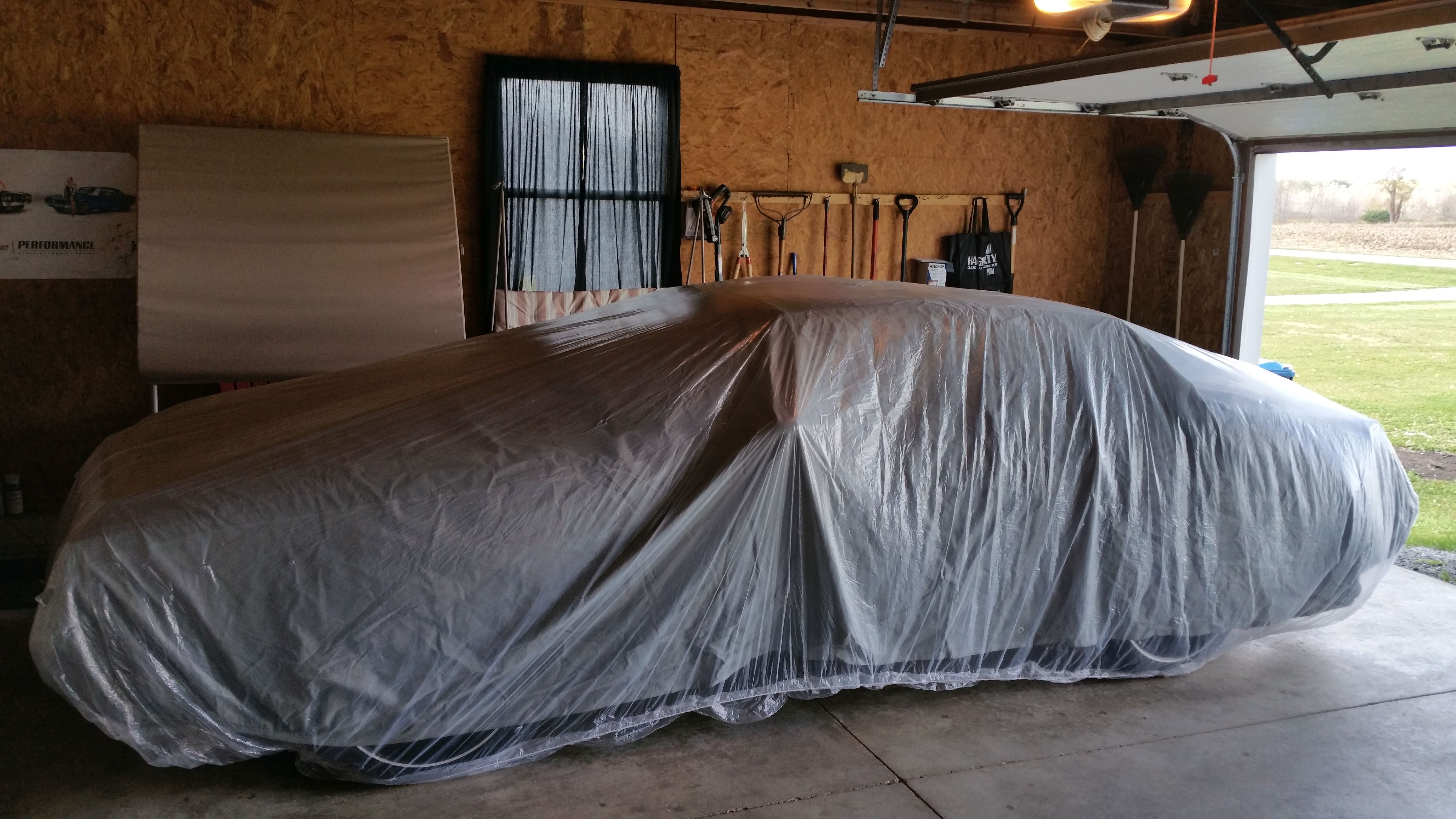

What steps do you take to store your Monte during winter? For those that have winters lol. I just fill tank half way, add sta- bil to help keep fuel fresh, detail, put battery on tender and cover her up. I don't drain fluids at all just have them all changes when bring Monte out of storage.
