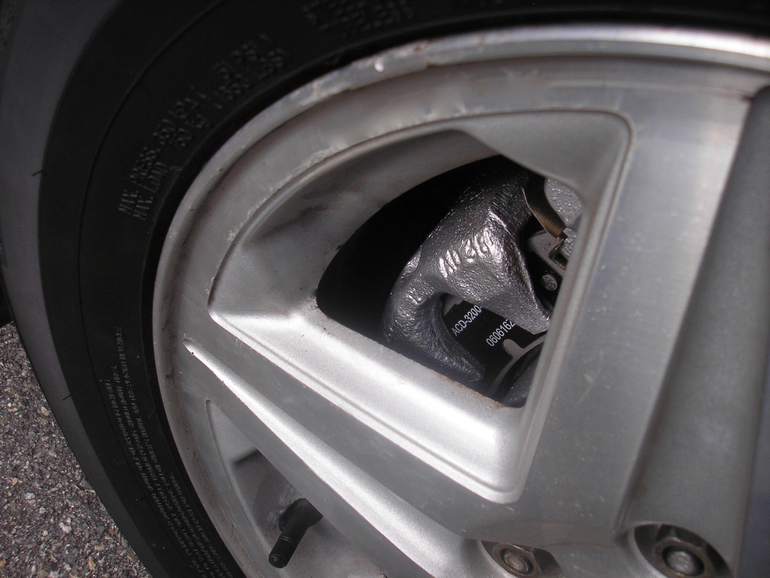

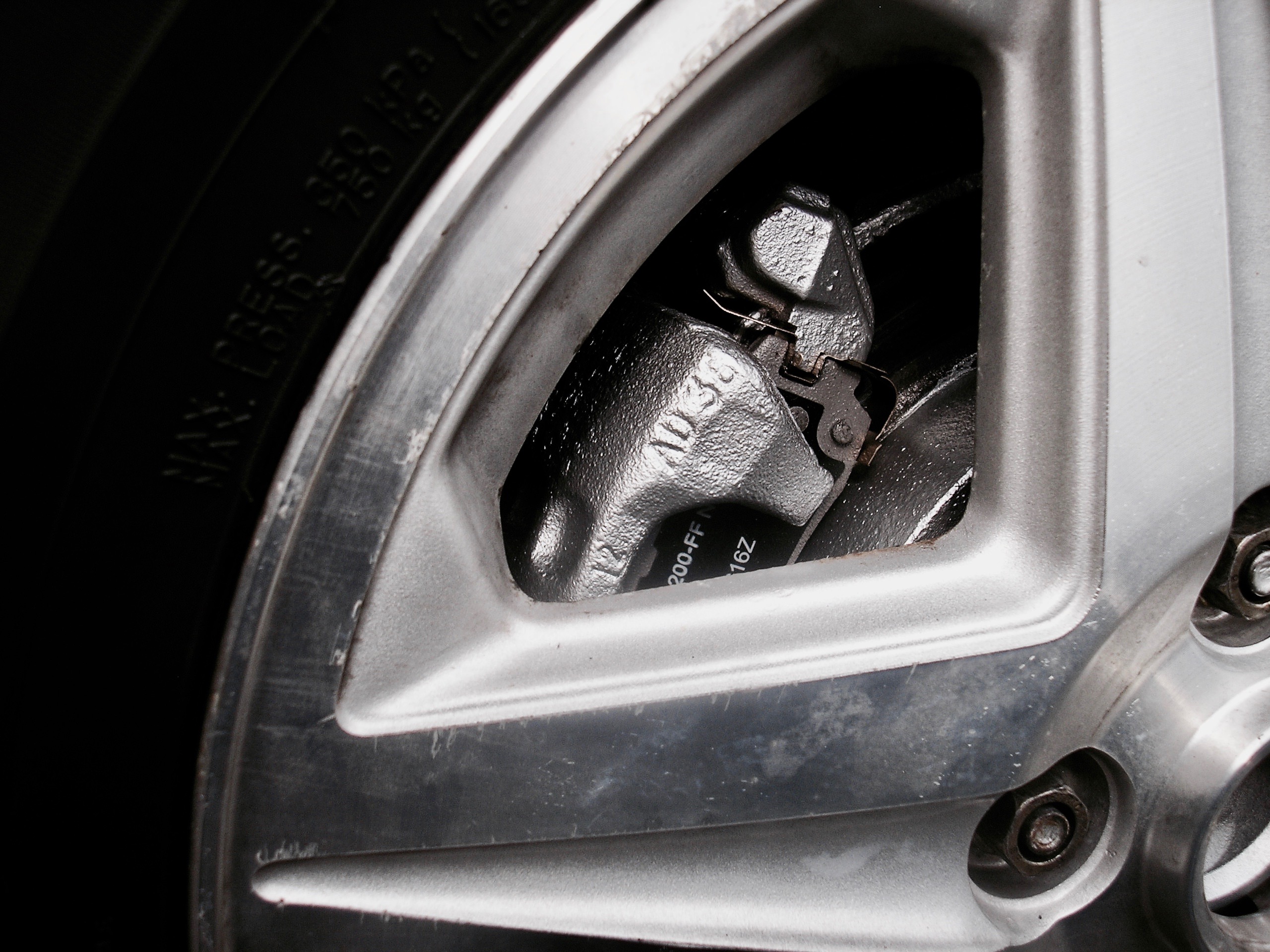

Pick a Caliper Paint color you like.
Shake the can vigorously for 5 minutes. (Kid’s love to help.)
Blow the color on the Caliper, Mount, Rotor and Hub.
Use a Flap from a Cardboard Box.
Shake can and prepare to paint. Hold cardboard to left or right of what’s to be painted.
START the Spray on the Cardboard then bring the mist over the work.
Apply a coating of Spray-can paint mist to work.
There needs to be a whole lot of shakin’ goin’-on. We are not taggin’ a subway car. Pretend you’re “Banksy”.
KEEP THE SPRAY NOZZLE FROM GETTING TOO CLOSE TO THE WORK.
When you are not applying a coat of aerisol MIST from a Spray which you have started AWAY from the work … apply a dust-coat … completely across the work.
DO NOT STOP THE SPRAY UNTIL AIMED AWAY FROM THE WORK.
