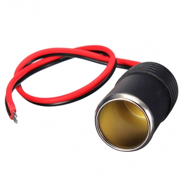

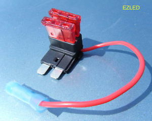

^ thats the only annoying thing having to remember to plug in and plug the camera.
I used a cigar lighter socket and a piggyback fuse holder that I connected into the turn signal fuse in the driver side fuse panel. So the dash cam comes on whenever the key is turn to the ON position and turns off when I stop the engine.
Attached Thumbnails Do you have a dash cam?-adapt.jpg   Do you have a dash cam?-piggy.jpg
