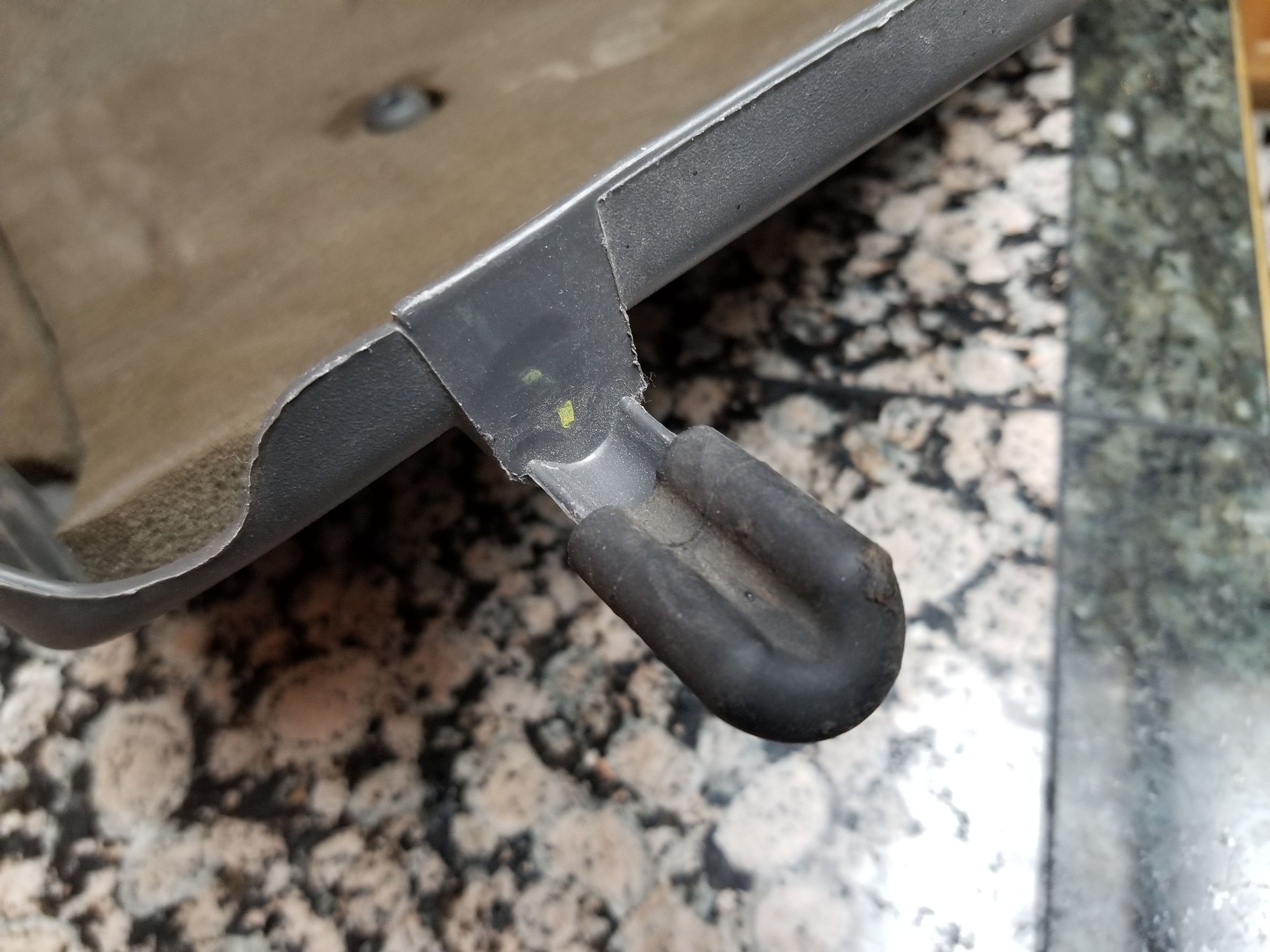

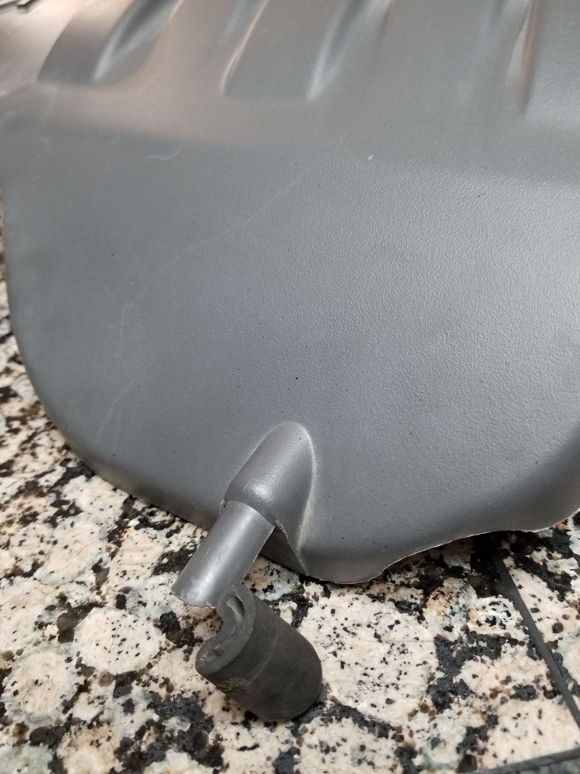

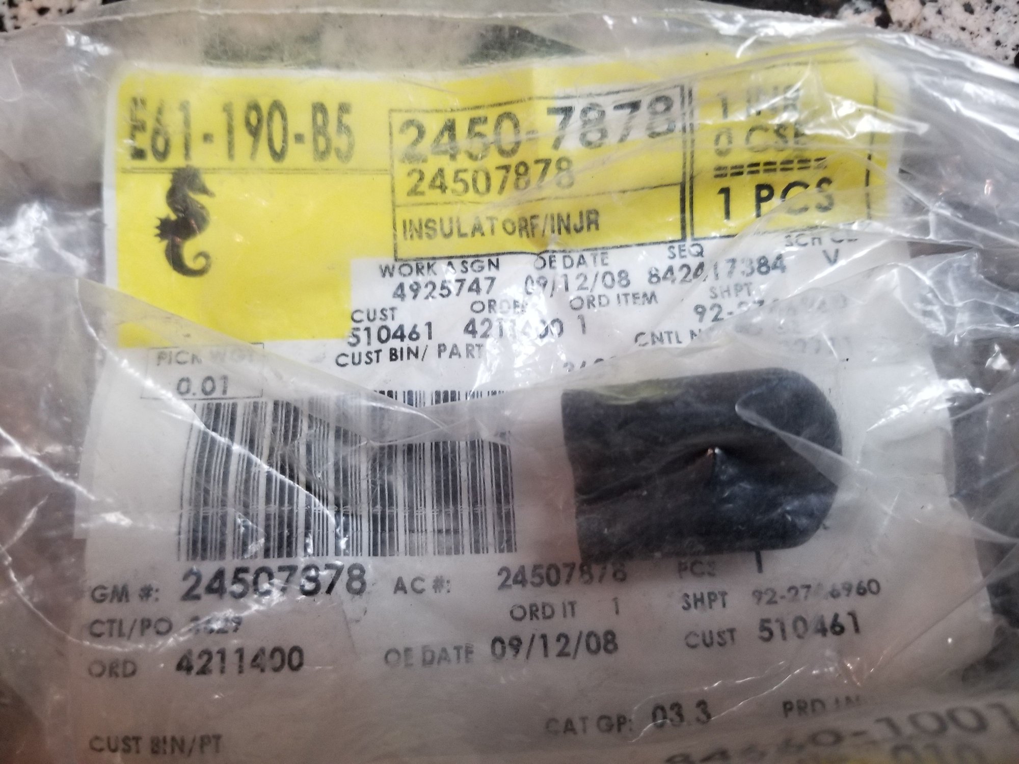

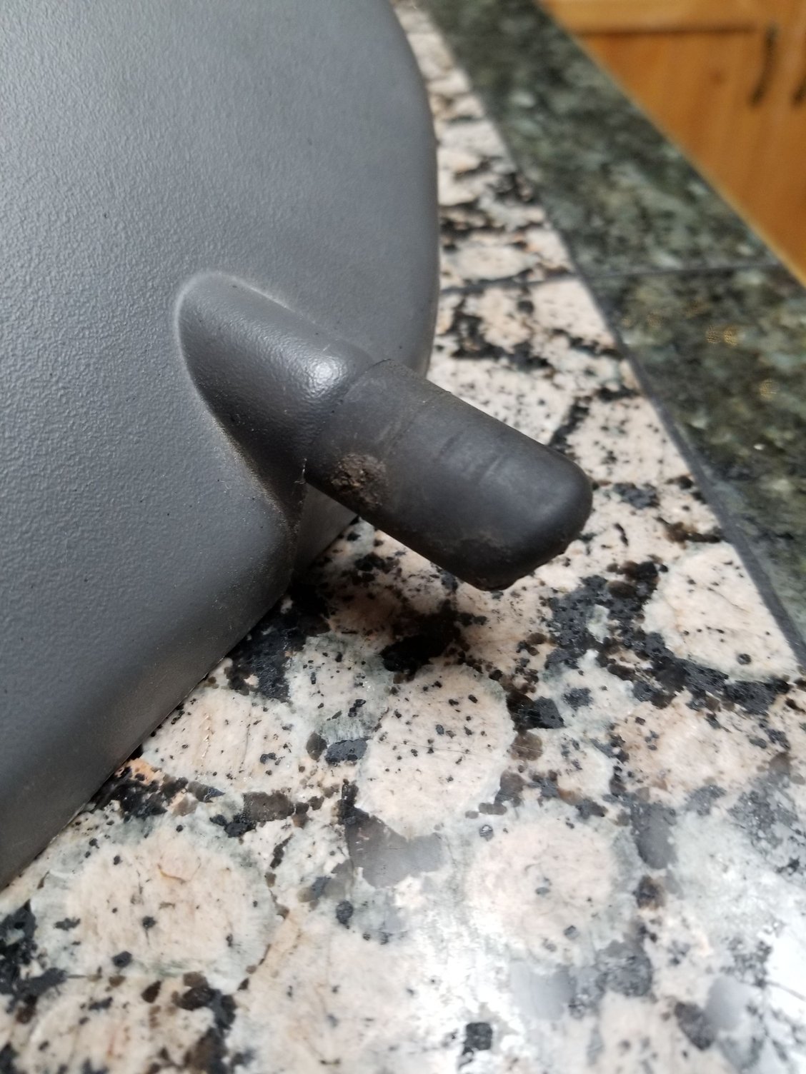

The engine's beauty cover is held in place essentially by a piece of foam rubber. Acts like a shim that retains the cover in a metal anchor point the covers tang inserts through. I find them quite often at the junk yards, as often when the covers were taken off for one reason or another the foam piece tends to slip off and lands on top of the engine by rear valve cover. So just scrounge around all the Gm, Pontiac, Buick cars that had covers like this and you will often find one, may as well grab a couple while you are at it. I have a couple used, and a new in bag still.

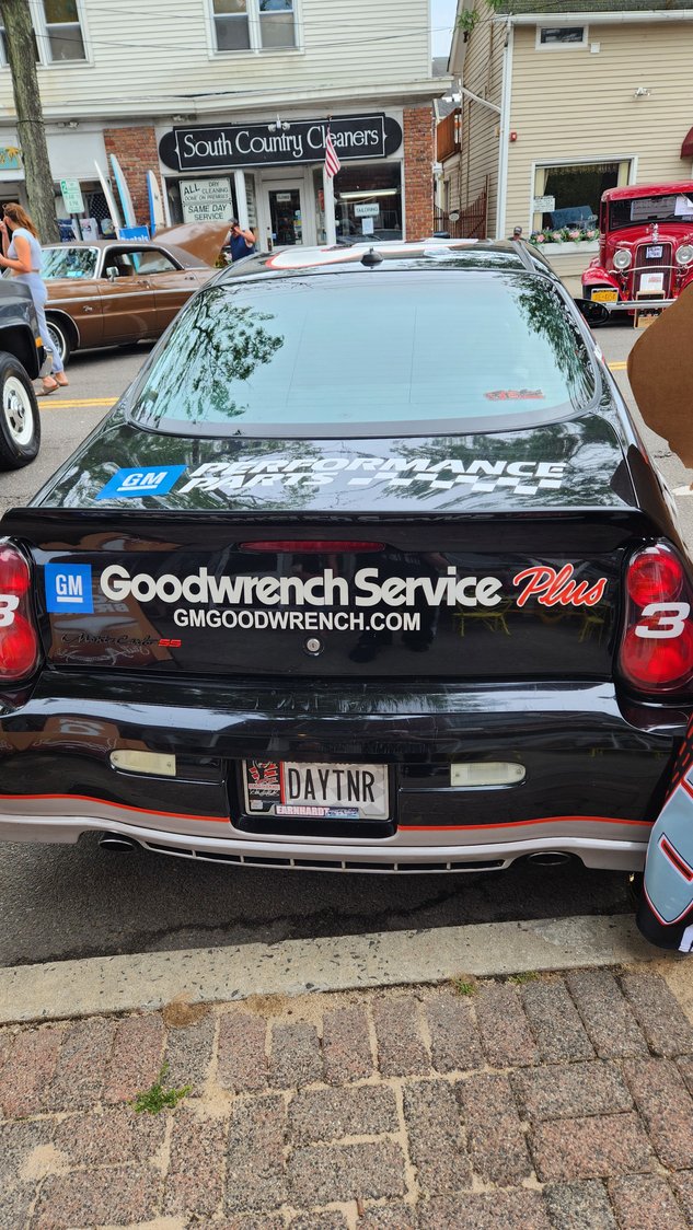

That is all well and good, but I am supercharged. So while I have a slot by the firewall, I also have a nut that goes on the cover in the center. I did put an extension on my oil fill from a Buick, so it isn't going anyplace. But, I do take "Dale" to car shows on occasion and I'd like to have all the pieces. My car is a replica of Earnhart Sr's Last ride in Daytona 2001.
