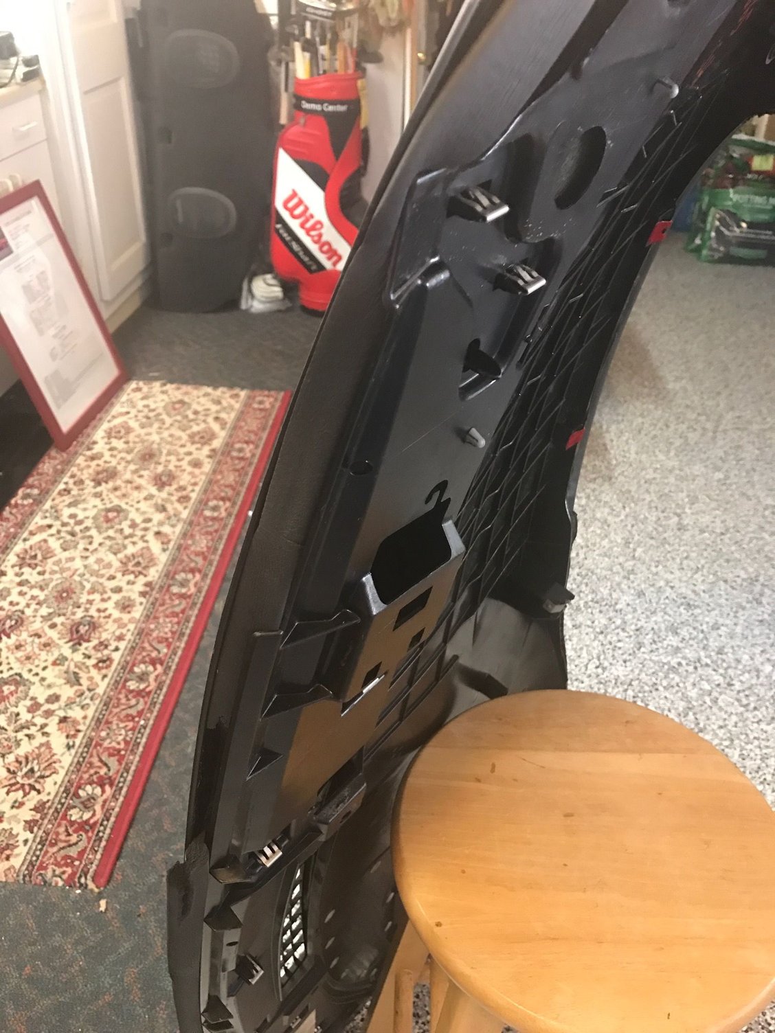

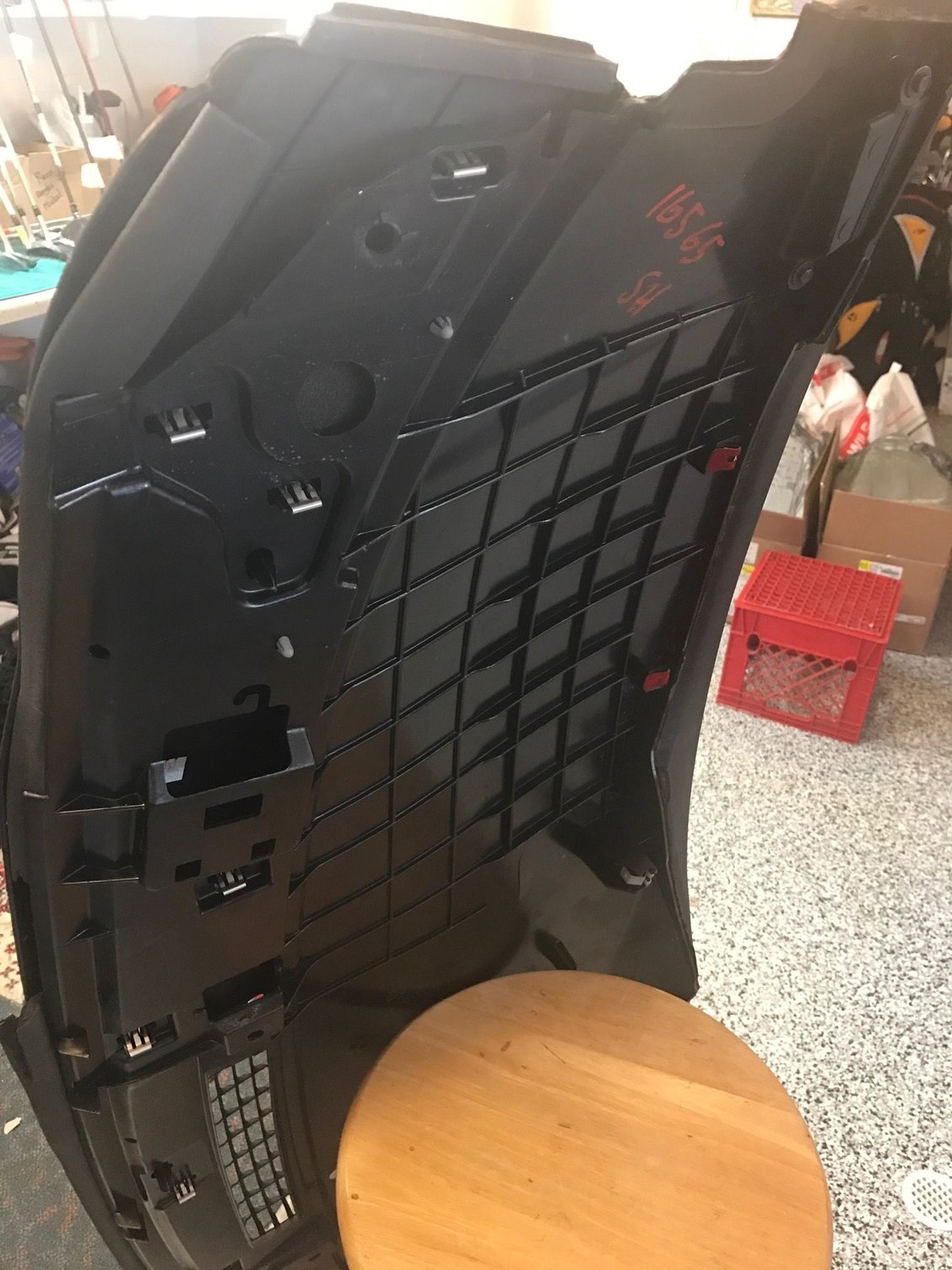

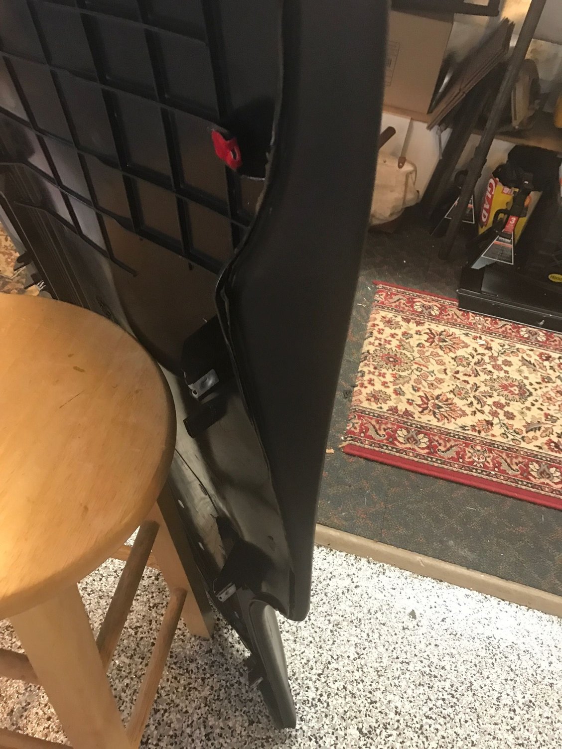

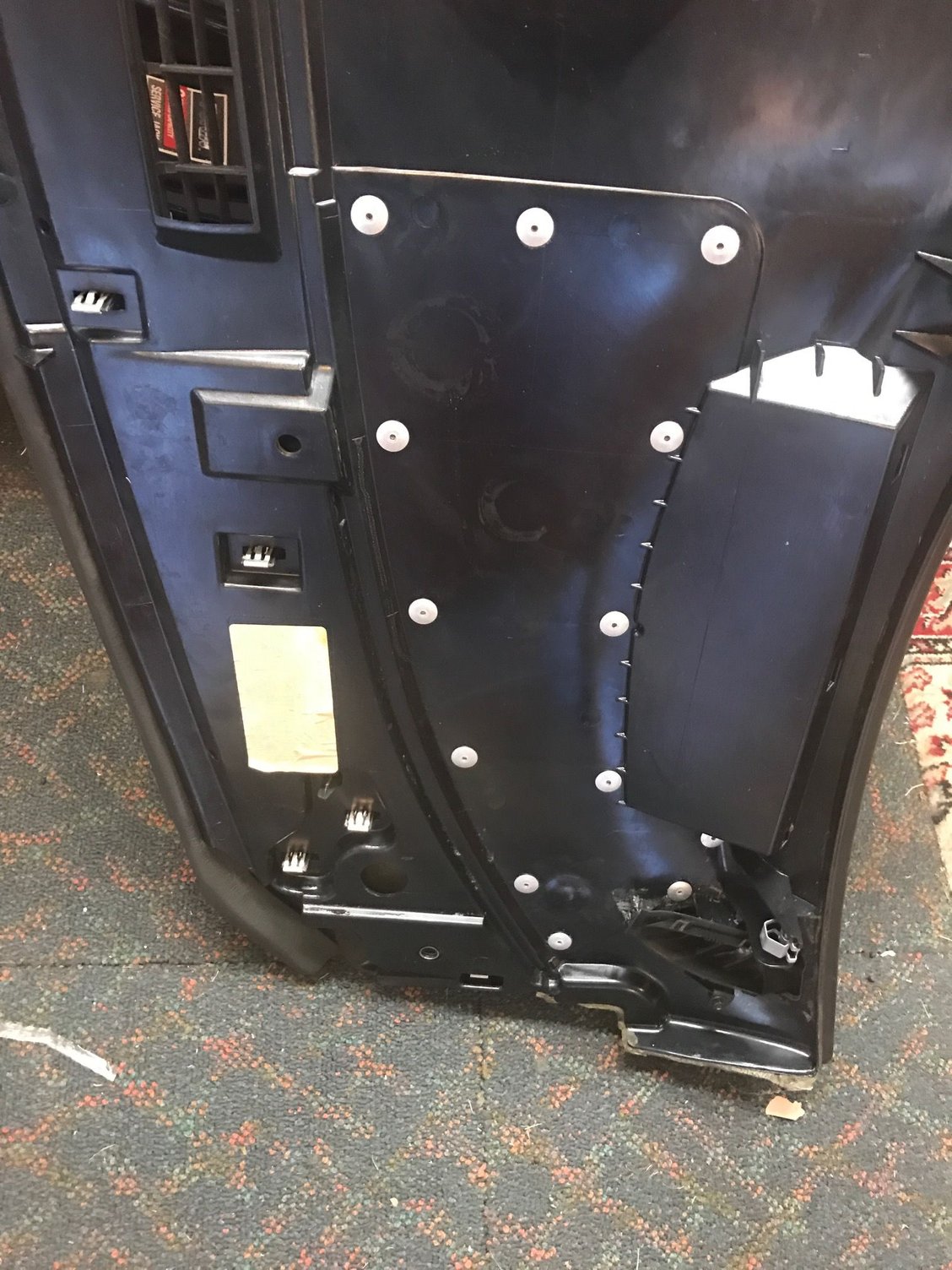

I have a Black Dash Pad from a 2007 Monte SS that is not pulled up that I'm selling. Both pieces are included. A local salvage yard told me they had one for my Monte. They would not let me in the yard to look at it so they removed it for me. I told them I need Dark Grey and the one they brought out was Black. I wasn't about to argue with the guy about the color. I bought it anyway hoping I could help out a fellow Monte owner who may need it.
Price????????
Contact me via the Forum and I will send pictures then discuss price and shipping if necessary.
PM'ed you. very interested.
