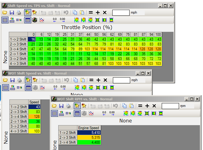

In regards to your initial question on shift points; there are a few variables that control the shift, speed, RPM & throttle position.
Attached are tables from my HP tuning software on a 2005 SS

1st attachment showed up small, let me try again...
http://lohinc.com/trans.png
