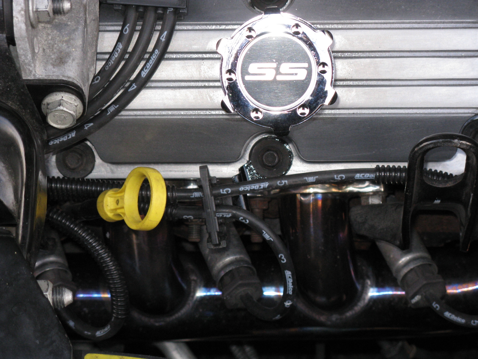

When I switched to the F-body aluminum valve covers on mine, I had to remove the wire holder. I did not like the wires "draping" like yours now do. I grabbed a wire holder from a 3100, trimmed the bracket and bolted it down with a valve cover bolt. Works great!
Attached Thumbnails Valve Cover/Oil Extension Neck Recall-img_4108.jpg
