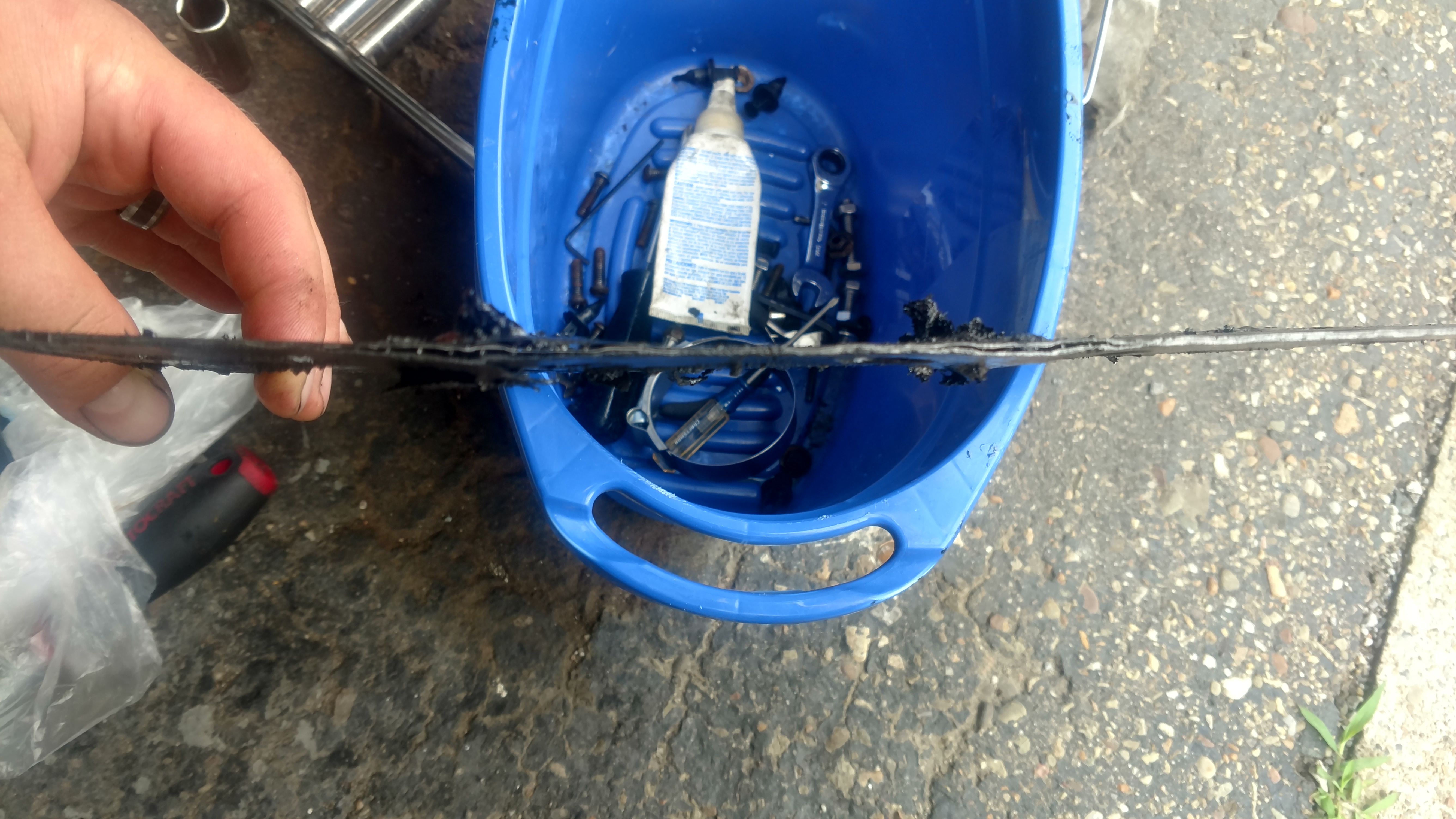

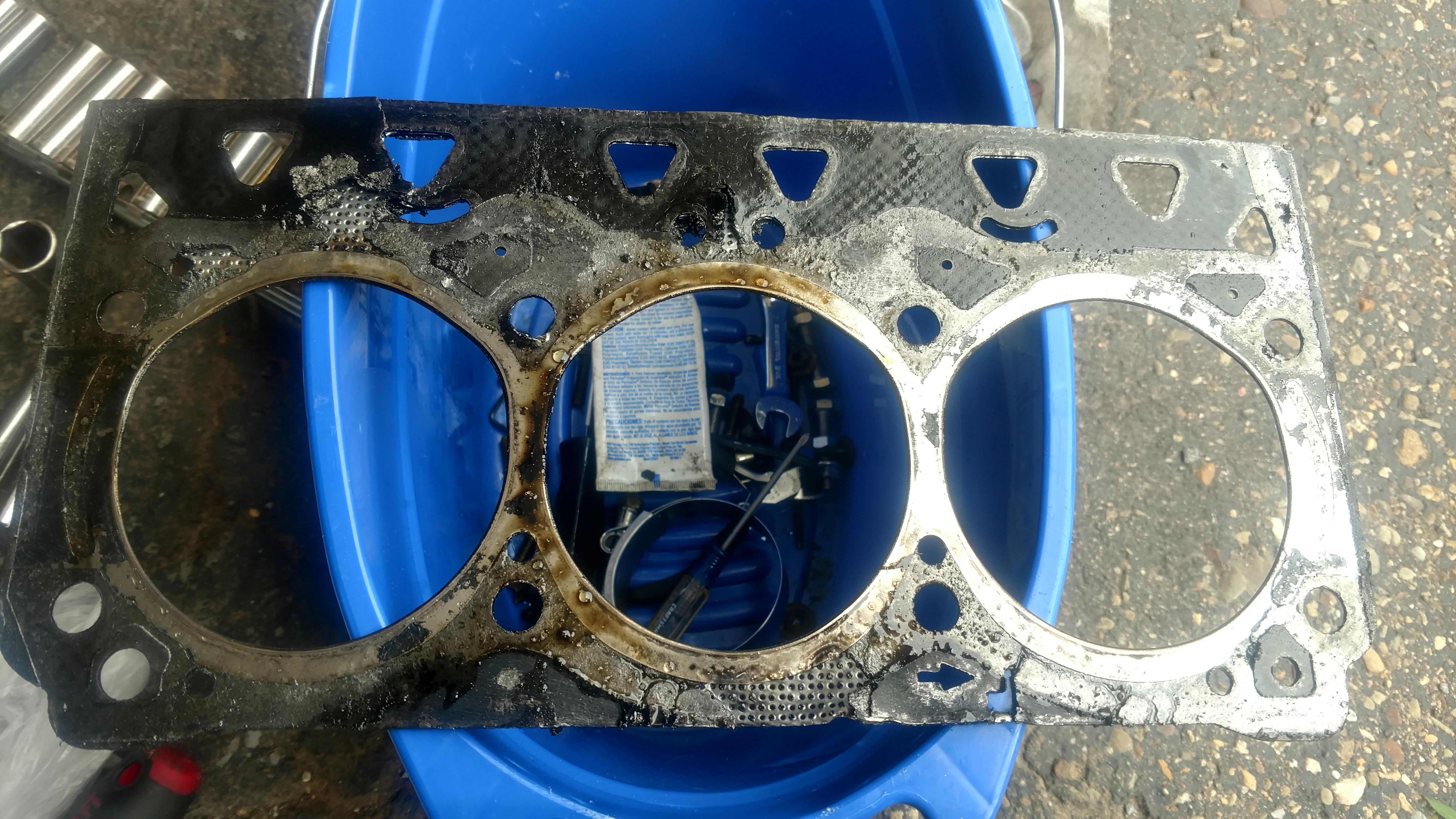

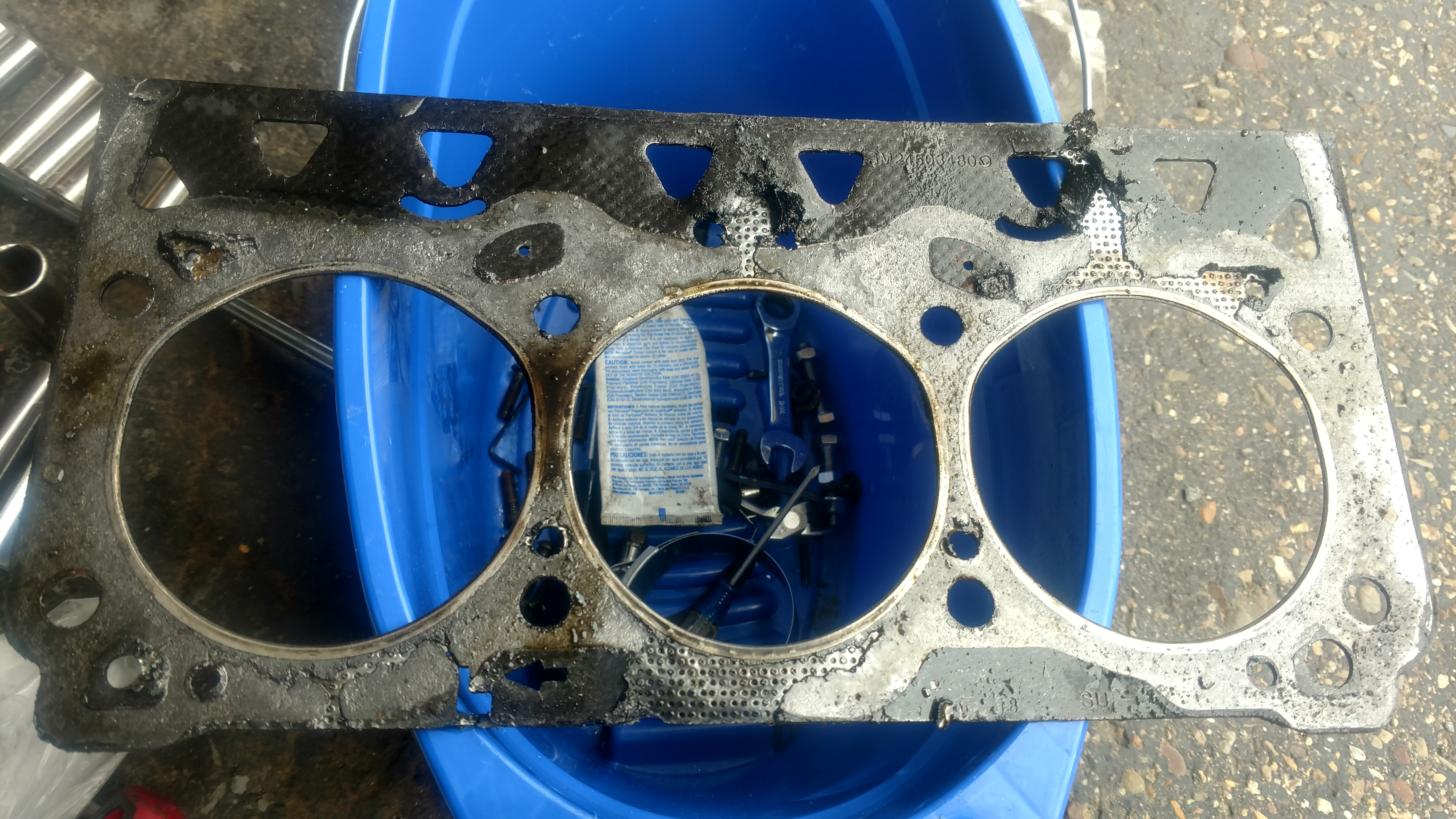

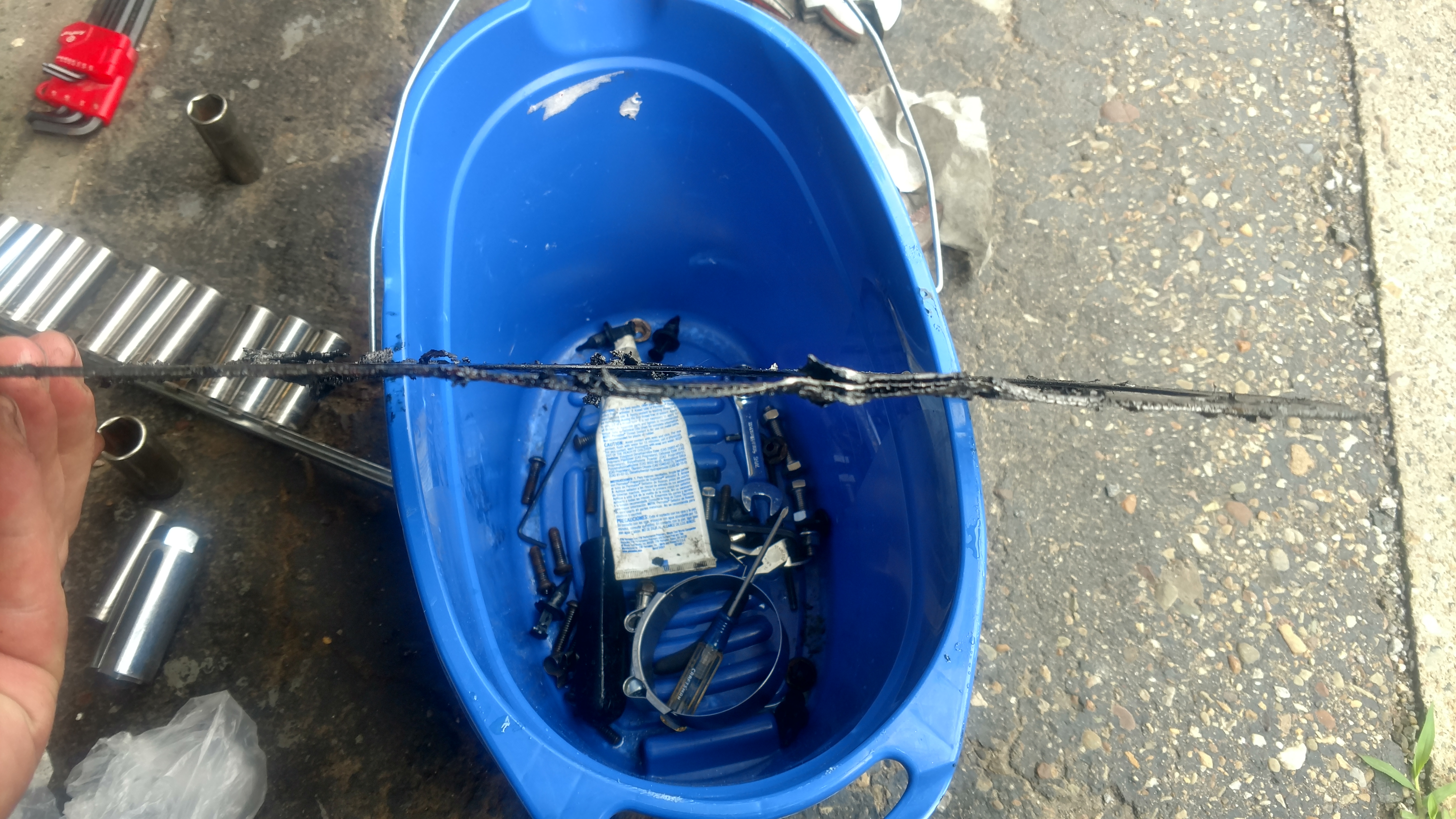

Here is the head gasket that decided to move into another zipcode anyway lol

Thanks Greg, I just reinstalled the heads last night. Will do my final torque pass this evening. Upon further inspection of the head gasket failure the head gasket never failed do to cylinder pressure..... The shop never plugged the pcv valve like I told them had to be done. With them not doing that the pcv failed under big boost and pressurized the crank case. This blew the coolant passages in the gasket and not the cylinders. If they would of did what I told them to do the engine may of still been together.
So I pulled off the turbo stuff, upon inspection of the turbo piping the cross over had 6 pin holes in the welds and one weld for the wastegate was cracked.... Had that repaired and picked it up yesterday as well.
