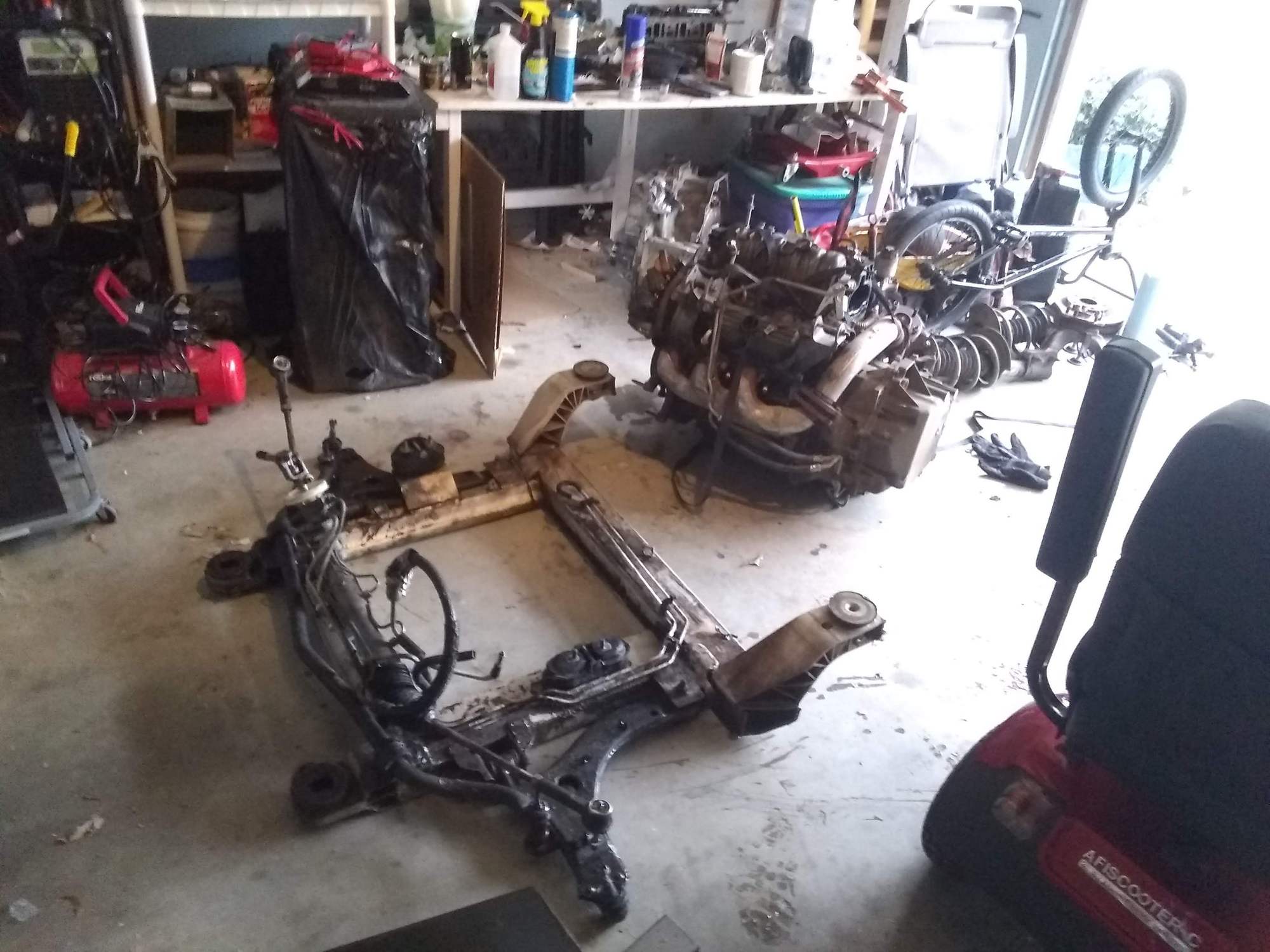

Engine/trans and subframe pulled into the garage. I know the subframe is aluminium, but it was even lighter than I expected.

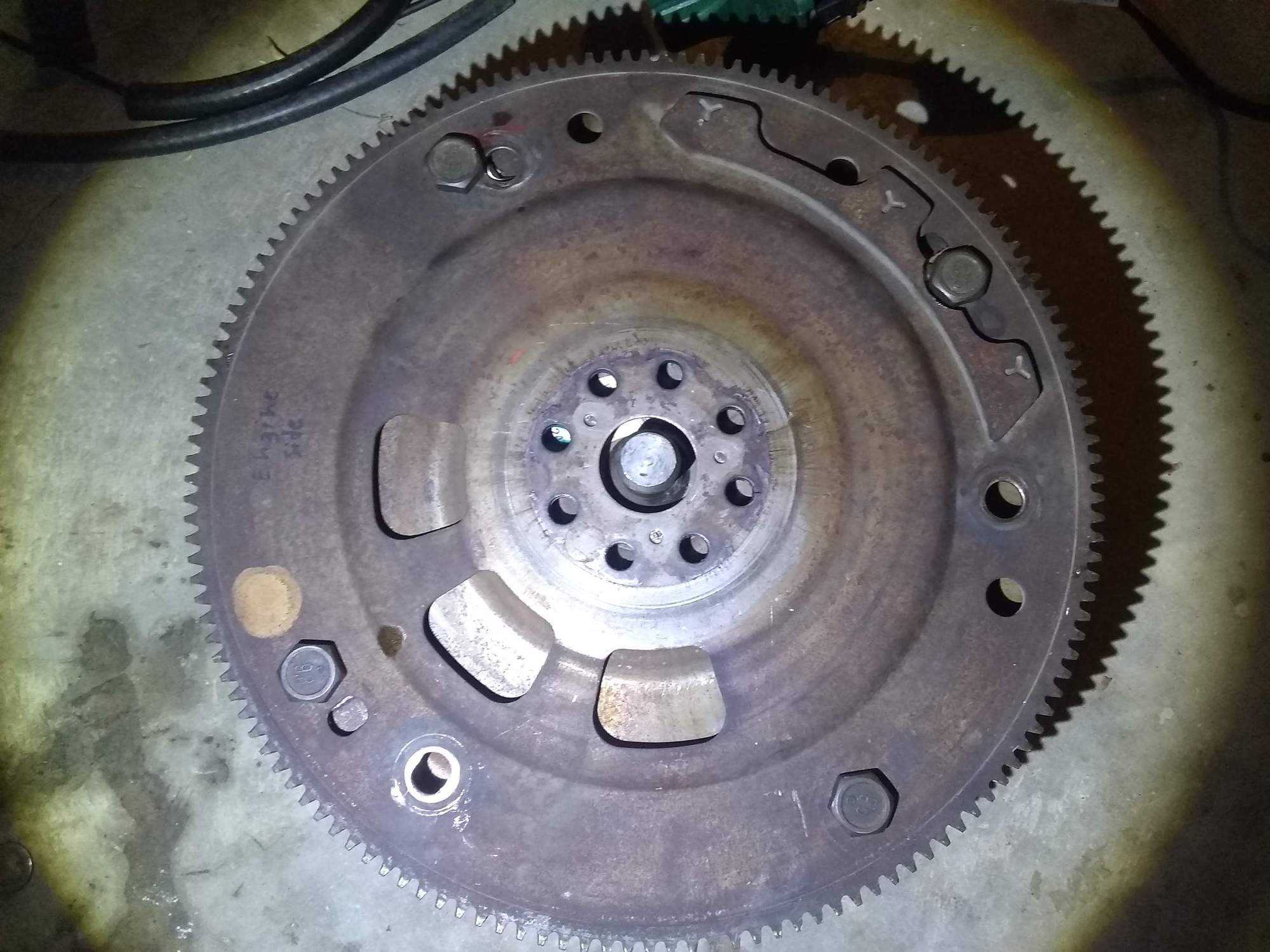

Sadly, the rumors about the 3800 flexplates being dimpled for the four bolt converter pattern seems to be false. I'm going to have a machine shop drill those four holes, and hopefully there's enough clearance to put one in the empty space above the weight there.

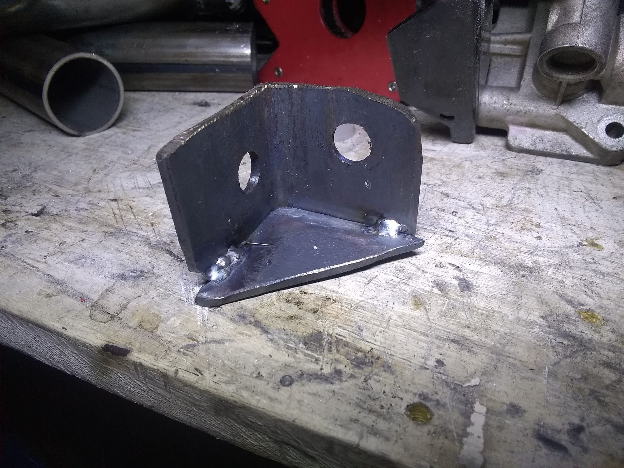

After getting that brace done, I could move onto making the engine/trans mounts. I lifted them up with the hoist, and slid the subframe underneath, on top of the hoist legs. I measured some things, and came up with some sketches for mounts, of which there will be four. I'm reusing the following mounting locations: engine to subframe, forward mount on the 4t80e, and drivers side mount on the 4t80e along with the stock trans mount location on the subframe. I'm also just eyeballing these basically. I'm not trying to be super precise. So far I've used one piece of 1.5x36x.5" steel for two of the four mounts. My basic little welder did a decent job at welding the half inch thick steel, although I'm not an expert by any stretch of the imagination, so it could have done terribly. Here are pictures of my progress.

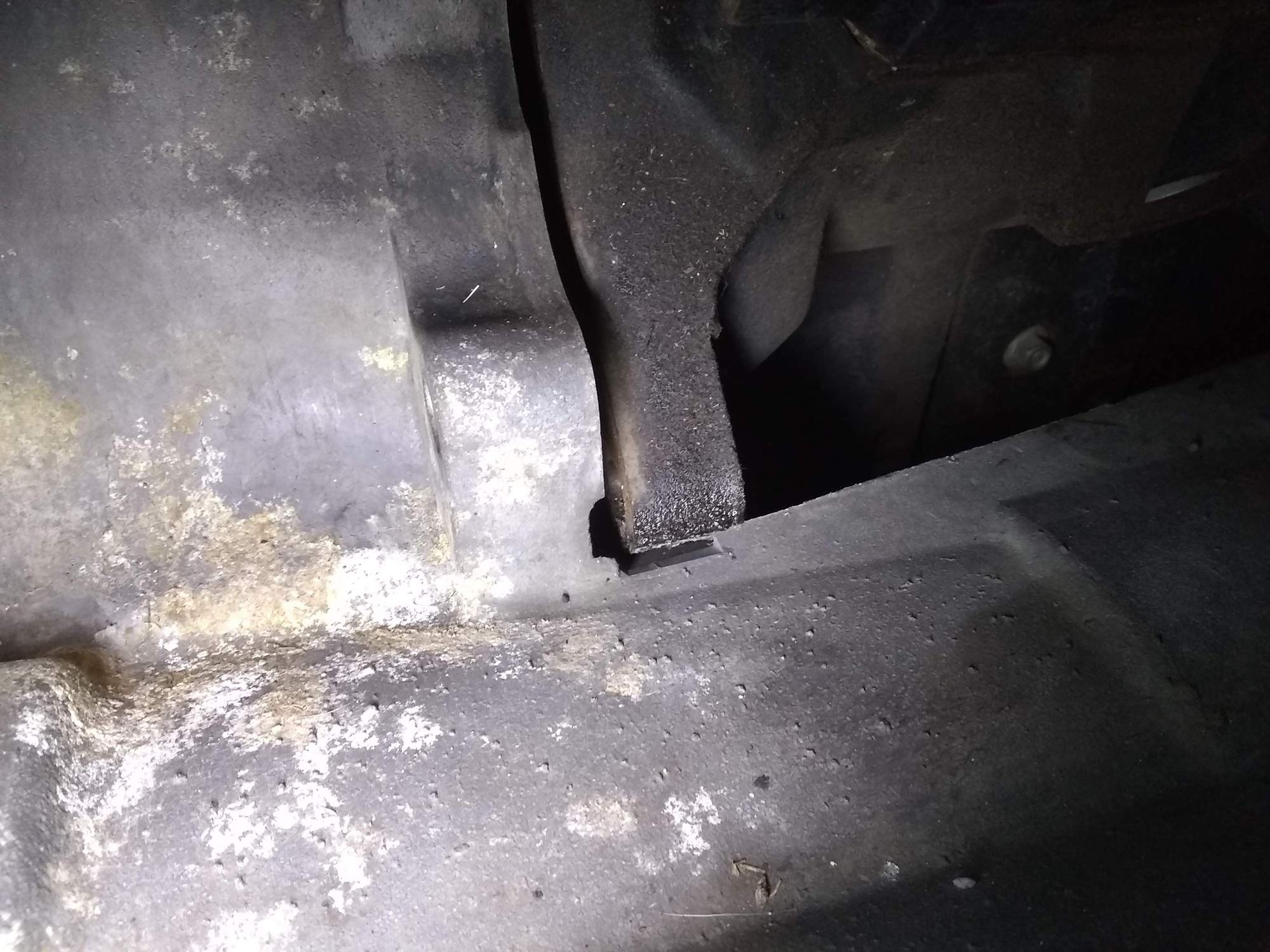

I had to do a tiny bit of clearancing for this mount.

I got the flexplate back from the machine shop a few days ago. It cost me 60$ to have the four holes drilled, and a small amount of the weight on the flexplate clearanced, so a socket would fit over the fourth bolt.

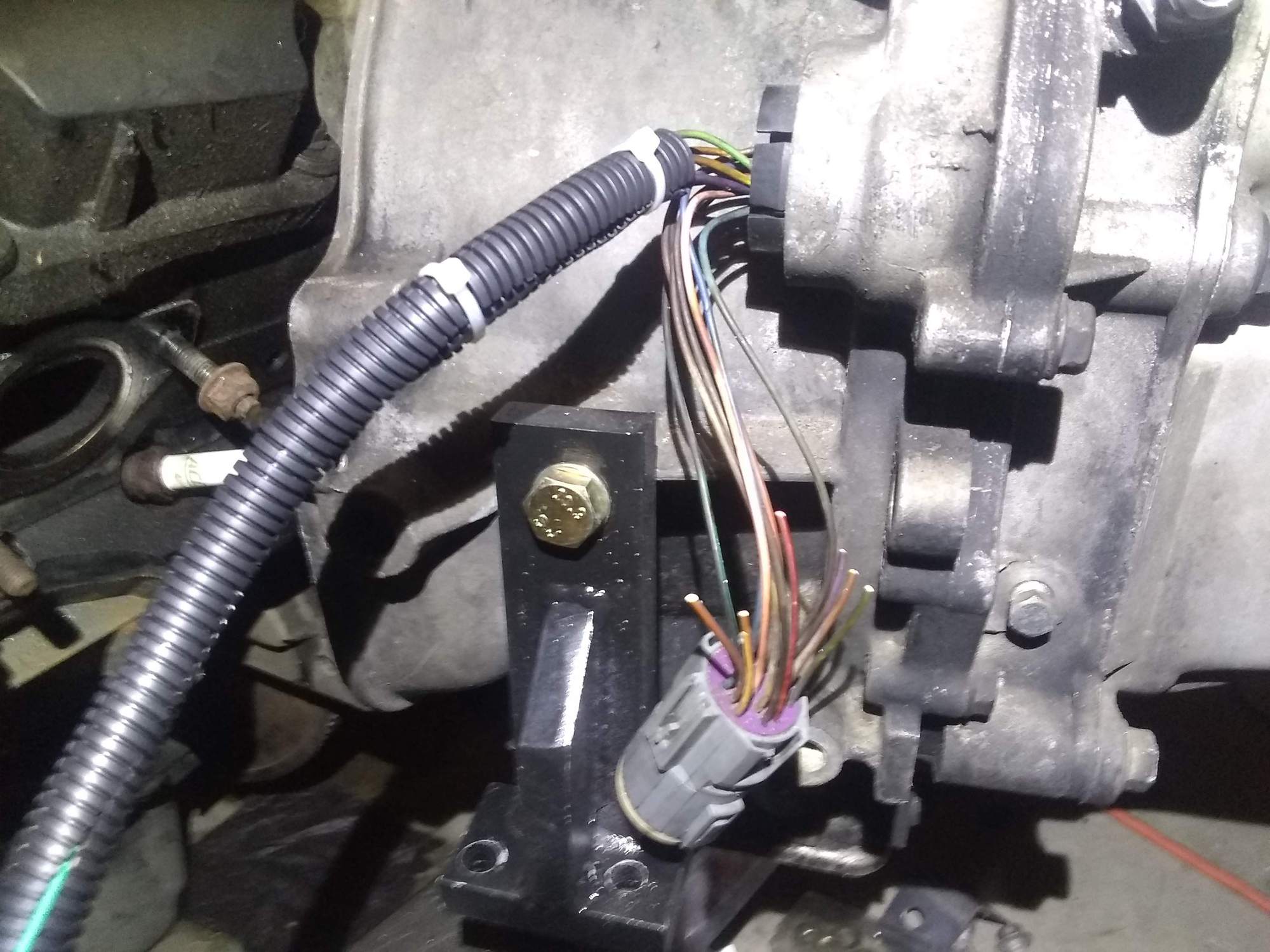

Small update, but big progress. That giant trans is in. I worked almost all day on it. Getting the wires for the controller soldered on, and plugging the trans drain. I've only ever seen the one 4T80e transmission pan, mine. It had a rubber plug instead of a bolt, which I thought was odd. But after draging the trans around on the concrete floor, the plug ripped. Oops. I took out what was left, and it looks like there may used to have been a bolt, but the material the threads were in is pretty much gone now. Either way, I went and picked up a pack of bypass caps, which are just big rubber plugs basically. And used one to plug the transmission drain hole. I also reinforced that with some blue rtv. Finally I disasembled the front end of the car, hoisted the trans up, and worked it in. The biggest problem I had getting the trans in there, was that AC system canister thing next to the PCM.
