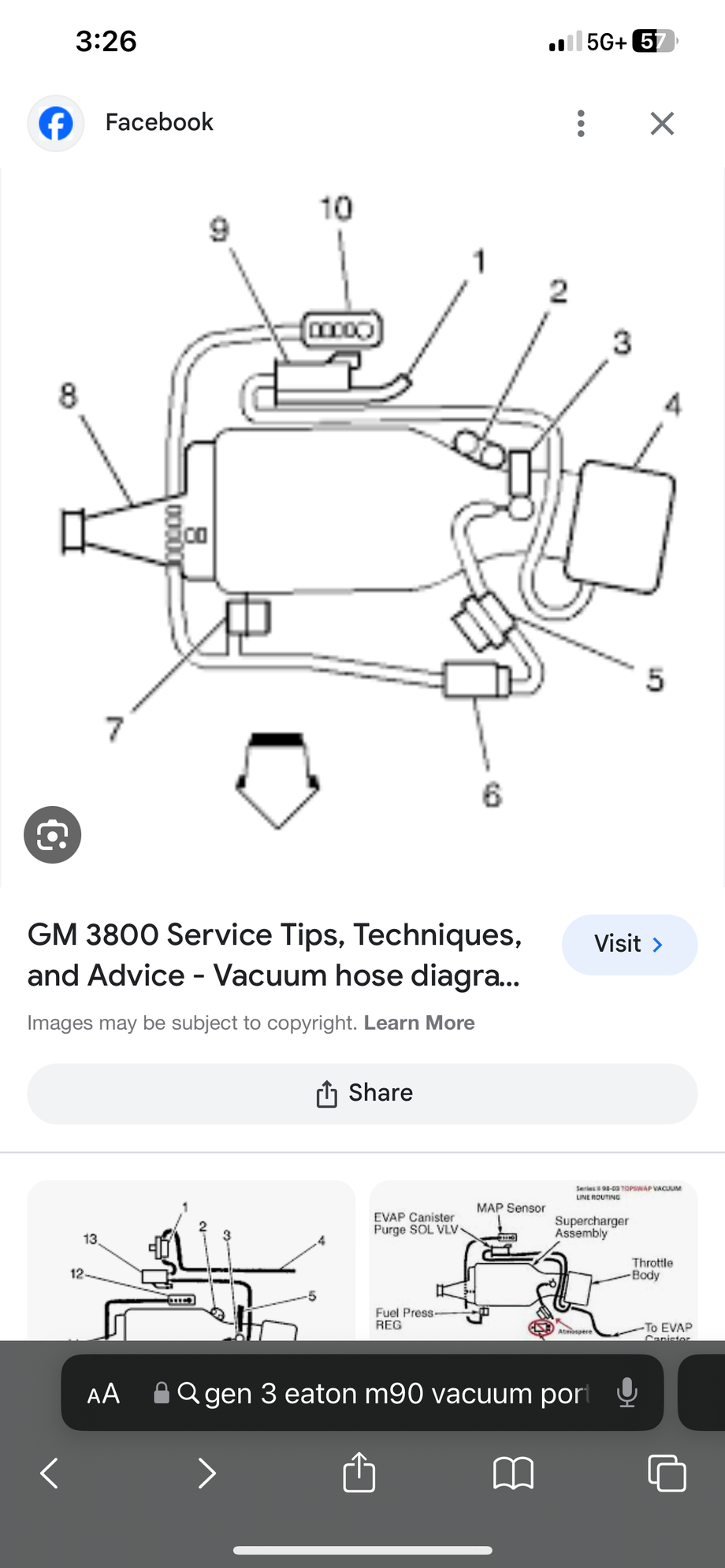

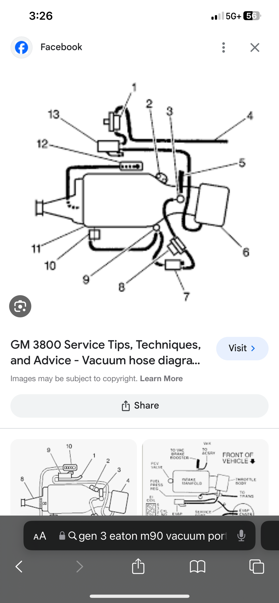

1. Which way should i route my vacuum and should i delete my EVAP system? Ive found two different diagrams one representing the 97 and 98 routing:
and the 98+ routing:
Thing is i don’t remember what year the supercharged parts are from i think 97 but i have a 2002 block.

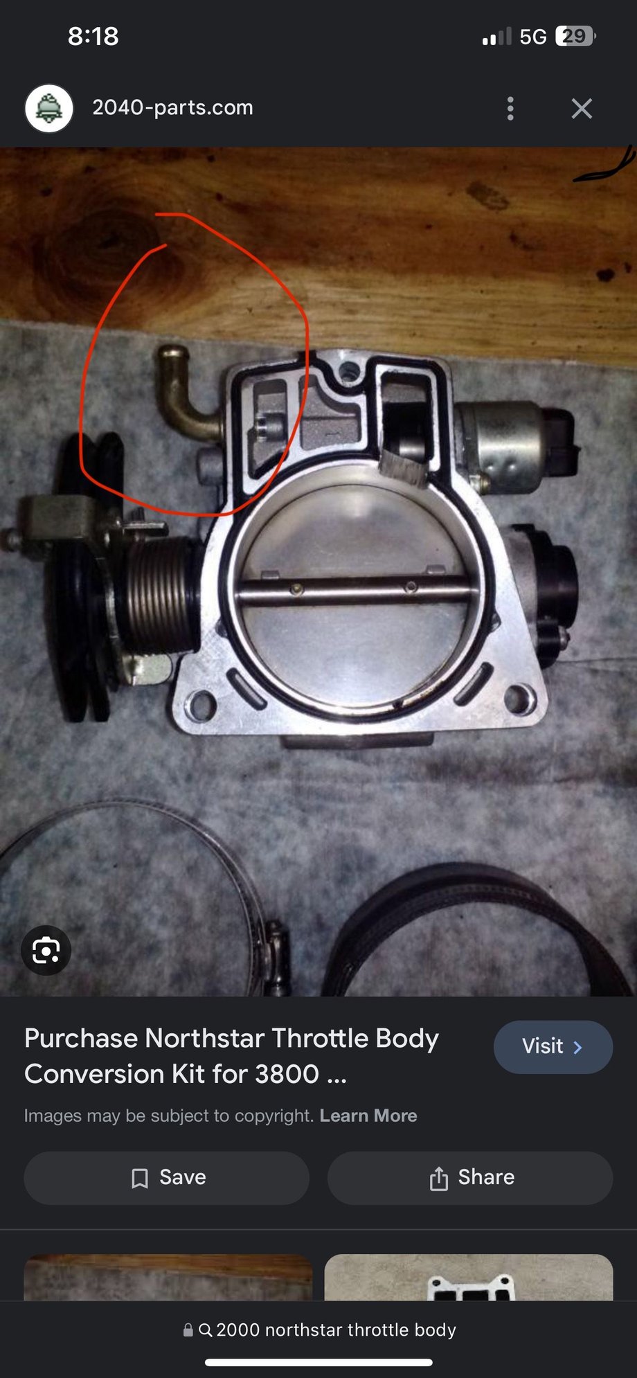

2. Where do i route the vacuum line from a northstar tb
also what size hose do i need
If you've got that 97 vacuum post in the front of the blower, you can do either. If you want to run the newer style, you can just cap that front vacuum post on the blower.
I wouldn't. Unlike some emissions equipment, there really isn't any downside to keeping it. If you've already got a functional evap system, I'd just hook it up.
I'll admit I've never done a N* personally (I run a LS style on mine). But the stock TB has a vacuum port on it, so Id presume you'd just hook up whatever hose that ran to the original TB up to the N* instead.
