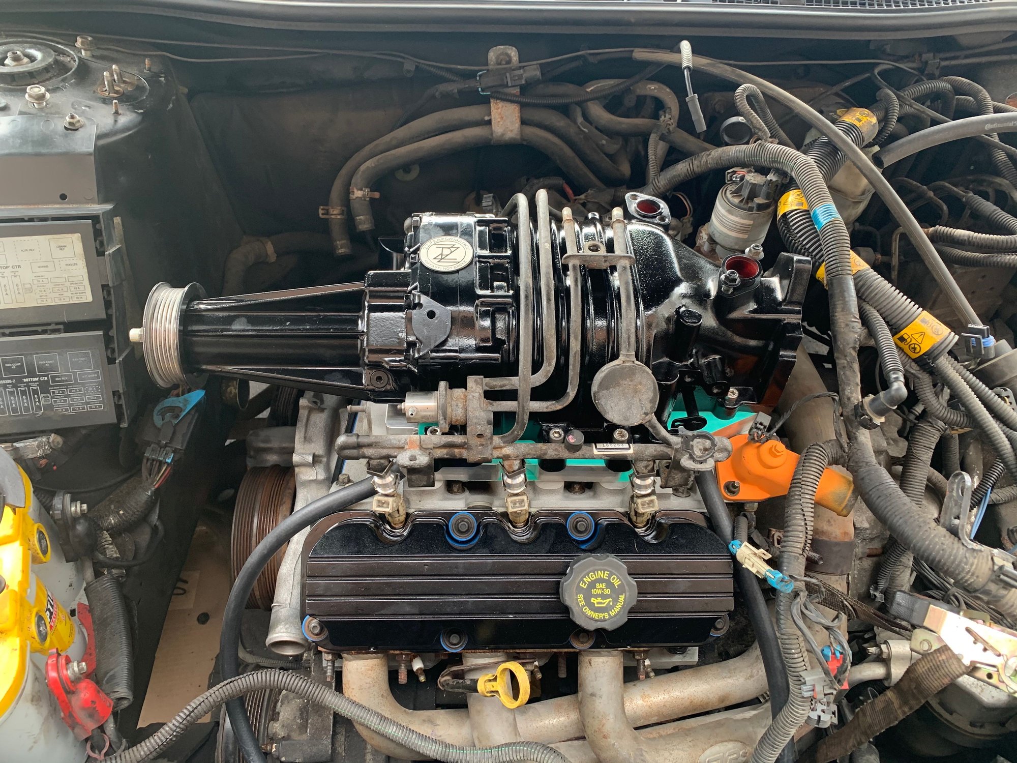

So I’ve been MIA for quite a while and so was the car. It’s spent the last 5 years in a barn collecting dust.
During that time a machinist has my L67 heads to oversize the valves and do some custom work on them as well as the lower intake.
Due to a work injury the car sat in my driveway with the engine torn down to the deck since last August.
Well as of this past Monday I’ve been slamming it back together with the following parts list:
-custom heads
-Gen 3 Eaton with a 3.1” pulley
-custom LIM
-intense stage 2 cam
-Comp OER lifters
-Comp 125lb springs
-ZZP intercooler
-YT 1.7’s
-Meziere water pump
-Cometic 4 ply head gaskets
-custom length pushrods from Intense (7.200”)
All that combined with my previous mods and I’m only a half day away from hitting the key.
If anyone has a picture of vacuum line routing that would be super cool lol.
I still need to figure out my belt length and how to wire the small solenoid by the boost bypass valve. Anyone got the wiring fix?
When I hit the key for the first time I’ll be taking a startup video that I will post on here.
I didn’t spend the most time making it look purty under the hood but all the new shiny stuff is still like looking up Bridget Wilson-Sampras’s skirt.
Back soon all!
JK

Thanks wht02monte. I think that’s how I got it all setup up now. I was using the grey matter early this morning. For the big vacuum port on the TB though there must be a L67 specific hose that goes to the back of the engine for the evap.
I just wish I knew where to wire that solenoid that has the one Vac port open.
The port you have capped on the top of the SC I used for my HVAC. I just looked.
