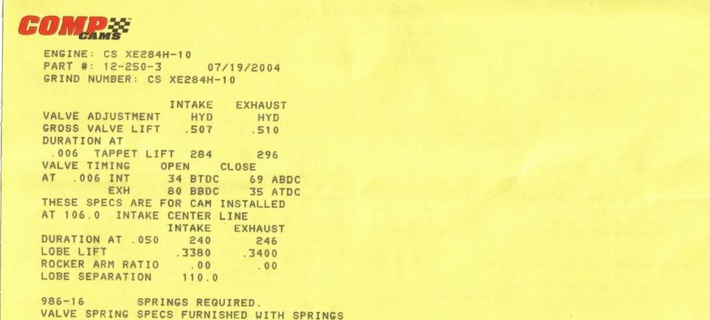

what cam are you running in that?

comp cams

i thought it would be a little more aggressive is this your daily driver. are those the rpm heads on it?

yes, they are the 64cc edelbrock performer RPM heads, and its a real aggressive cam
not a daily driver, just a weekend cruiser
