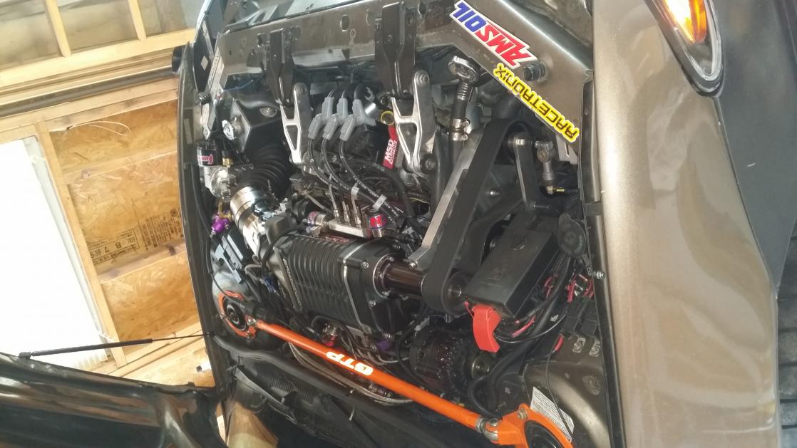

jonbobs car is spraying nitrous and is at prj getting the finishing touches done to it. There estimating 620-640whp
I don't know if you know this or not but Jonbob sold this car and I know the new owner pretty well, I actually seen this car in person.
