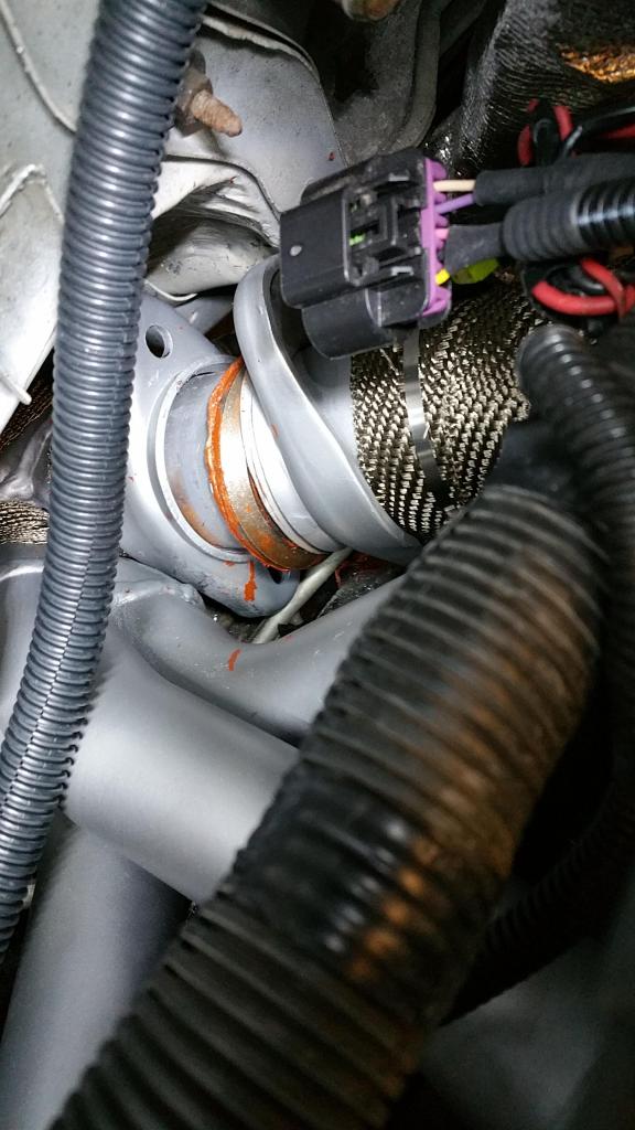

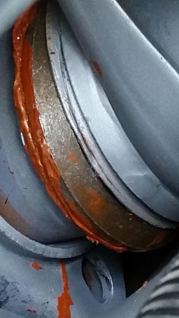

The big downer was messing with wiring on the backside and noticing a big gap in the rear header at the crossover flange. There was a roughly 1/8" wide x 1.5" long gap where I could literally see into the crossover pipe. I thought I just had the crossover angled wrong when I installed it, so I pulled the crossover back out.
Turns out, it is impossible for the crossover on this set of headers to seal at the front and back crossover connections both. If I rotate the crossover to get a better seat on the back (until the pipe hits the egr tube), it doesn't quite get to the point of touching the donut all over, and it also unseats the front flange so I have a gap up there. See best case scenario:

Keep in mind, even in this miserable condition, the front has a nice sized gap into it.
I won't rehash the issue much since I discuss it in more depth in the header thread, but this is definitely a setback. Really shouldn't have to hack up a $900 set of headers to get them to fit (granted I bought them used, but still paid almost double what the ebay SLP knockoff headers go for). I really should've left my other headers on...

Yep, that was the second thing I tried. It definitely doesn't go that way because that puts it going straight into the brake booster. The fit is certainly close with them this way, but unfortunately close doesn't really cut it when you're trying to seal exhaust up.
Ouch man... That definitely sucks. Is it not round enough? I know you said something about using a pipe expander before...
Nope, that only applies to the SLP style knockoffs with slip fit pipes (I guess to an extent the Pacesetters too where they used to have a large mismatch in diameters). I did have to use the expander on my DPPs to round the tubes out better.
With these stupid flange setups, the connecting pipes basically look like the end of a trumpet- flared out at the end. Then you've got a 'donut' gasket that is just a ring with an angle on each side to butt up to the 'trumpet' ends to seal them together.
The upside of this type of setup is that it's supposed to be more resistant to angle mismatch issues because the two flared ends don't have to be pointing directly at each other to seal. However, it can't help you in a case like this, where the pipes are offset. Even with the most extreme angle I can get on the crossover, it still doesn't put the outlet close enough inline with the rear header inlet.
I think I'm going to weld extra metal onto the 'trumpet' part of the crossover to bring it in contact around that side of the flange. I estimate only having to add 1/4" to 3/8" more material to get it in contact. The only thing I want to make sure of is that directly opposite that area on the donut- across the diameter, is touching the inside of the pipe to still seal. I can't see whether its touching the inside or not because it's open towards the firewall.
If that doesn't work, I think plan B is to cut the crossover in half, bolt both flanges up, and then weld it back together. I'll admit I'm not real crazy about doing that because it'll probably look like crap, and will kill resale value on the headers.

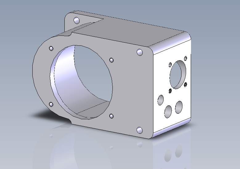

New TB adapter design is done, just need to cut it now.
Whipple BBV mounts to the side, and the holes beneath it are going to be tapped for barbs for vacuum lines (brake booster, PCV, etc).
