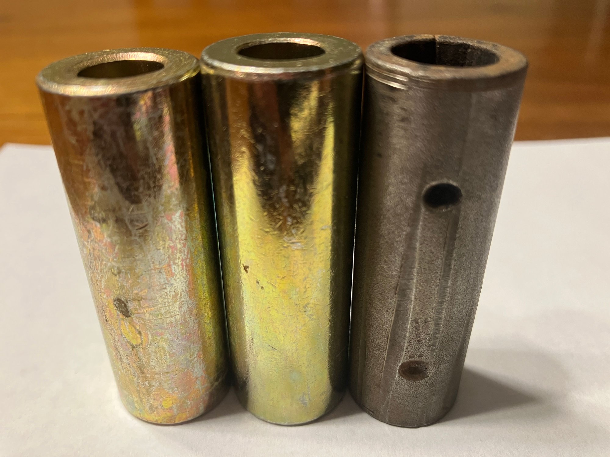

  • Common complaint with ZZP bushings is during install, people tend to over tighten the bolt going through the bushing and it cracks the aluminum of the brackets on the engine. I believe I see why. In each pic, the metal tube is pushed all the way to the table (so flush with the bottom end). So let me explain what I noticed and tried to capture.
    • It's not much, but was can see the ZZP tube is too short.
    • The Intense Racing bushing looks a bit short with a longer tube.
    • I have a tube that I removed from a factor rubber bushing. When we compare all three tubes, we see ZZP is short compared to the equal length Intense Racing and stock tubes.
      • Even though people installing should know to NOT over crank on that nut/bolt, the ZZP tube makes it super easy to just over tighten things. Yes, even with the factory length tube, you can still over tighten and crack those mounts.
    • We can also see the inside diameter of the ZZP and Intense tubes are a tighter fit vs the factory tube.
    • I did try to see if the factory tube might fit in the ZZP bushing. It is NOT a tight fit. If I wrap one layer of electrical tape around the tube, it then has a proper fit. But, that is a really goofy setup with electrical tape and I would be concerned about how big the inside diameter of that tube is for allowing the engine to rock.
    • The answer.... I could not find where to buy JUST the tube OR get the right tube stock and cut to length. But, I was able to talk to a friend at a machine shop, and now I have two hard metal correct length tubes.

Its the first I've seen that issue with the ZZPs having a short sleeve - you'd figure they'd really watch that given the propensity of cracking mounts! I'd suspect most people just slap them on and don't even look at them that close to see if they have an issue.

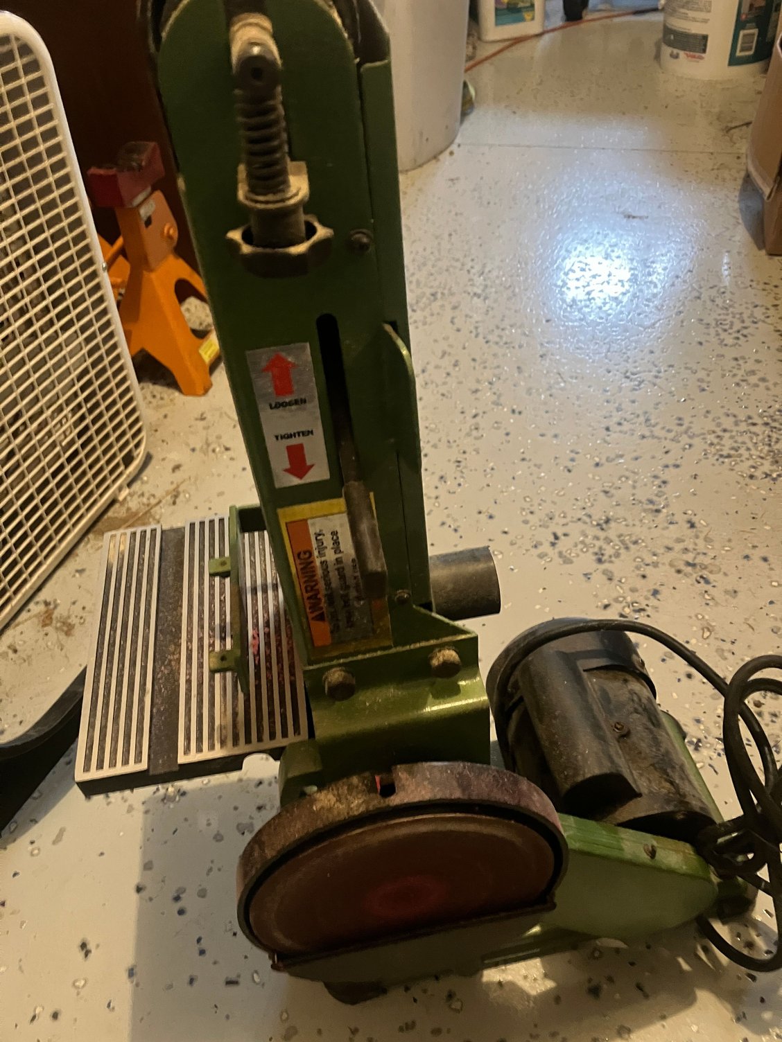

So, to solve my bushing problem, I borrowed a Harbor Freight bench sander!
I don't have pics of the ZZP bushings, but to handle it, I sanded down some of the part of the bushing you never see that is covered by the metal of the dog bone. I also sanded some of where the bushings would touch (but not much). After some careful work and taking my time, got them to fit perfect.
The Intense Racing bushing, again, slow and careful work to not remove too much material and get the shoulder thickness reduced. Each pic is a unmodified Intense bushing vs a modified bushing.
I tested the fitment of both the ZZP and Intense bushings with a spare bracket I have in the garage.
