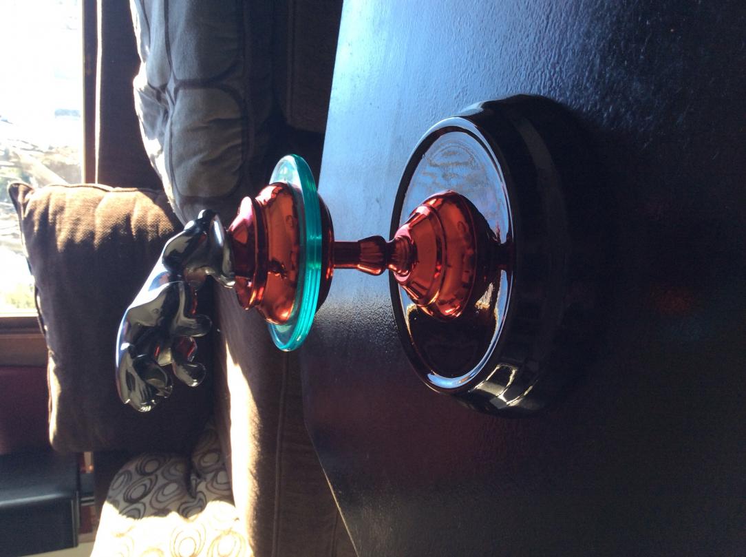

Here is another example of the "red" I did for a gift for a friend.. I made this as a joke gift , they wanted a Jag... So... Lol...
That is very definately a piece of art...... Well done...

After she received the "Joke". She started to cry because she loved it so much, I kinda feel like a heal now..... She put it on her mantle in her living room and said its one of her favorite items she owns.... Guess some things just touch a spot in someone's heart and that's AWSOME.....
Thanks for the kind words... . Michael...
