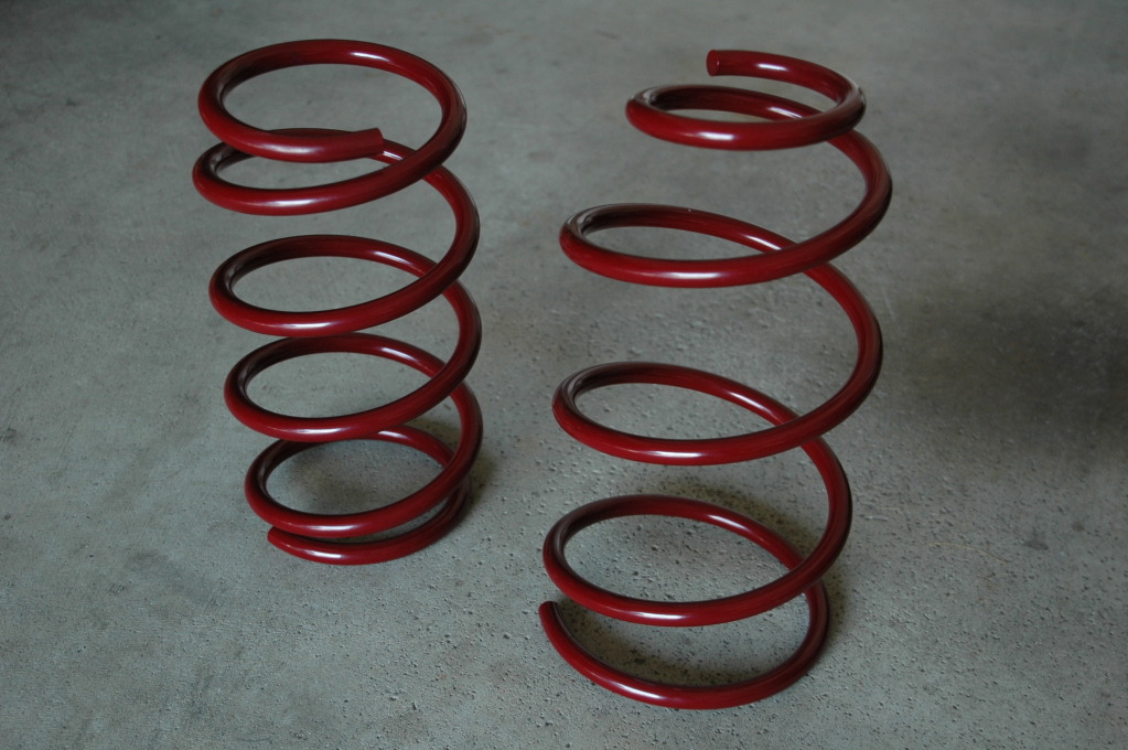

This is why I don't trust ebay lowering springs.
The coil springs for the 2000-07 Monte Carlo should be obvious enough to distinguish between front and rear; the fronts are a smaller diameter coil at both top and bottom and the rears are a smaller diameter coil only at the top. Lisa already mentioned they were installed correctly, and I believe it. I honestly think it would be hard to install the springs backwards. I just think these particular rear 'ebay' springs aren't designed correctly for the application.
Here's the difference in Canuck Motorsports' fronts (left) and rears (right) that I'm running.
The coil springs for the 2000-07 Monte Carlo should be obvious enough to distinguish between front and rear; the fronts are a smaller diameter coil at both top and bottom and the rears are a smaller diameter coil only at the top. Lisa already mentioned they were installed correctly, and I believe it. I honestly think it would be hard to install the springs backwards. I just think these particular rear springs aren't designed correctly for the application.
I totally agree with you Matt!

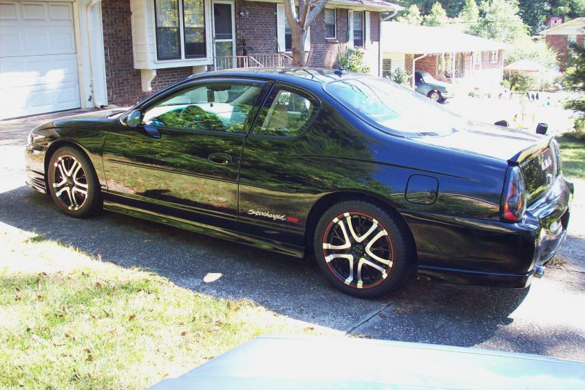

Back is lowered! All better now. Better than it was. Good enough for me for now till next year. Alignment gets done this week.

We cut a full coil out of the stock springs. She gets alignment this week, and I need to get the roof rails on, then "project: interior" will be underway!
