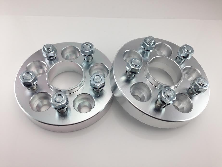

Thanks for the help guys. That should get me going with a direction. I found a set of 1" spacers which would get me going I think. They bolt to the hub, like the wheel would, then the wheel bolts to them, so I wouldn't have to press in longer studs like I thought I would. I think the reason why the tire is rubbing the bottom of the spring perch in the front is because of the deeper offset and width of these wheels. I checked the difference in height and it's only a ~1/4" difference between the tires. The stockers look like they'd rub if they sat in any further, so I think that's the biggest issue and spacers would make this combo work, without replacing tires yet.

Check the link they call them HUB Centric spacers. this is what I used in the front.
wheel spacers 5x114.3 | eBay
Attached Thumbnails Thinking about calling it an SS now/ Last piece of puzzle-spacers.jpg
These are pretty much what I found, albeit on a quick Amazon search. I think I'll probably be using them. Thanks for the link!
