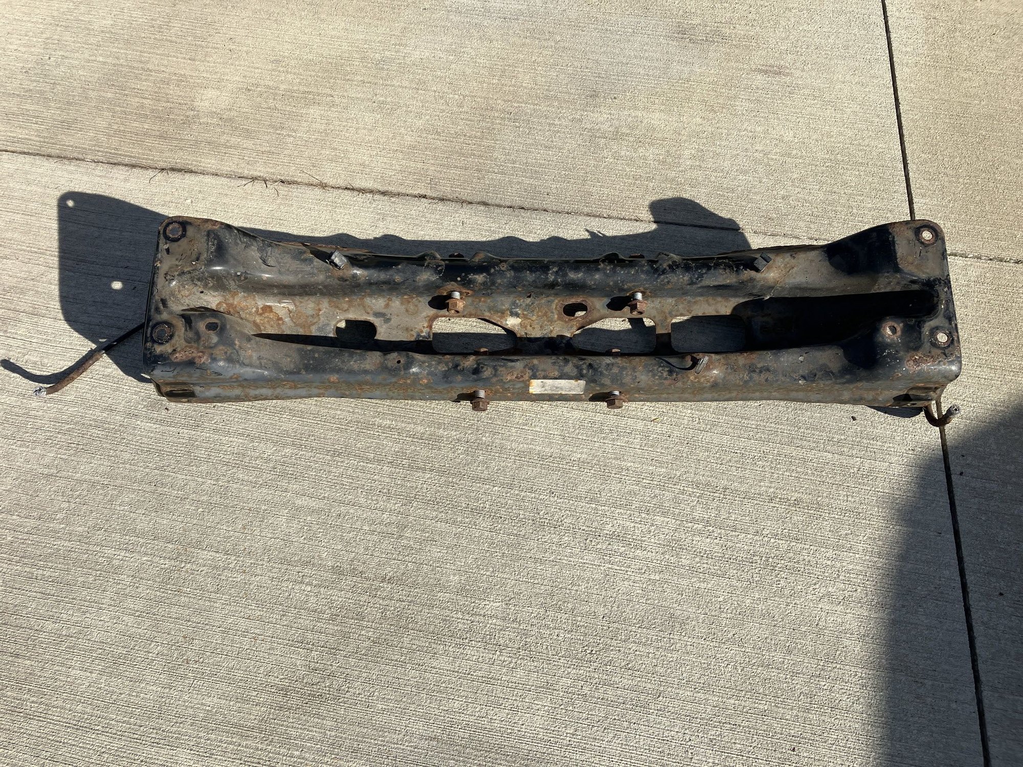

The black Monte needs a few suspension fixes. I have UMI Performance rear trailing arms for it. I also plan to replace the rear laterals (just stock replacements). When I get to the rear laterals, it is a good time for other items. Such as, I would like to clean up some of the under body and coat with POR15. To do this best, I would like to remove the rear cross member (which would make doing the rear laterals easier). I picked up one from the junk yard off a 2008 Impala (looking at GMs interchange, this was used up to the 2016 Impala). It has a little surface rust, but for $25 from the junk yard, I figure clean it up and POR15 and good to go! This let's me prepare the part and then get it in the car, avoiding down time in the project.

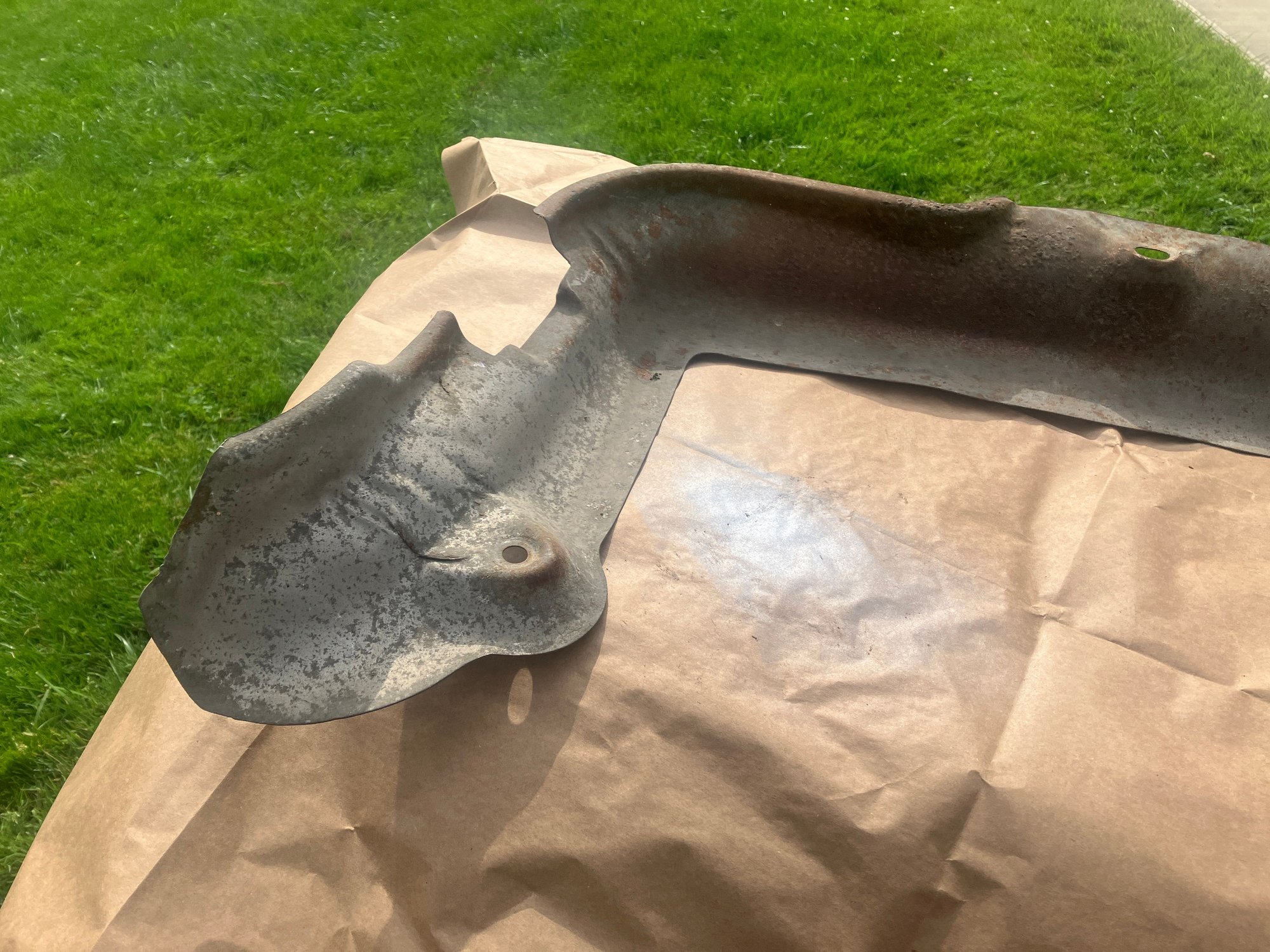

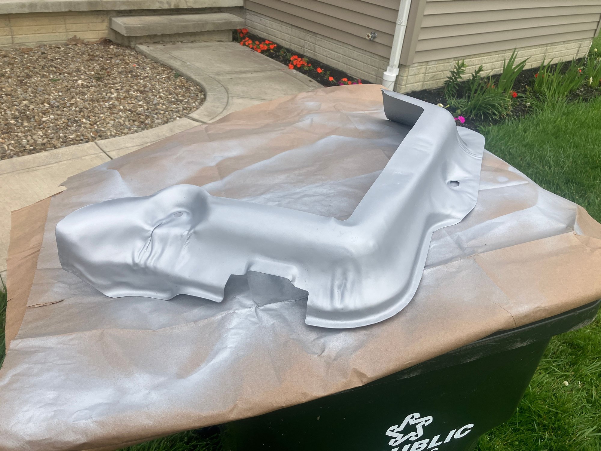

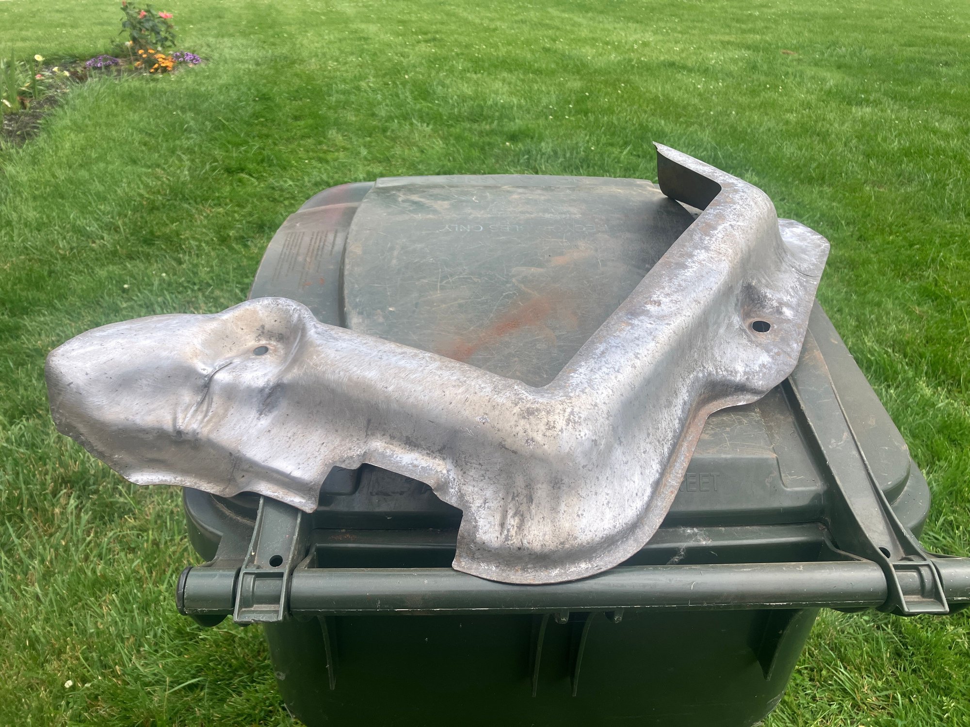

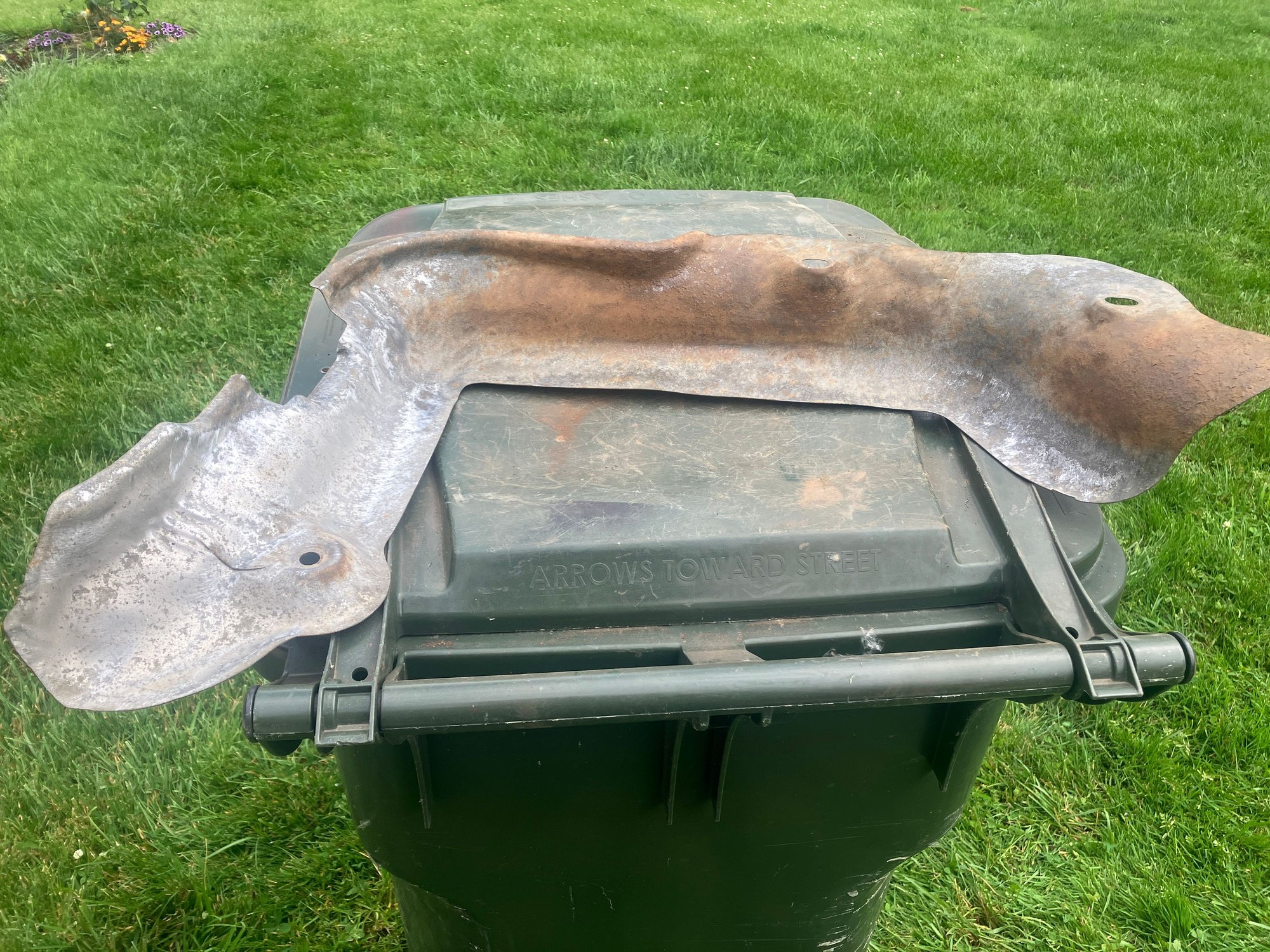

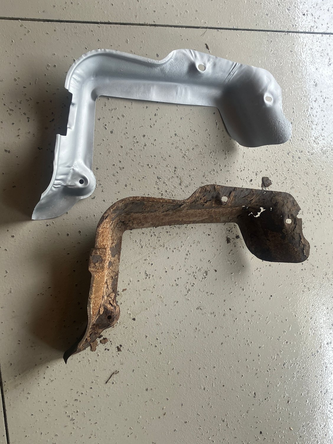

The black Monte is in need of a replacement heat shield around the gas tank. Sadly, the part is discontinued. I was surprised to find two at Pull-A-Part that were decent/re-usaable. I grabbed them both. I took the worst of the two, hit it wire wheel and then hit with some "Rust Fix" and top coat with high temp spray paint. The rust seen was surface rust, barely worn through the coating on it.
Today during my lunch break, I went out to the garage, put the Monte on the lift and changed it out. The old one was rotted pretty bad and barely needed any effort to fold it and throw it in the trash.
If the rust fix and paint doesn't hold up, I will take the other one I have and use it as-is.
