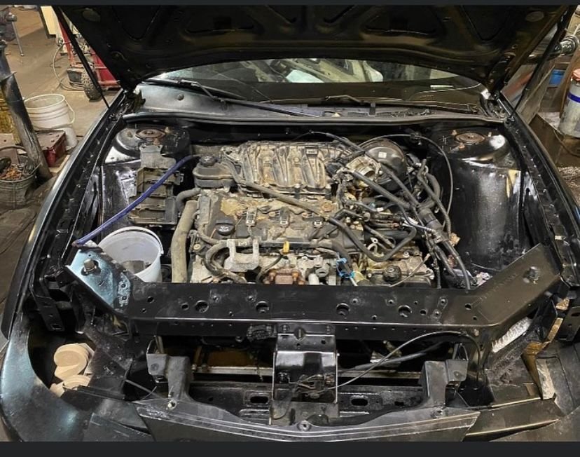

Hey guys, I know some people want more detail into my 03 3.6 and 6t70 swapped monte so here you go
first of all, this was a pretty fun swap, and as far as I can tell I’m the first one to actually do it!
so we had a 2012 impala sitting in the yard (accident car) and I was having a lot of issues with the 3.8 and 4t65e that are original to the car

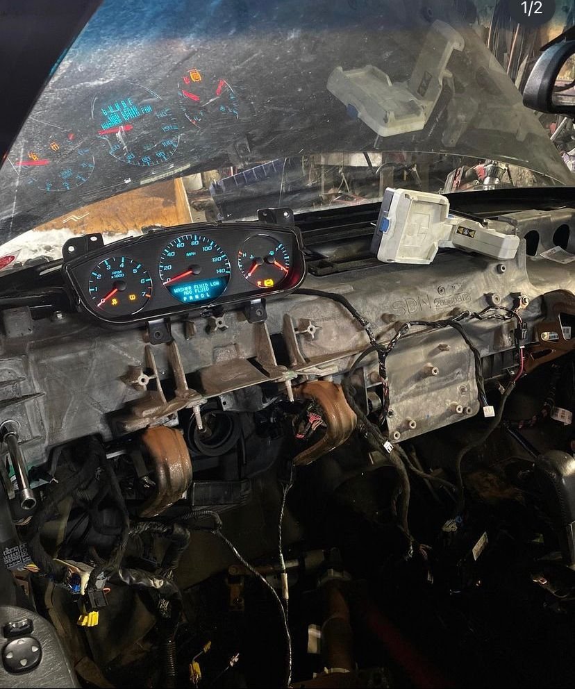

i started by stripping the 2012 almost all the way to the ground, whole interior, all of the interior wiring, I pulled the entire engine/trans/subframe assembly out the bottom of the car since I have a garage with lifts, I even pulled the fuel tank and all the the brake and fuel lines out of the car since they where all in brand new perfect condition and the fuel tank and pump have differences to the monte (mainly because the 3.6 is direct injection and has the ability to run e85 factory) once you have the interior apart you can pull the dash apart and you can actually get the whole dash and climate control box out in one piece, make sure you grab EVERYTHING out of the impala donor because almost all of it is specific to the impala dash (the ac box and all of the vents only work with the impala dash) you also have to use the impala throttle and brake panels because the 3.6 is drive by wire and the brake pedal is different with having pedal position sensors and other sensors attached to it, you also have to use the entire impala steering column becuase the flex joints are different and the column has a steering angle sensor due to the impala having stability control as well as abs and traction control, you have to use the impala shifter and all of the sensors in the center council (yaw rate and there is a sensor that detects what gear you use on the shifter itself) any thing besides seats, carpet, trim panels and stuff you HAVE TO USE. Every single wire in the inside and outside of the car is now 2012 impala wiring, none of the factory 00-05 wiring will work due to all of the plug ins being different because the impala uses can-bus and the monte using gmlan, for the doors to work and windows to operate as normal you have to use door wiring and latch from a 06-07 monte (all of it bolts directly in and plugs into the impala harness) if you want the interior lights to go off you have to keep the wiring and latches from the impala rear doors and hide them somewhere in the monte with them latched, for the outside of the car you must use the impala subframe due to all of the motor and transmission mounts being in separate areas but the subframe itself will bolt up and line up directly to the factory subframe mounts, you have to use the impala abs block and master cylinder/booster due to it being different, impala fuse box is necessary, and you will have to re wire the headlight harnesses due to the impala using different bulbs in different locations, same with the taillights. The 3.6 uses one dog bone that will mount up to the same place as the monte dog bone mounts, the radiator will have to be changed to the impala radiator as well, (in my case I’m using an impala radiator and seperate transmission/power steering cooler, I was able to keep my f body brakes but I will be upgrading to gt500 rotors and cts-v calipers, all of the monte factory wheel bearings will work with the impala stuff, none of the rear suspension needs to be changed as it is the same, you will have to use the impala air intake and box unless you make or get and aftermarket cold air intake, I will be posting more about this and posting pictures showing any differences, but everything bolted up directly and worked just fine besides the onstar and the fuse boxes inside the car (still looking for a way to mount those, will report later when I make working mounts) but as for that, that’s about it, if I remember any details I will make sure to add posts later.
