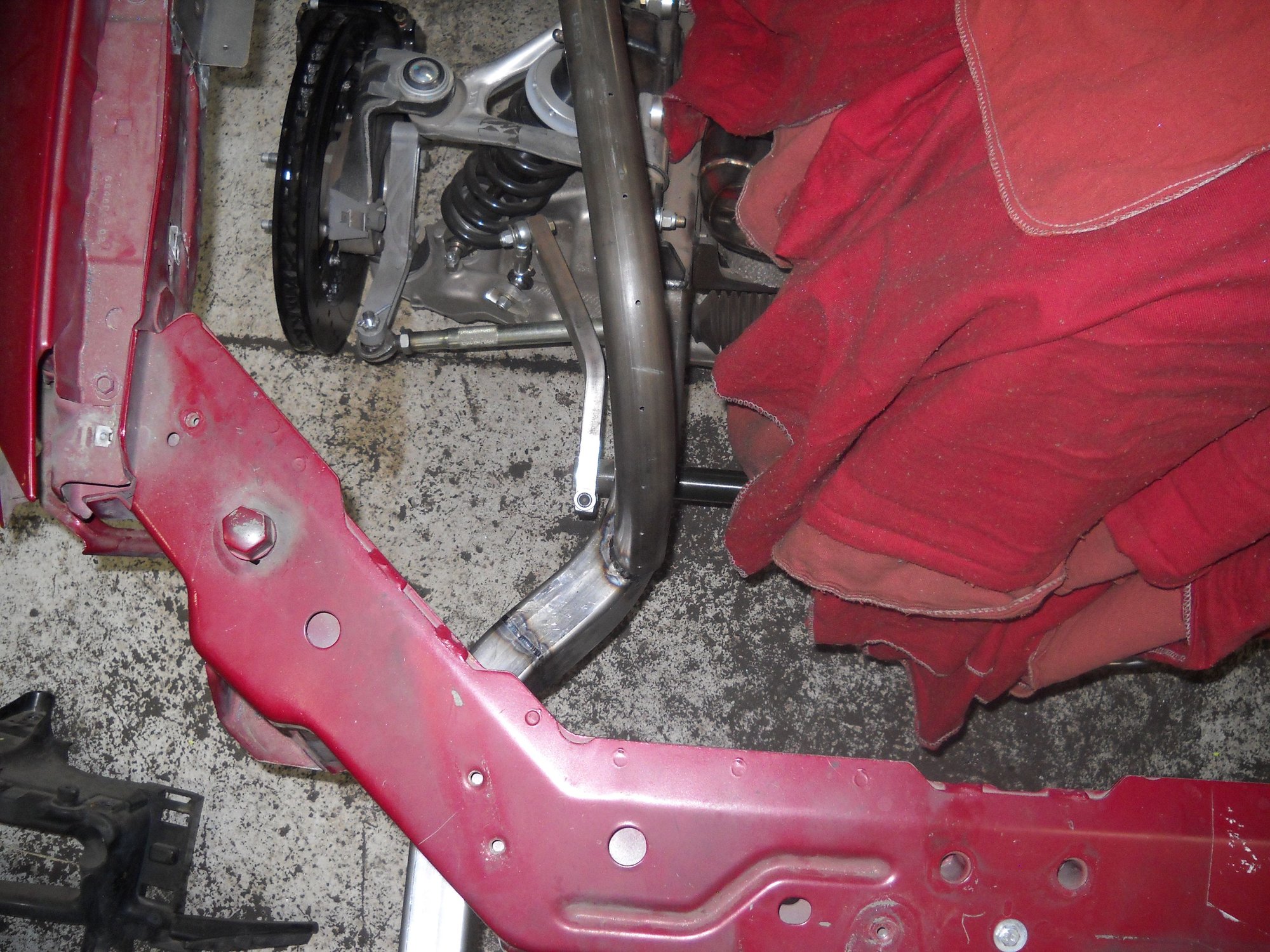

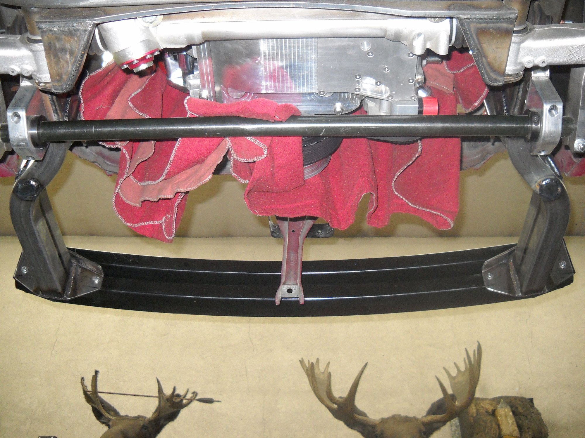

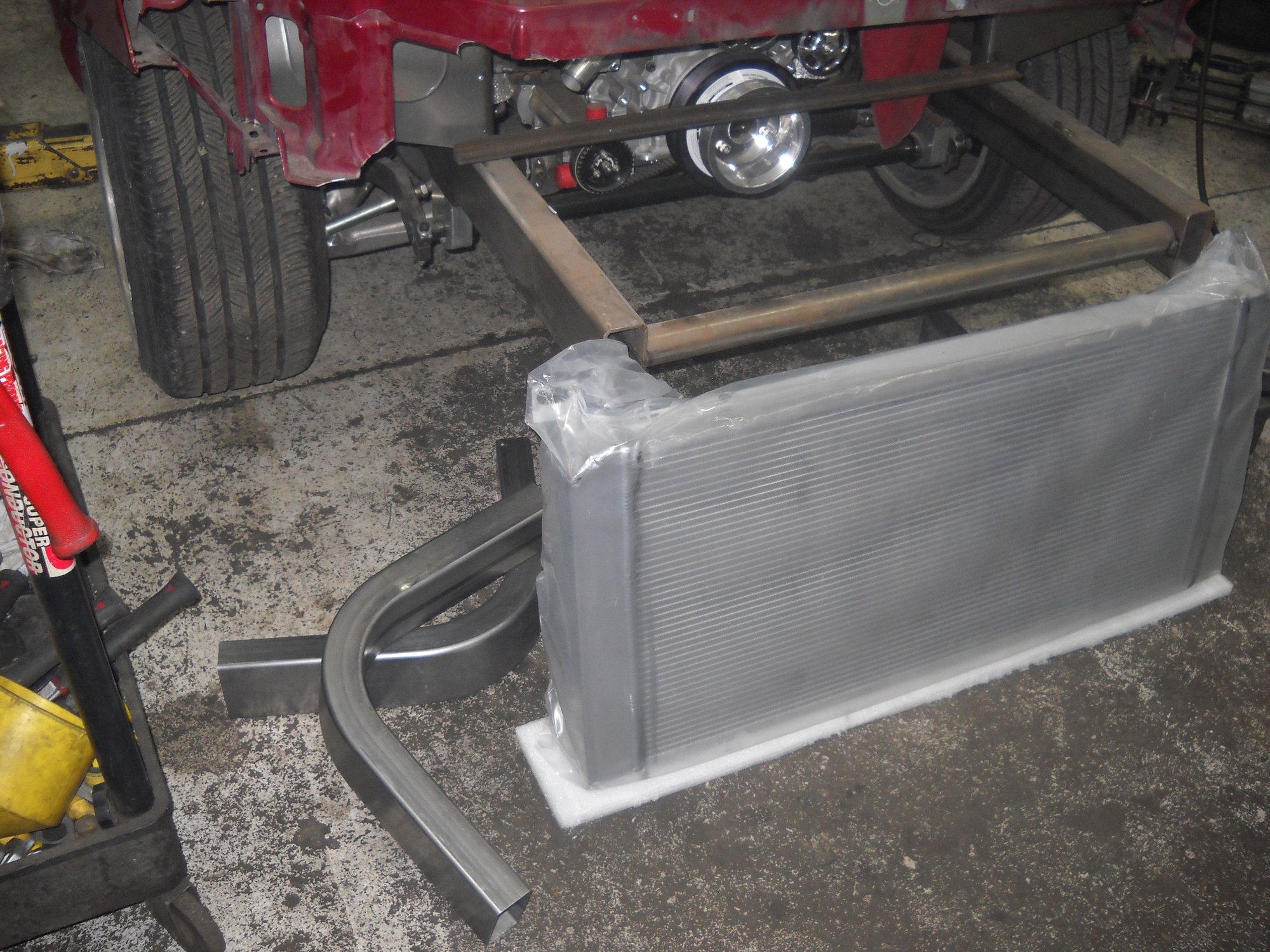

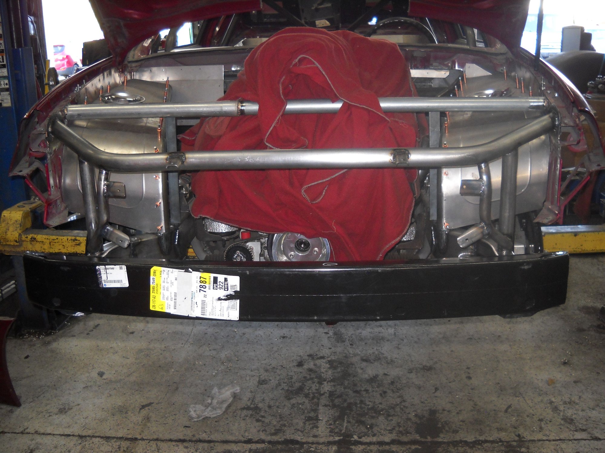

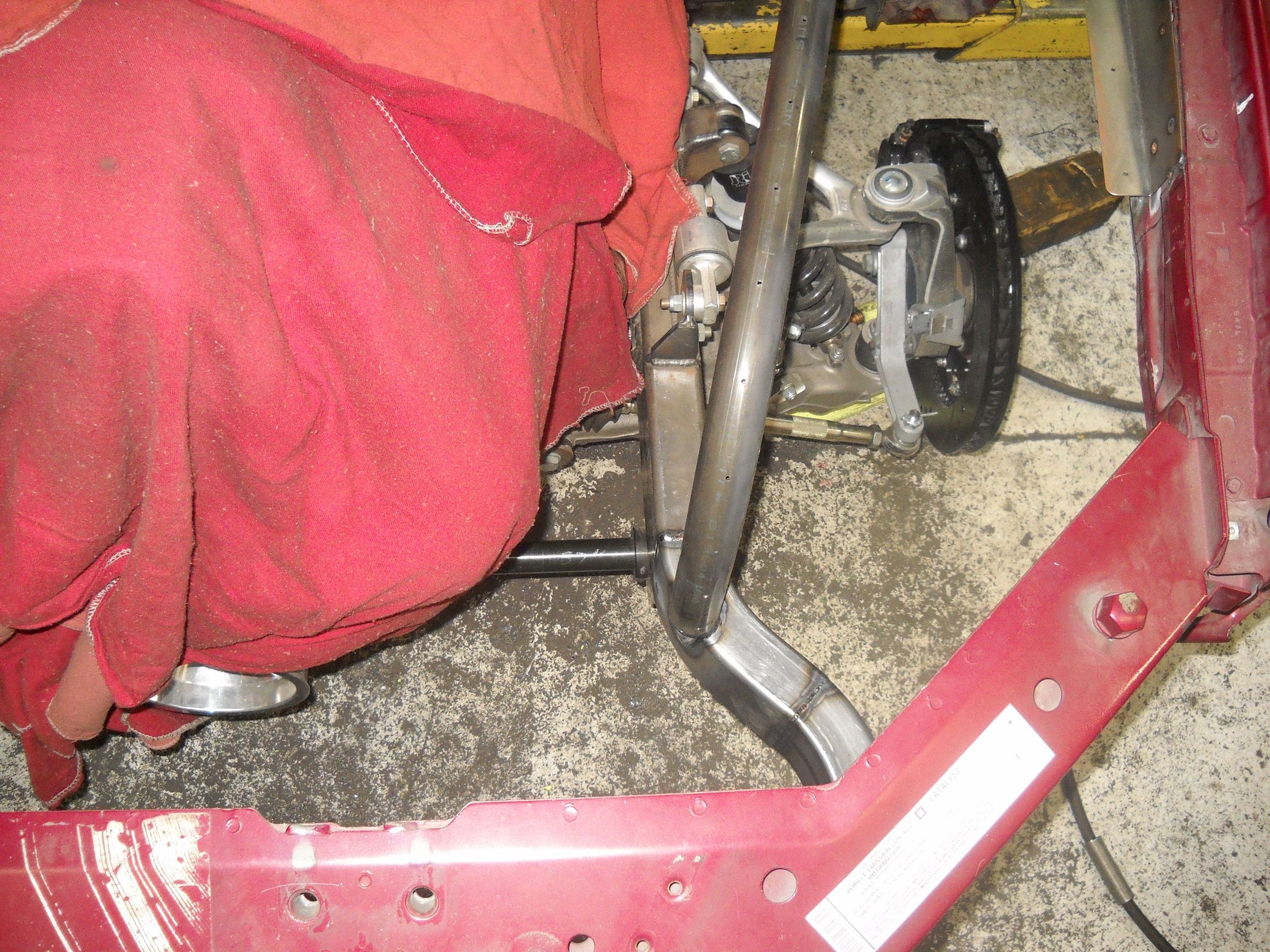

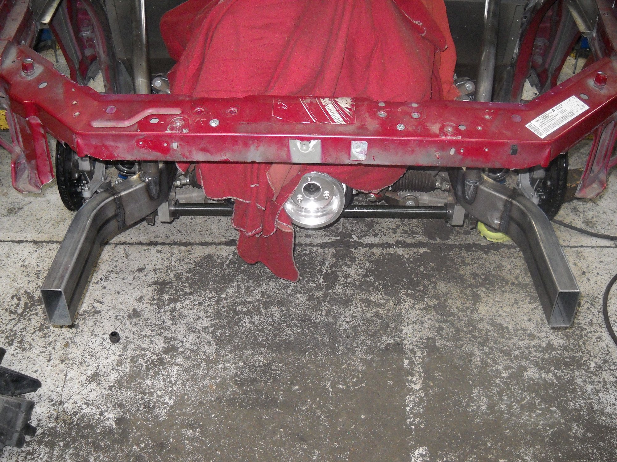

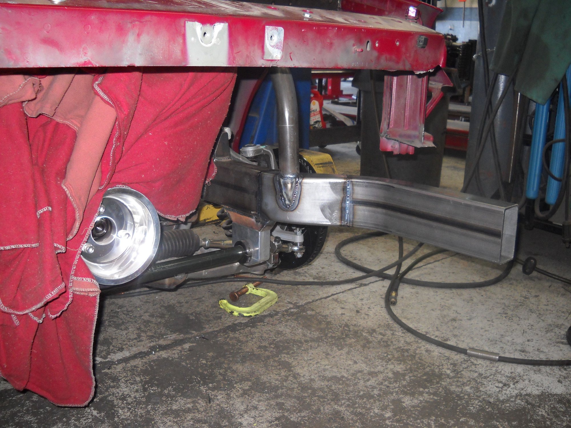

Mostly front frame work Fabrication fitting sizing and bracing. Drivers seat and adjuster.

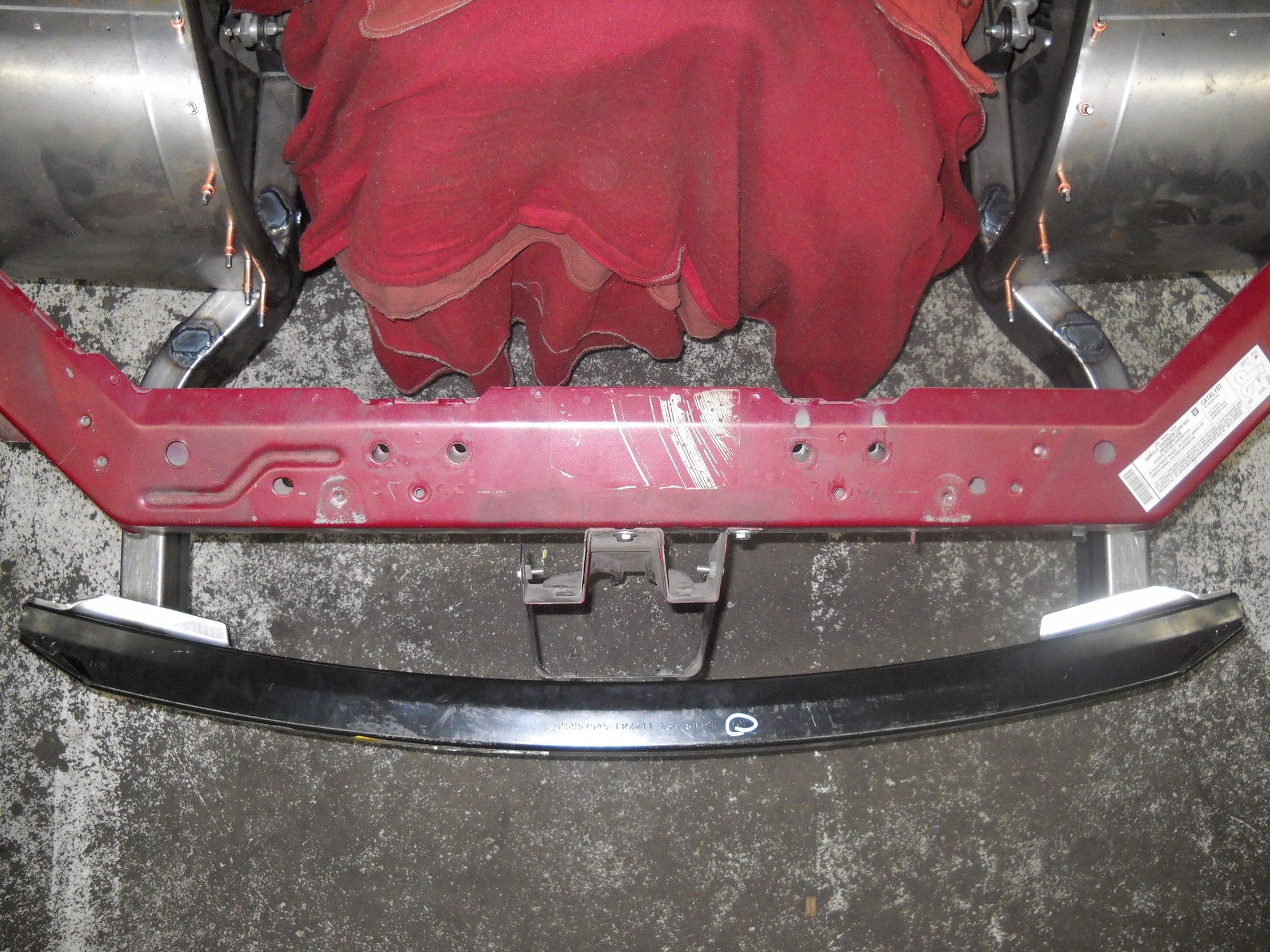

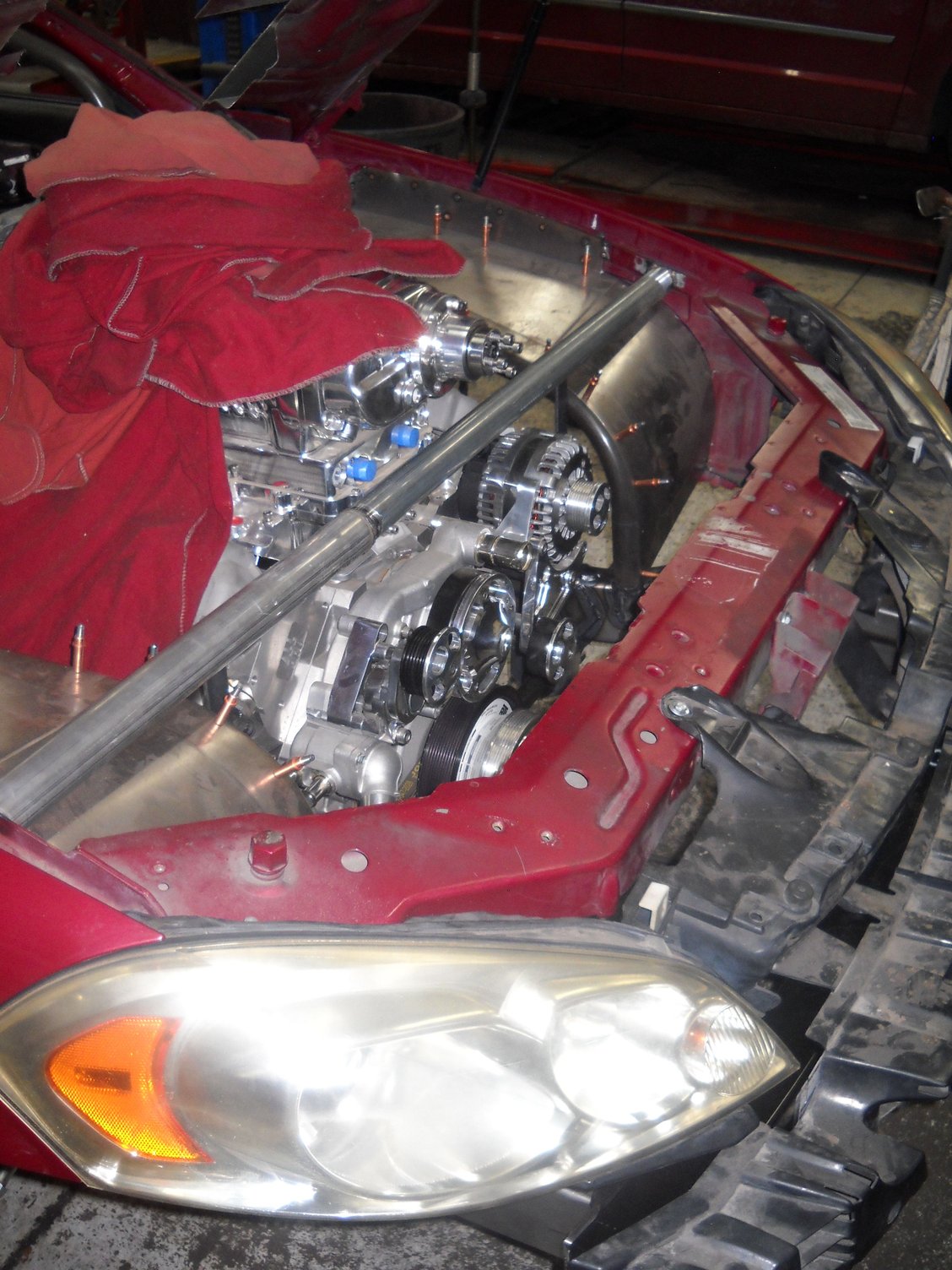

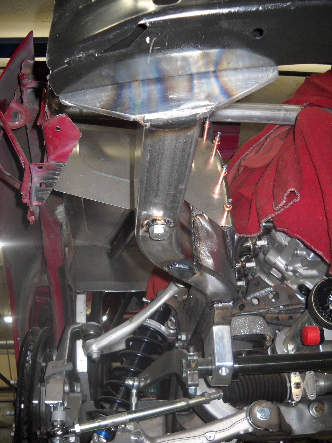

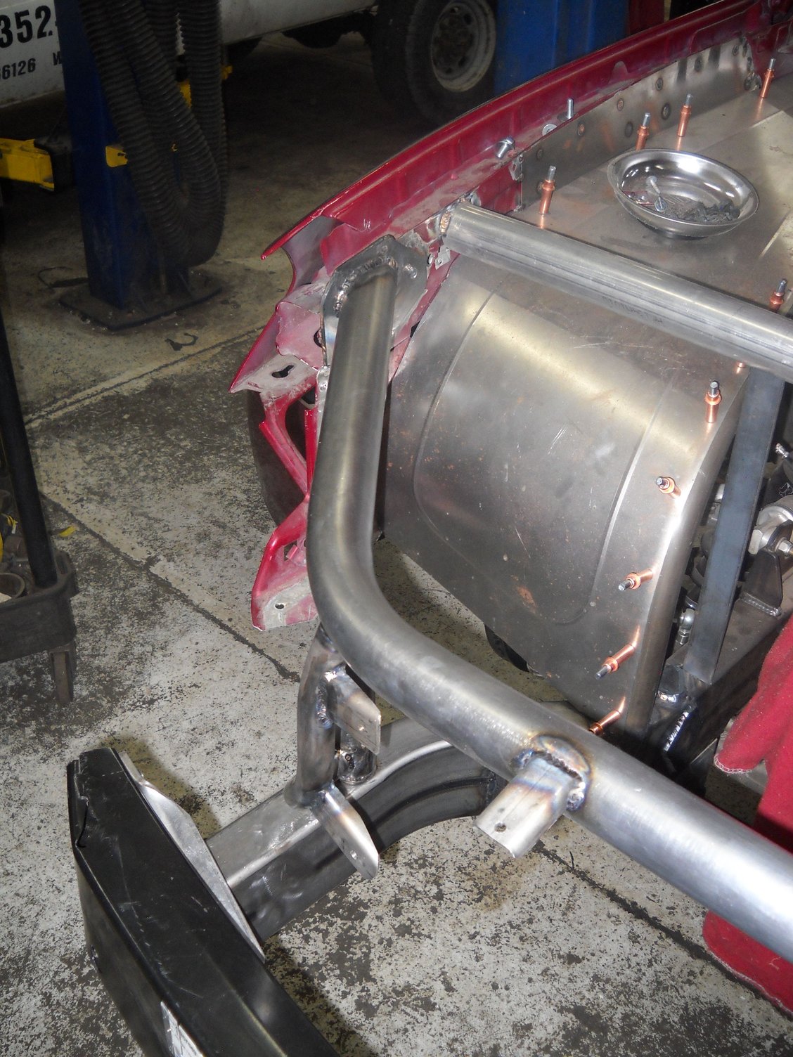

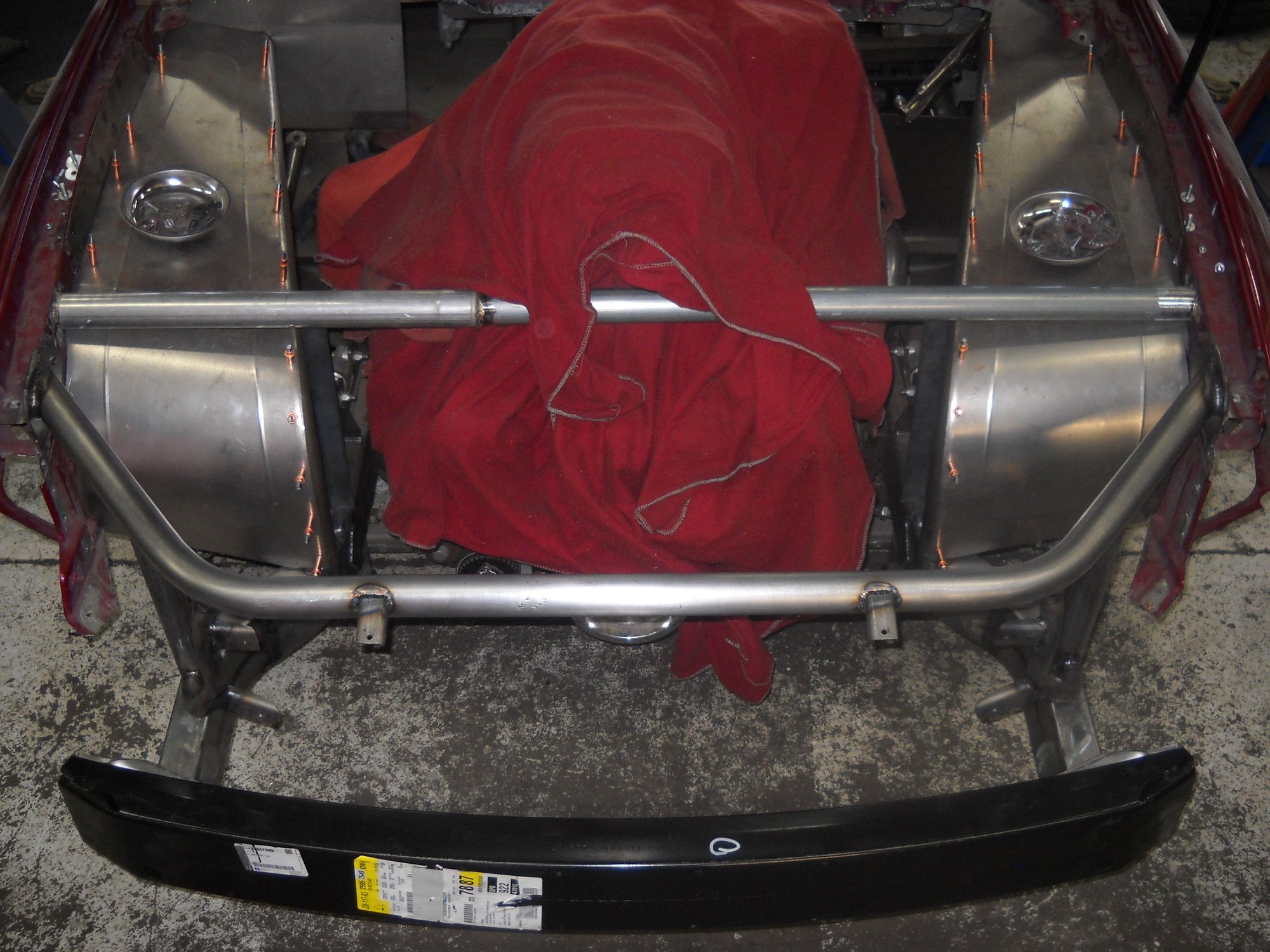

Default Core support work

That car is going to weigh 4,000 lbs....lol.

Very nice Sam, the Monte will be so safe for you, well as long as you wear a helmet and employ every other conceivable safety option. Matt is really doing the build of his lifetime for you. Simply an amazing piece of automotive history in the making. There is a lot of engineering taking place there, is he bringing in consultants for some aspects of this build. Seems like an awful lot of knowledge for one person to have. One can sit back and admire this work of art for hours, so much to absorb. Congrats Sir, coming along nicely. I'm going to have to stop by and give it a good once over in the next week or so as I will be going by the shop on the way to SLC. Who knows you may get a universal 2 Thumbs up review from the automotive enthusiast society.. Any talks with Hot Rod magazine in the works? Seems like someone from a magazine should be out every now and again documenting this amazing build.

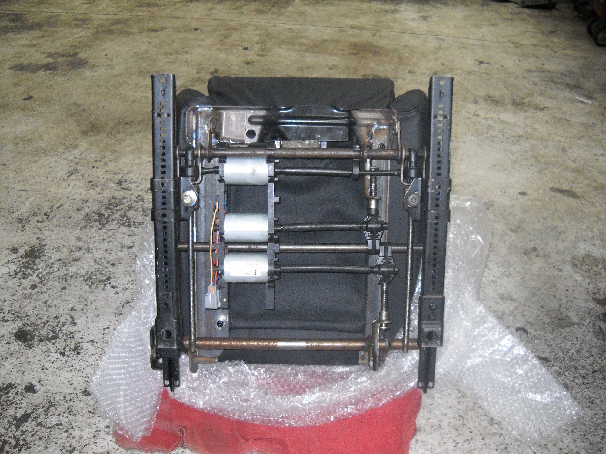

I would highly advise you to get that seat braced. My wife's Malibu seat just failed in the right front. The welds are cheap and will break fast. The round bar will break at the joint. You are going to be pulling 4gs and putting a lot of strain on them. Easy to do it now.
This is where it fails.

Thanks for the advise on the seat adjuster - I am not going to use this OEM part - did not fit correctly - have another from a motor home that works - will speak to my builder about bracing it - your advise is well taken - thank you. Sam
