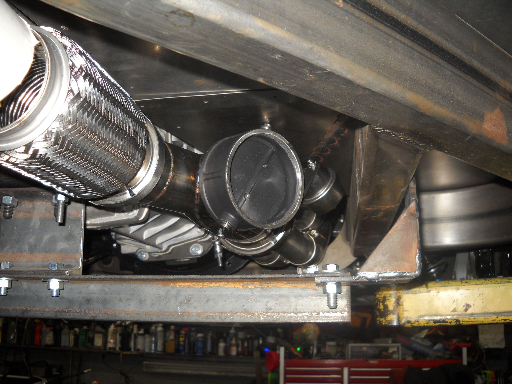

Default Exhaust
All the exhaust is here also

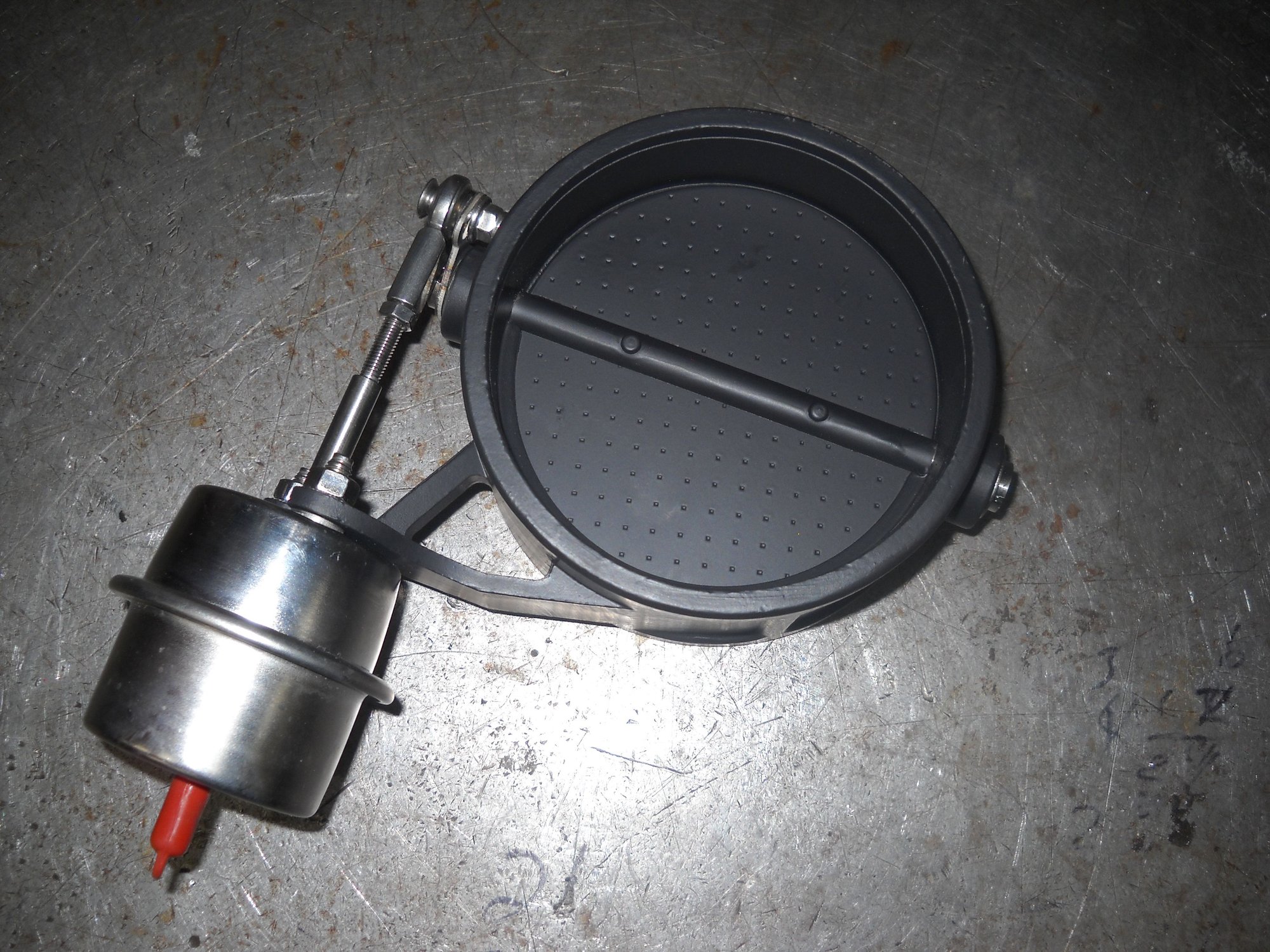

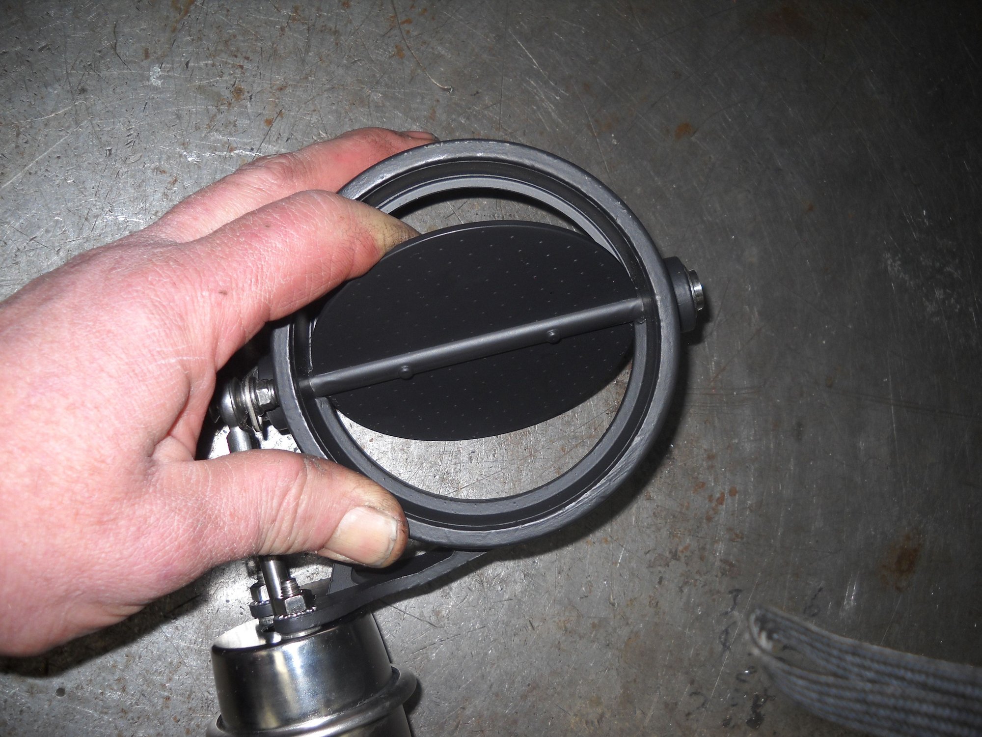

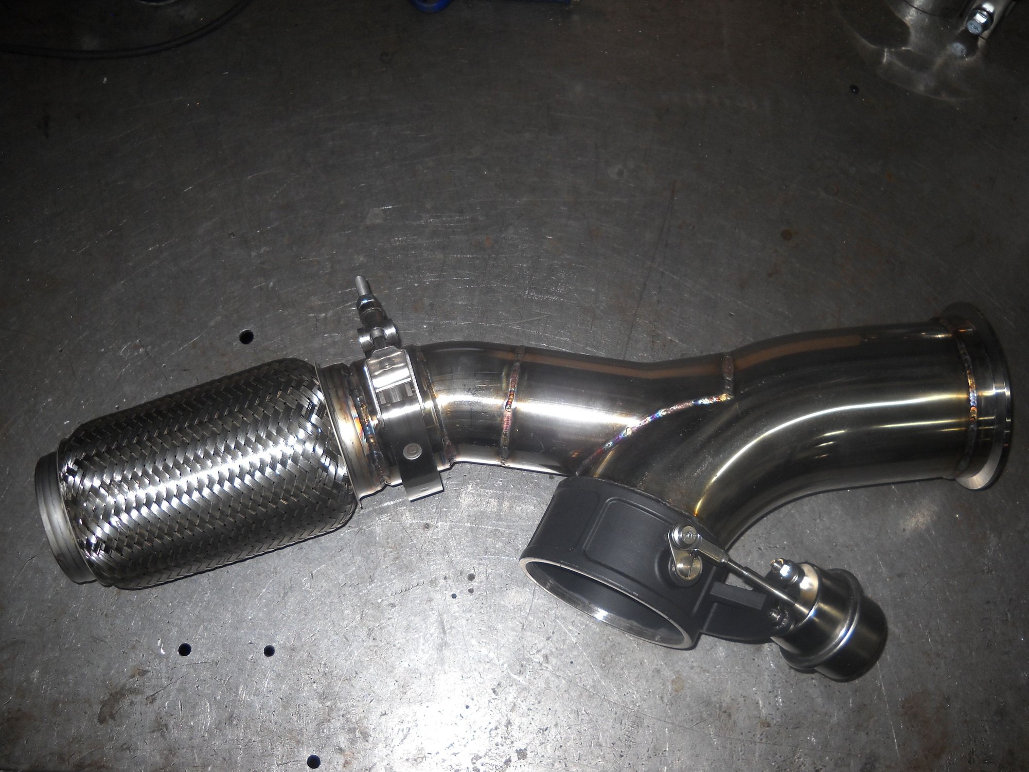

Default Header work
New vacuum cut outs couldn’t make the larger electric ones fit
Collector flange welded on and disconnect for collector added
Much smaller externally same 4” pass through.

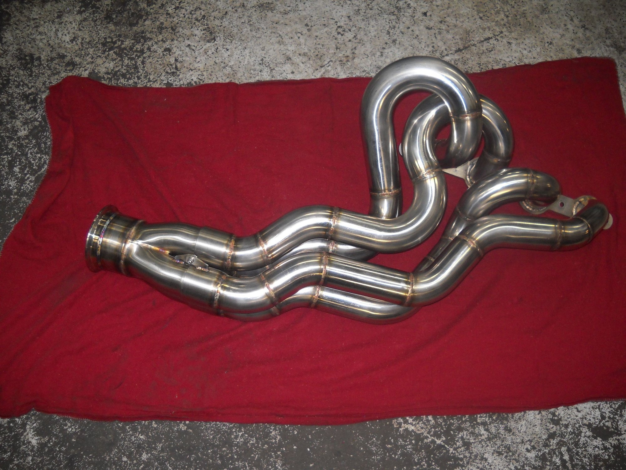

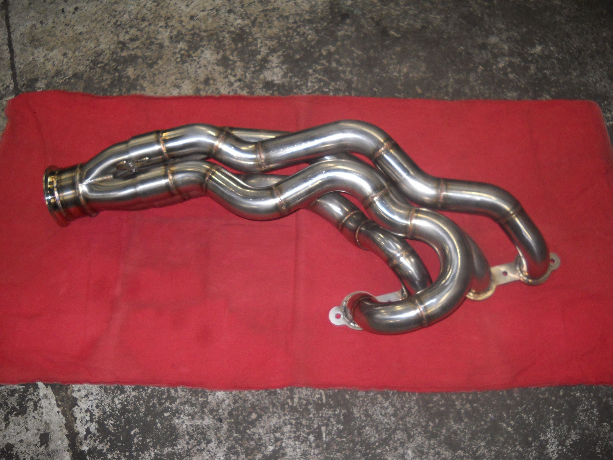

Old Jan 8, 2022 | 12:36 PM

Old Jan 9, 2022 | 06:02 AM

Posts: 4,945
Jheesh this build involves some very serious forward thinking / fabrications. That exhaust issue was such a showstopper, the work around was no small feat. Absolutely love the cutout concept, absolutely the best setup I have seen. The construction is over the top, it will do the job, the whole assembly is gorgeous, the exhaust port is humongous. The headers Matt built are a work of art, gee, he somehow squeezed that big block and all its trappings into that engine bay, space is at a premium. When the fab / assembly phase is over will the whole car then be disassembled, powder coated, frame painted etc then reassembled?
