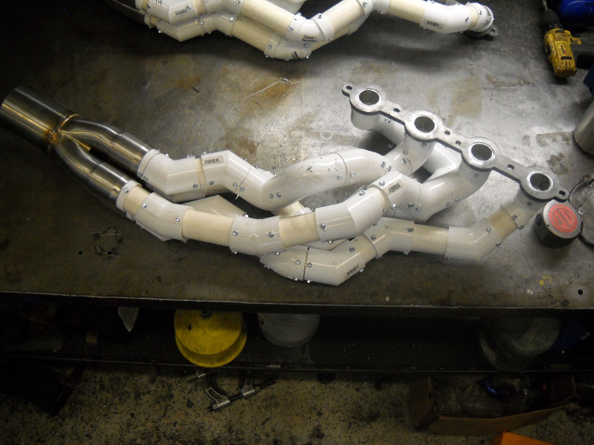

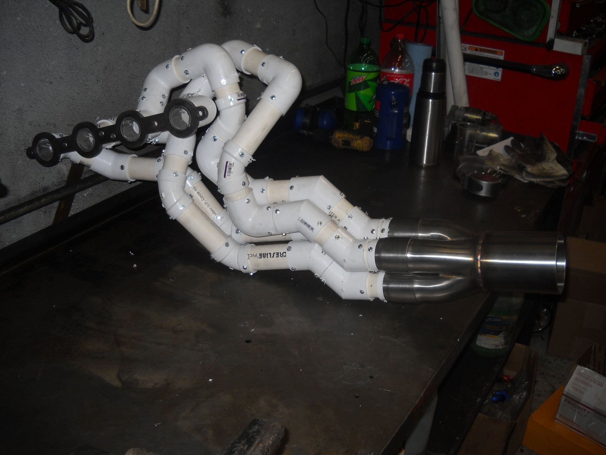

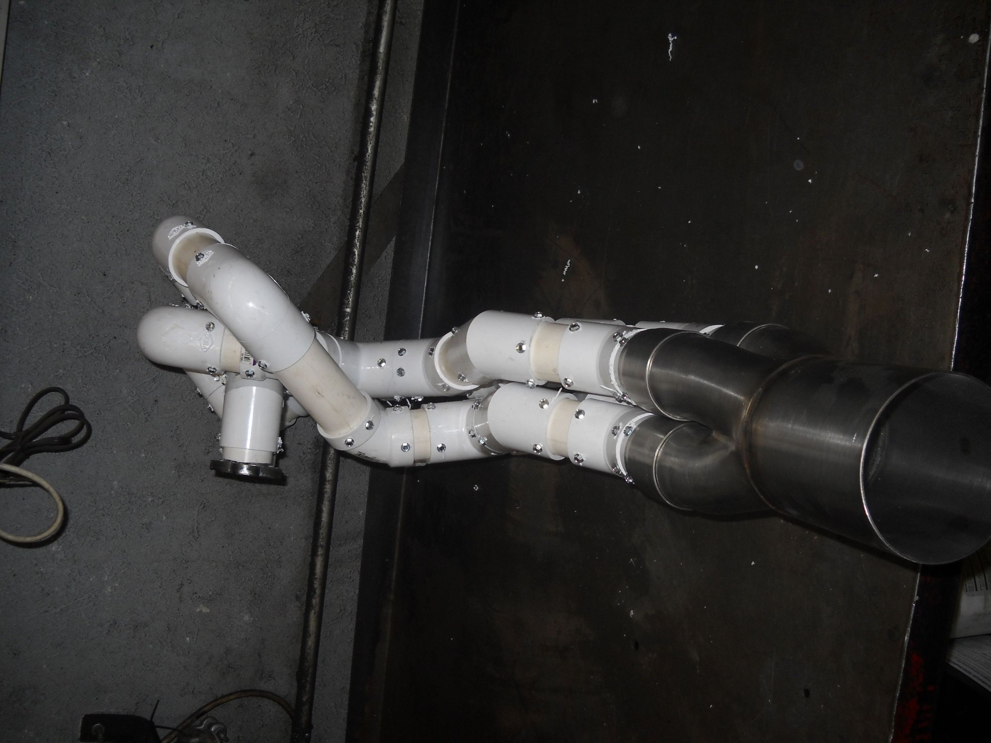

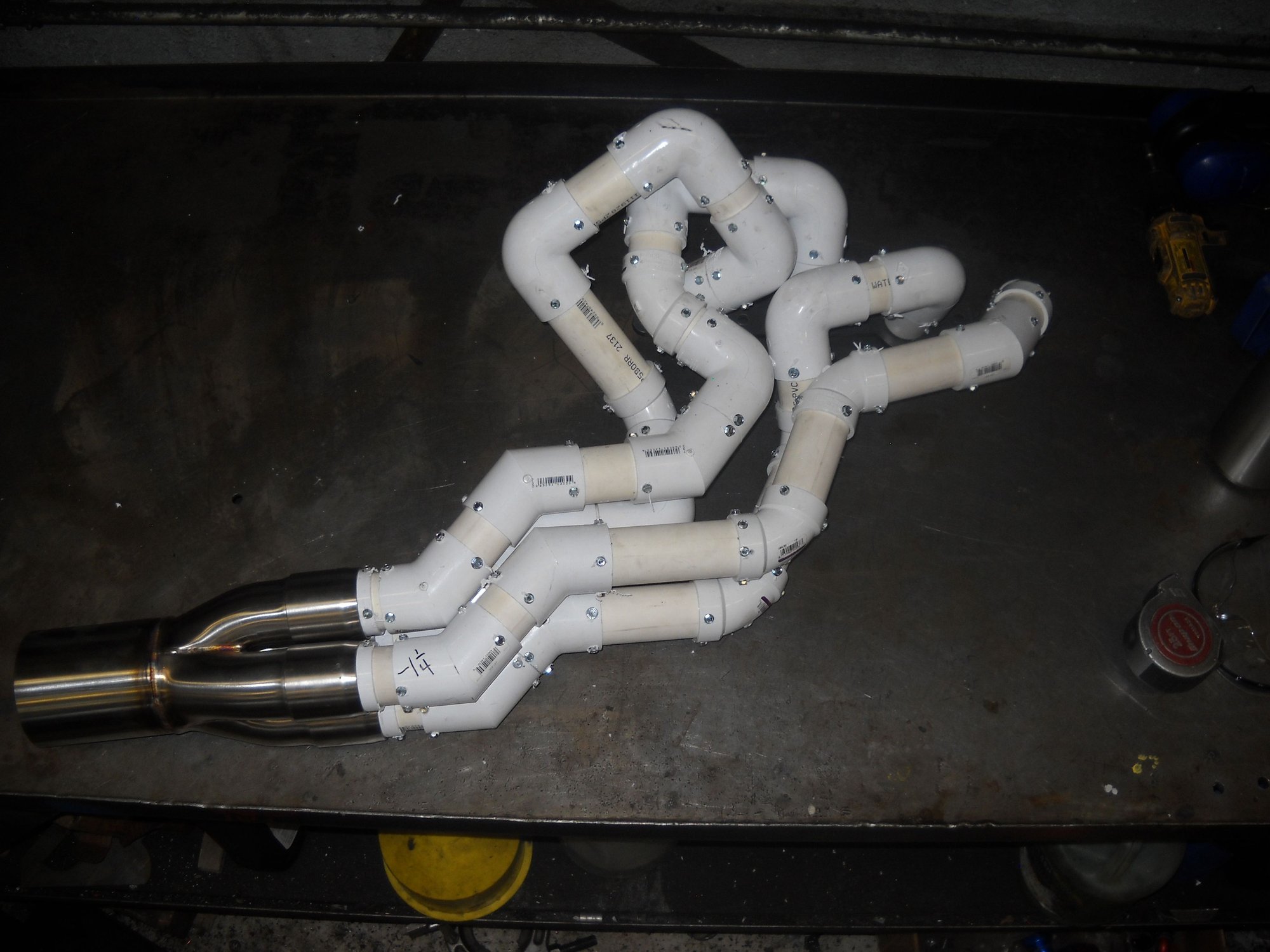

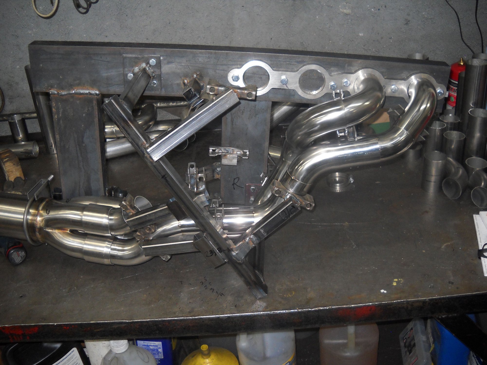

Not quite sure if you are asking me how much the PVC mock cost (not really very much) - or the actual cost in total to do the custom headers or are you asking me how much this build is going to cost me (a lot of $$'s)??
I did notice you's got a kick out of my header patterns that were PVC -needless to say it is an excellent way to mock up the headers - if you don't like the way one way looks or you can't get equal lengths for each cylinder - you can always take them apart and try another angle in just a matter of minutes ( and if you are paying the tech by the hour - minutes is a whole lot less expensive than hours) - works real well. My builder just told me he's got them together now and it only took about 200+ screws - now to make the real thing. - the car will go out to California with the mock up more than likely - couldn't get the finish product done in time anyway. Pictures to follow soon.

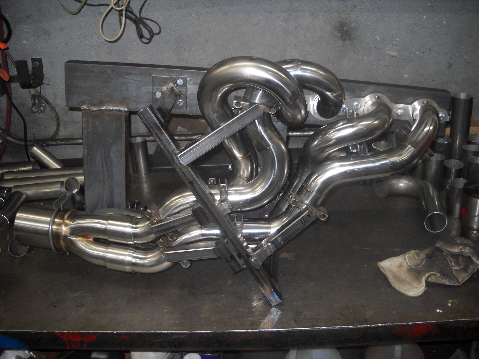

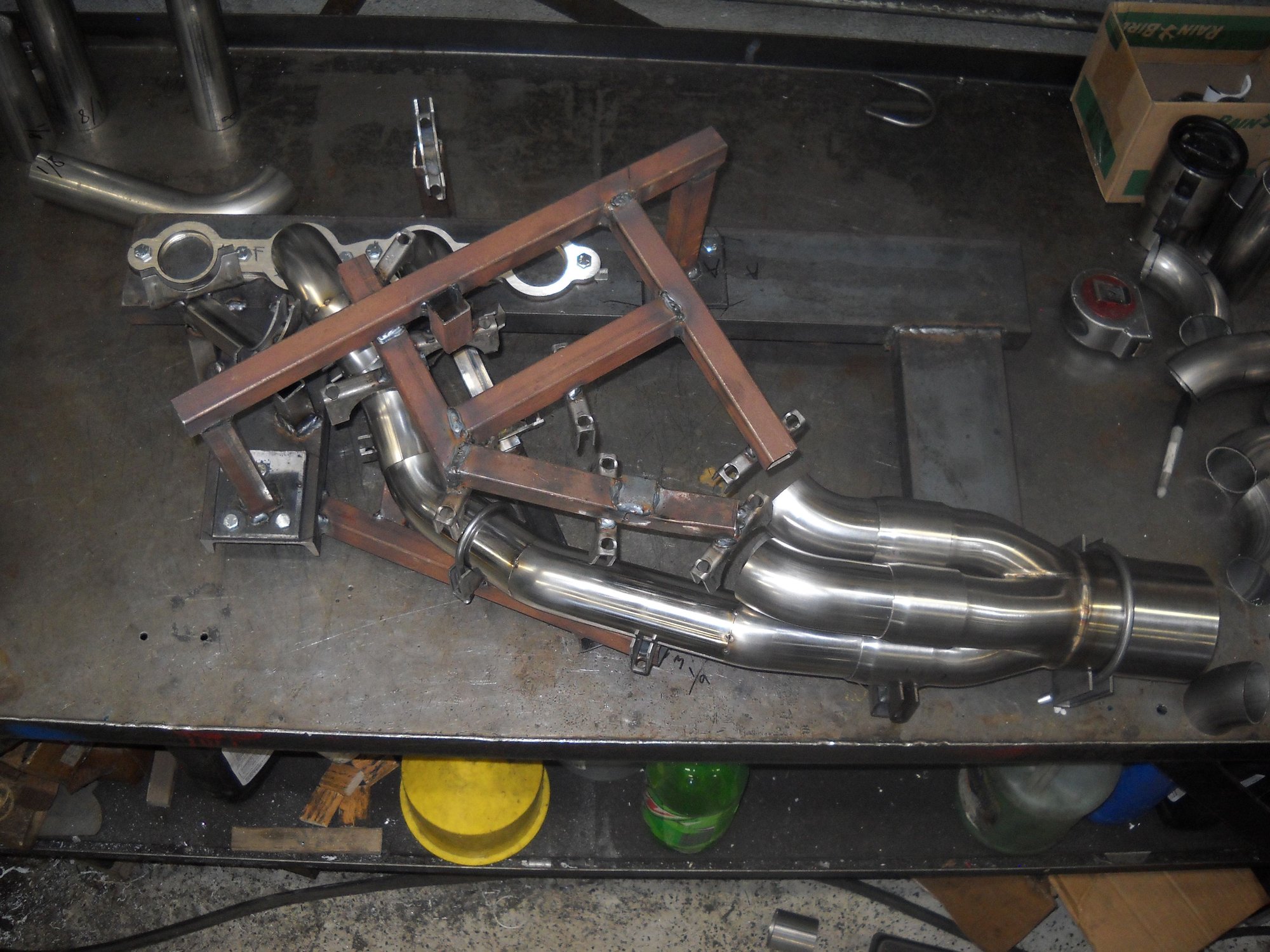

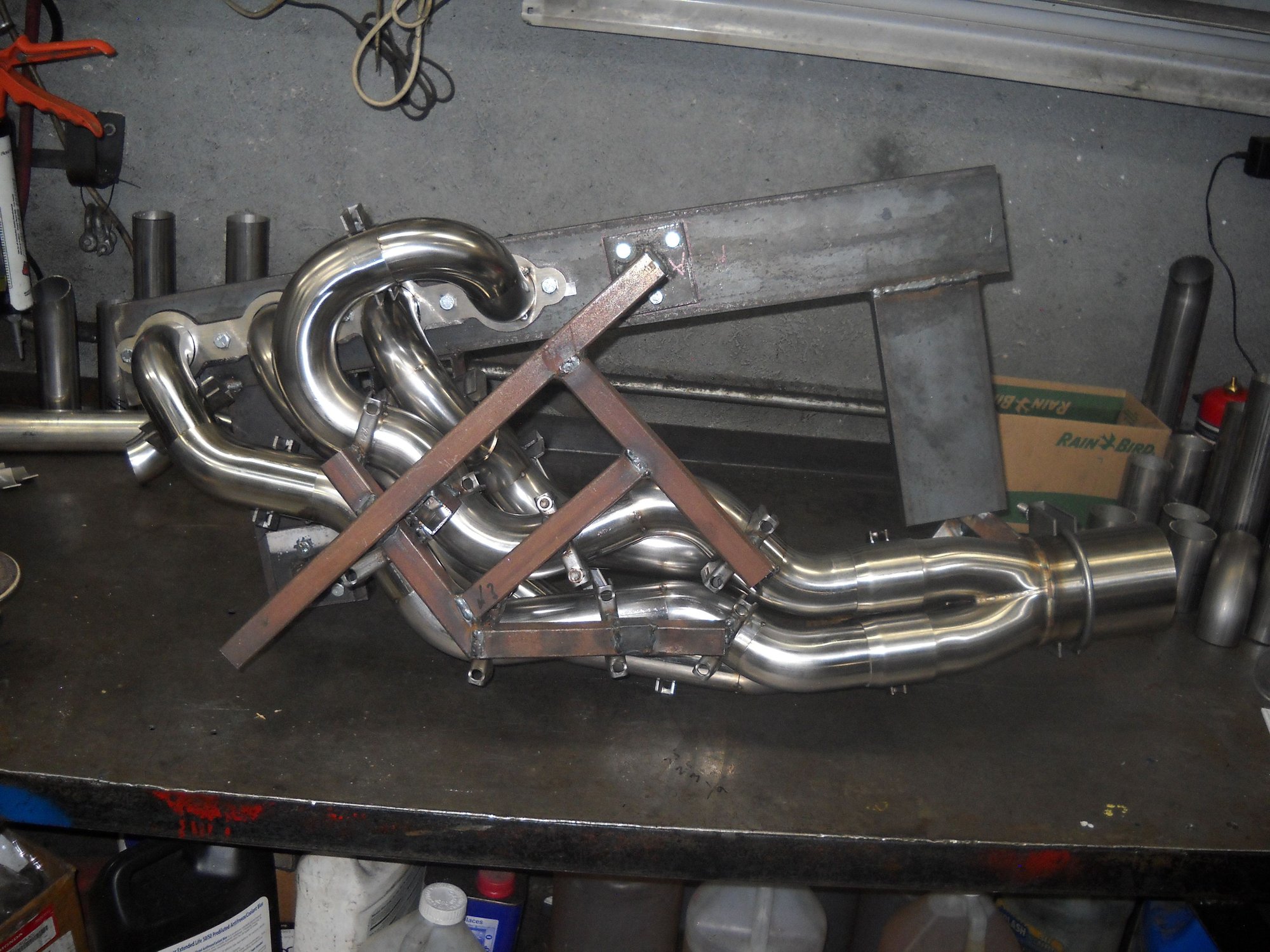

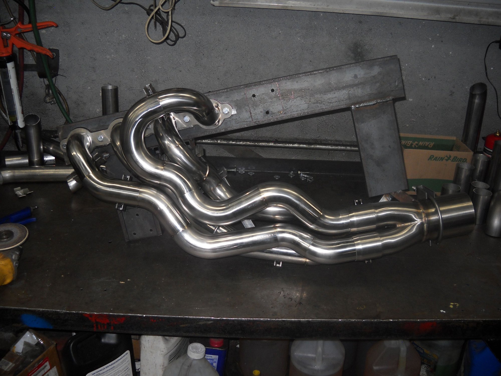

Default Header pattern - next step - complete in Stainless
This is what headers will look like when done in Stainless

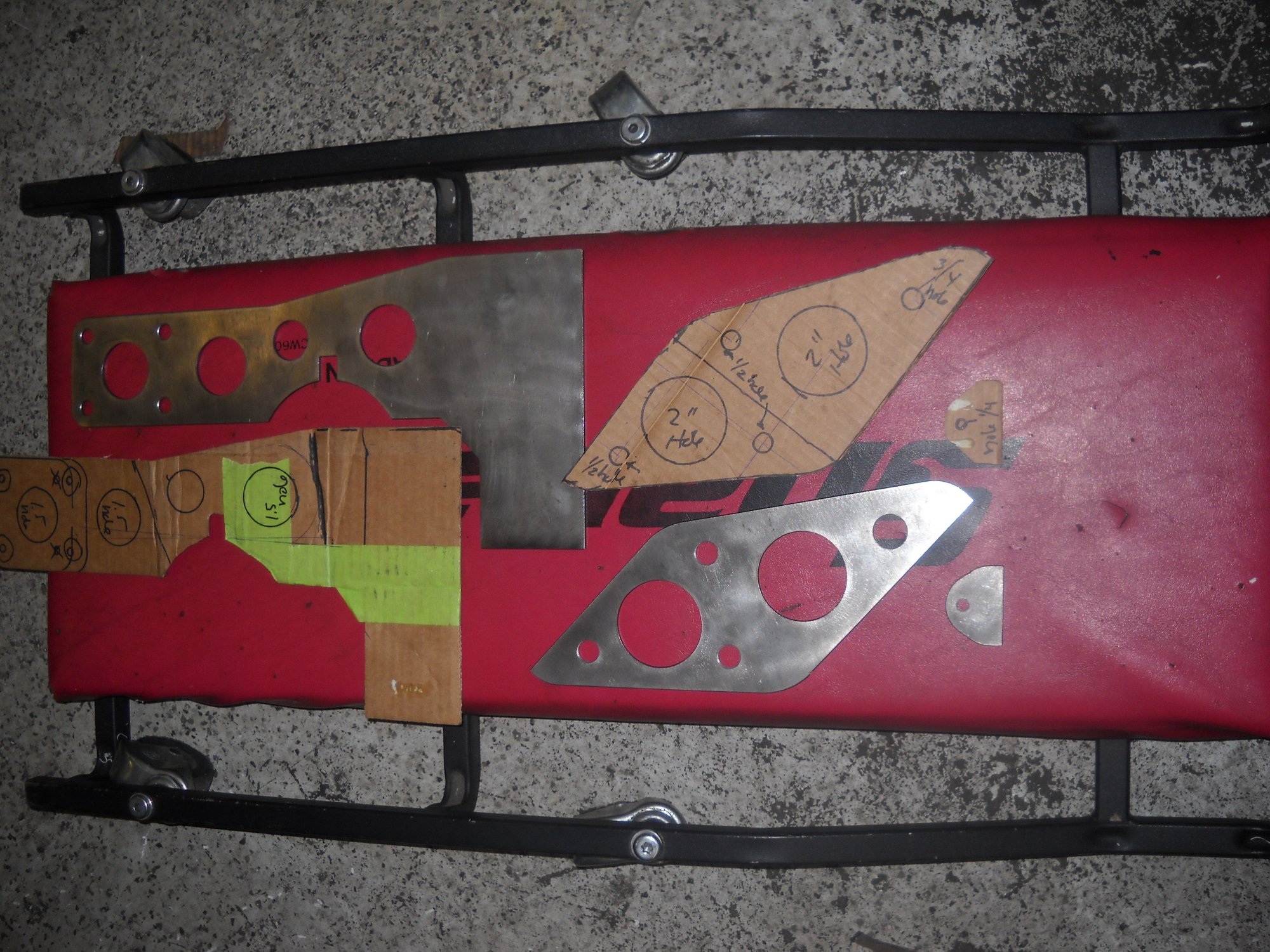

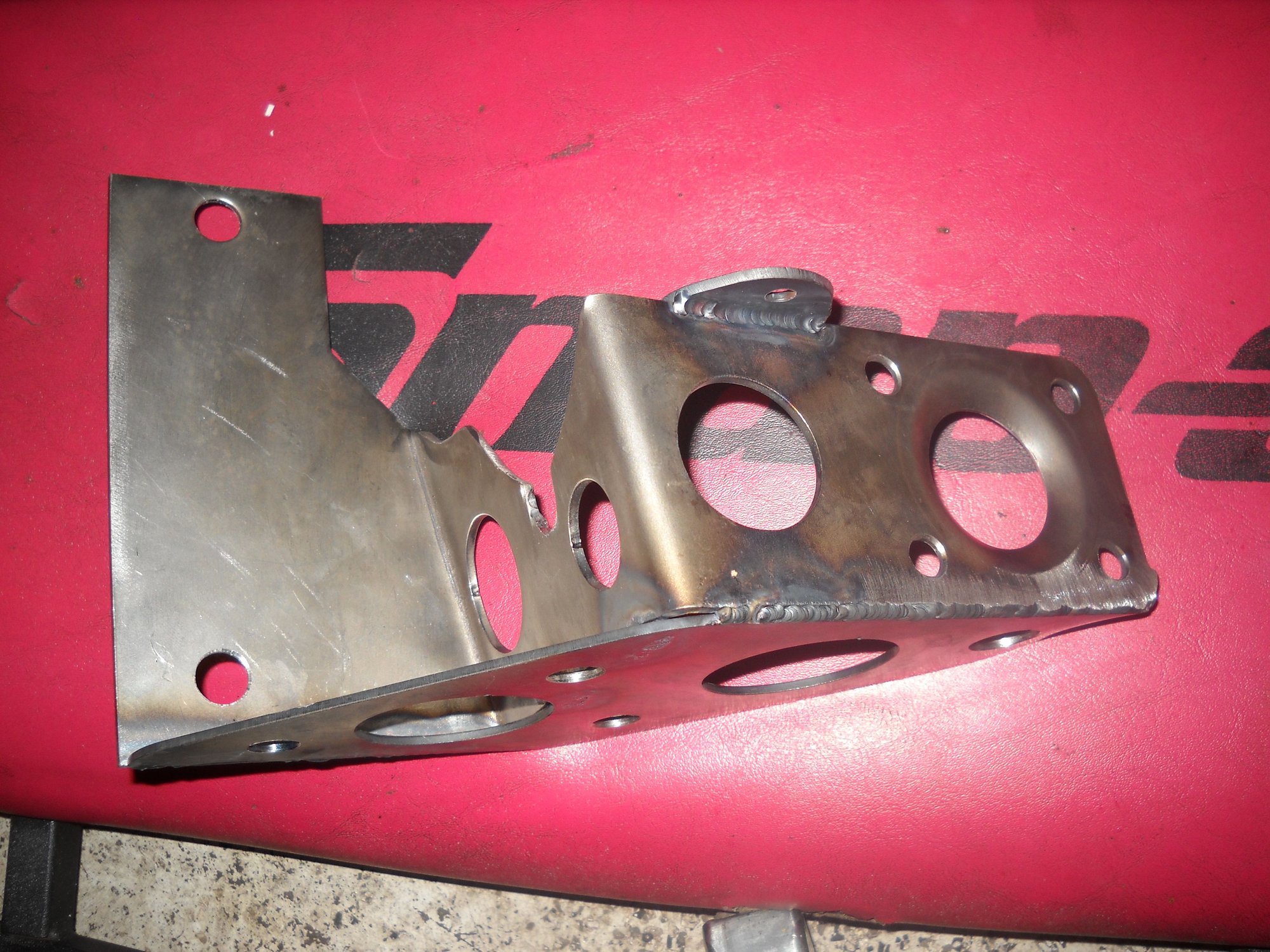

Default more pix

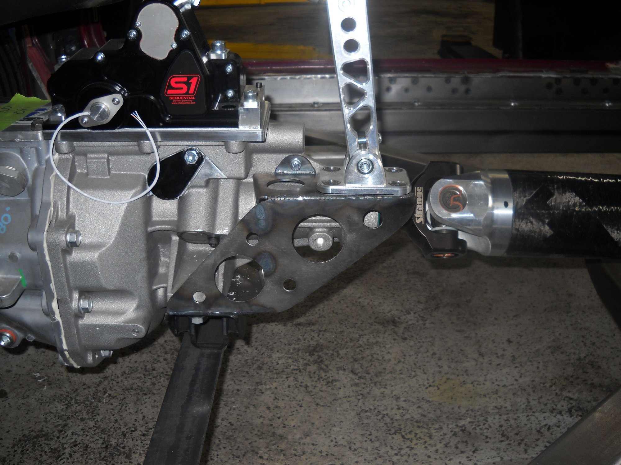

Default more shifter pix
more

That transmission sure takes up some room in the floor.

When debating on whether or not to use an automatic or a 6 speed - one of the very reasons I decided to use the manual was because it is slightly smaller and would fit somewhat better - tight as it is. The route to go with the automatic with the power I am anticipating was a 2 speed powerglide - but after all my due diligence - it would have been a miserable option for something driven on the street such as I want too.

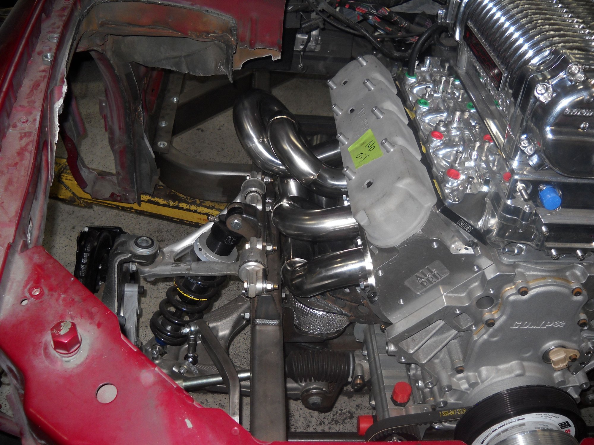

Default Ssv2

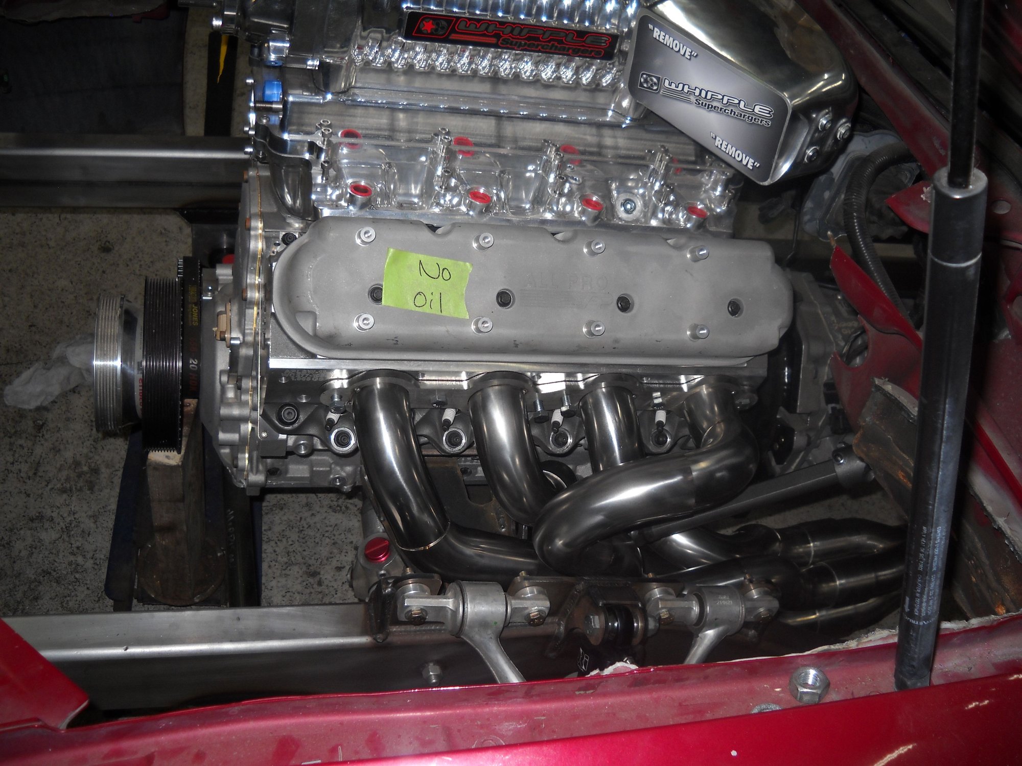

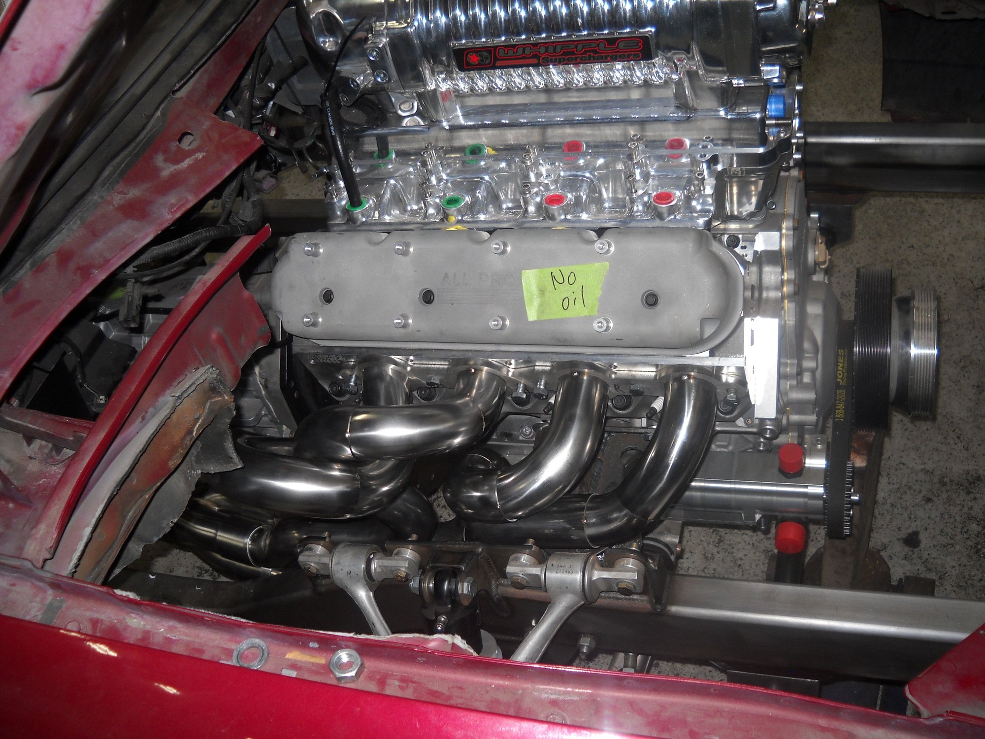

Made it to California today - for all the sheet metal work & cage should be back at the shop in 6 weeks - As you can see now in the picture - this is truly a real rear drive car. - This photo was taken from a
phone looks a bit better if you enlarge it.

Default Completed Headers before California
