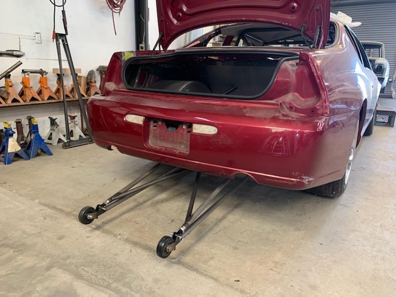

Default Wheelie bars

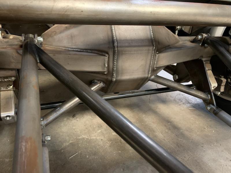

Well, the word overkill comes to mind. They certainly aren't going to bend. Where is the chute mount? Will it go over the top of the X on the wheelie bars and under the bumper? Going to be tight. I would put a smaller X at the rear and put the bracket in the center of the rear end to keep the chute low.
See how the X is at the rear and bottom? Chute lines can go over the top.
