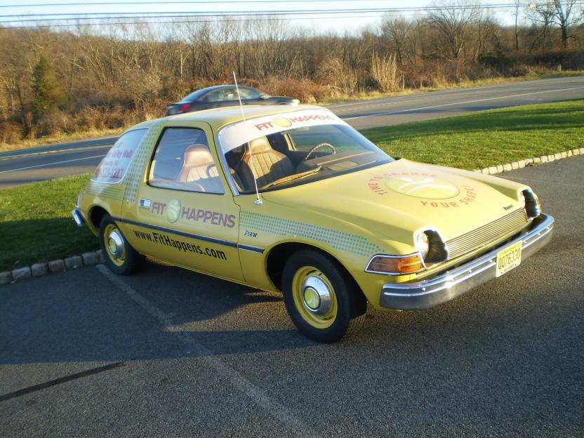

look into getting the paint from eather a mack truck dealership or tractor supply co. idk about in minnesota but out here we get ours from a mack dealership in NJ, good quality dupont paint, and a gallon costs about as much as a quart would from anywhere else. tractor supply co i have heard has great paint (forget the brand) for even cheaper than the mack dealership.
also, silver is a pain to get it to lay down right so i would avoid that, and if you do black make sure the body is super smooth, because it shows every imperfection. ( whoever did my buick's 1/4 panels must have not known that, you can see every spot of bondo on that car )
i'll try to add as i remember some of the other stuff my dad told me while we were doing his boss's pacer. we painted that one in a dusty, dirt lot next to my dad's shop, and it turned out pretty nice. never even laid a coat of clear on it!
