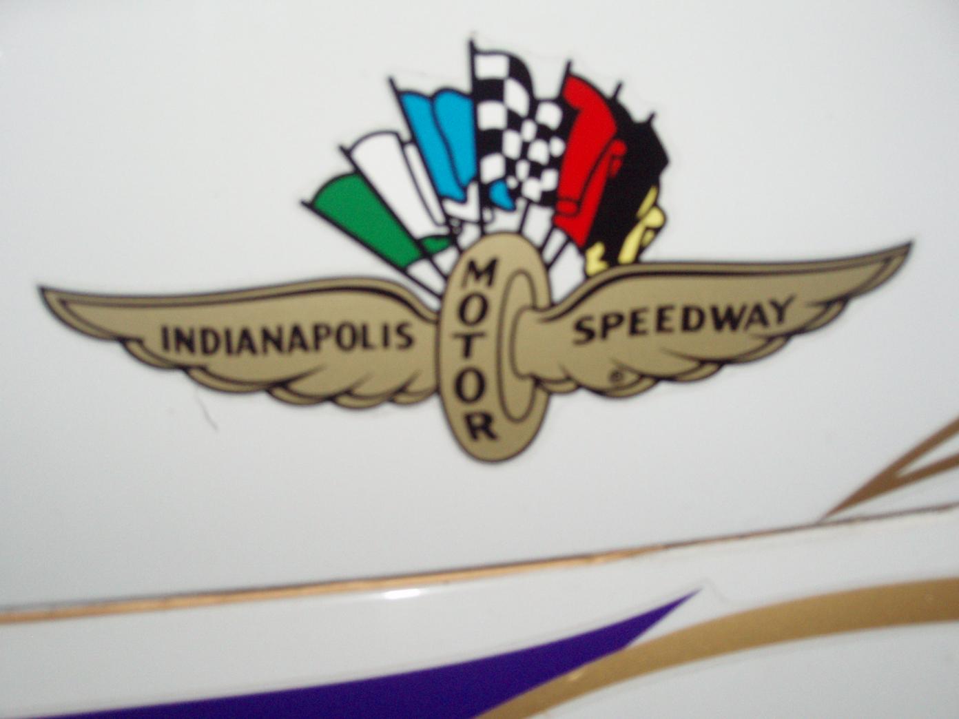

I decided with the rust on the window framing and on the trunk. I bought a junker. Blown head gasket. I'm piecing it out and selling it back to the yard. Funny how some things work. As I was pulling off the trunk lid, it got crooked. I fought it back and through a doubled up moving pad, The corner dropped ever so slightly on the bottom corner of the rear wind shield. After an hour of clean up and pulling the molding. I discovered a rust spot develpoing under were the seal was. Nothing dramatic now. In a year it could have been trouble. So now I'm replacing a trunk lid, 2 rear windows and framing. Grinding out the rust spot and repainting the whole roof and B pillars. Now I also have to replace the Indy decals. No luck so far finding them. Picture 1: is the 2decals that will need to be replaced. Picture 2: A look at the hole in the trunk lid. It's a little worse than it appears here. Pictuer 3: is the window framing I need to pull and replace
