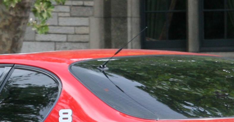

whats it even look like to begin with? i dont have onstar =p
Old Sep 7, 2009 | 11:07 AM
Looks like a cell phone antenna. Check out the attached pic.
I took mine off last year. I didn't want to use a metal screwdriver and cause any potential damage to the window. So I waited until a hot day last summer, then used a plastic scraper used for spreading body filler.
Once you get it started, grab underneath it with your fingers and it'll peel off pretty nice.
I too left the inside part alone. You can't really see it, and I didn't want to risk screwing up my defogger lines.
