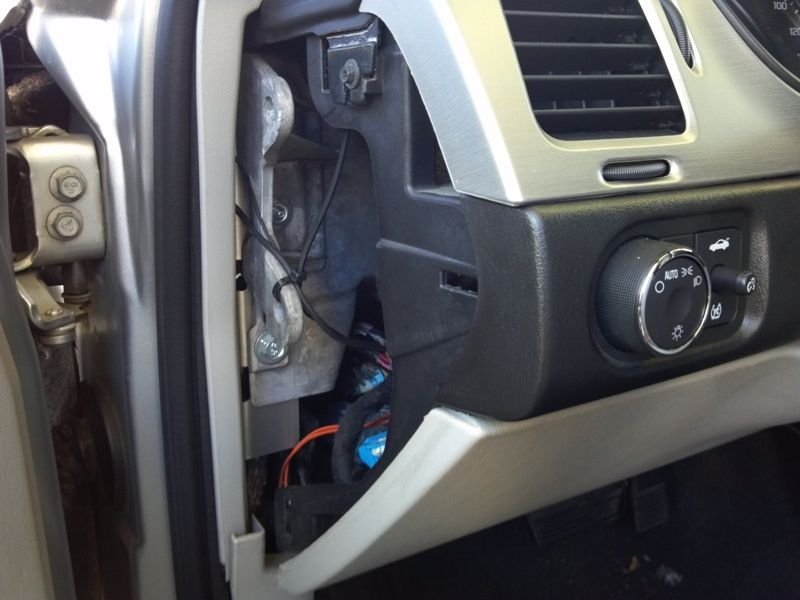

I don't want to be a victim again (Firebird window smashed for change in the cupholder, iPod in the console) so I first decided to disconnect the dash button to at least protect what is in the back. First idea was to hide a switch that would disable the dash button, second was to just run the control wire to the hidden switch.
Here's the project:
Get a switch. Need a momentary contact single pole single throw one. The kind that closes when pushed and opens when released. Style can be special to your needs, a rocker or toggle would be ok in some places, a button in others. My chosen style mimics the plastic fasteners that attach the knee-panel.
Gain access to behind the dash.
You can wiggle the plug off of the light/traction/trunk control or take the dash apart more and bring the switch out into the open,

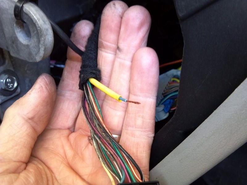

Need to find the one wire that is connected to the trunk release and snip it. Cut it at lease 2 inches from the plug so you can mend the mod back to stock.
On my '06 LT with no auxiliary lights it is that blue wire. If all you want is disable the release you can tape or heat shrink the end and be done.
In my mod I soldered a length of wire to the harness end and extended it to my super secret switch location.
Connect the extension to one terminal of your switch and a wire to chassis ground to the other terminal,
Test your wiring, secure your switch and put parts back together and you are done.
