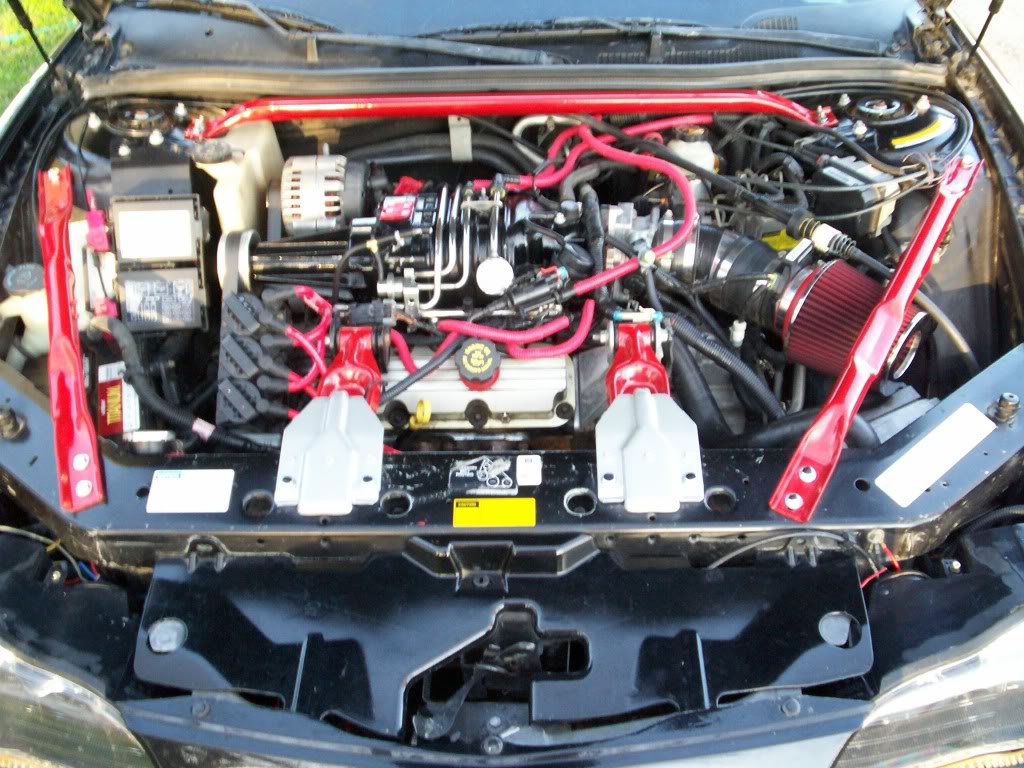

Originally Posted by iMuf
The support bars I'm talking about are under the hood of the car. Like when you pop open the hood the 2 bars on either side that go from the front of the car back to where the struts are at (hopefully that makes sense). That was just another painting idea I had to help make the engine bay pop a little more. And i haven't decided on if I want to brush them or spray them yet.
I agree with taking the calipers off. Having the brake pads off will make it look 10x better when you are done, but if you have stock 00-03 SS rims you really won't be able to see ti all anyway.
And red bars? Yea, they look alright.
