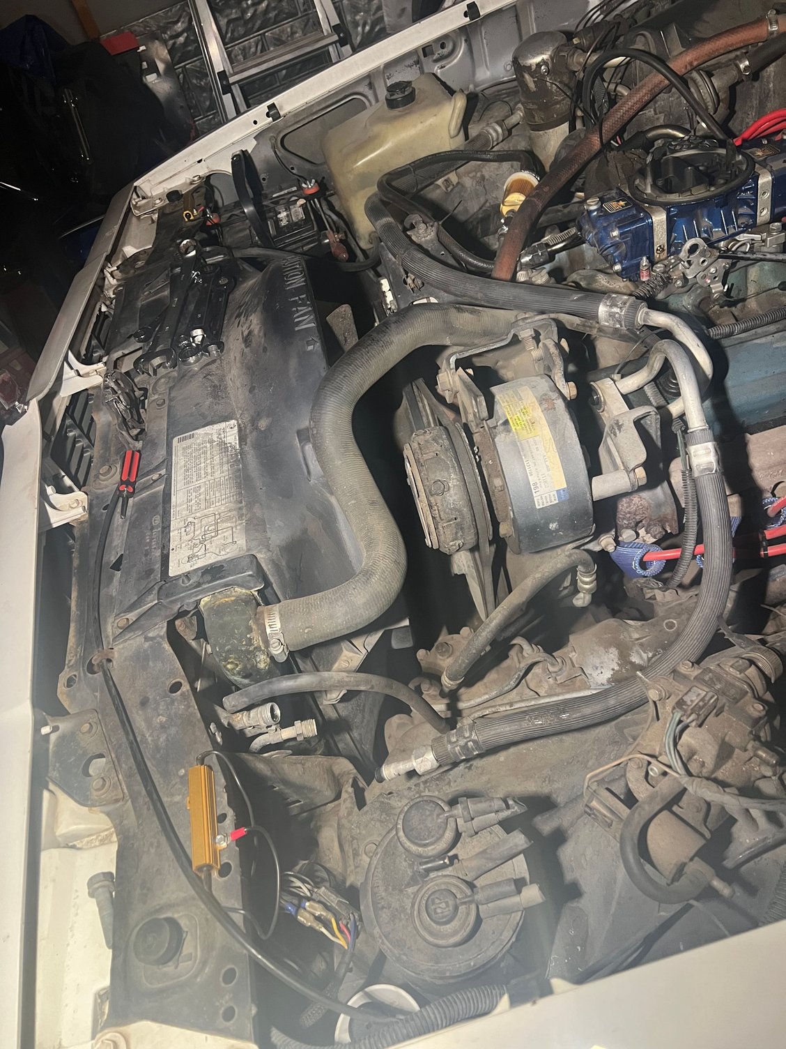

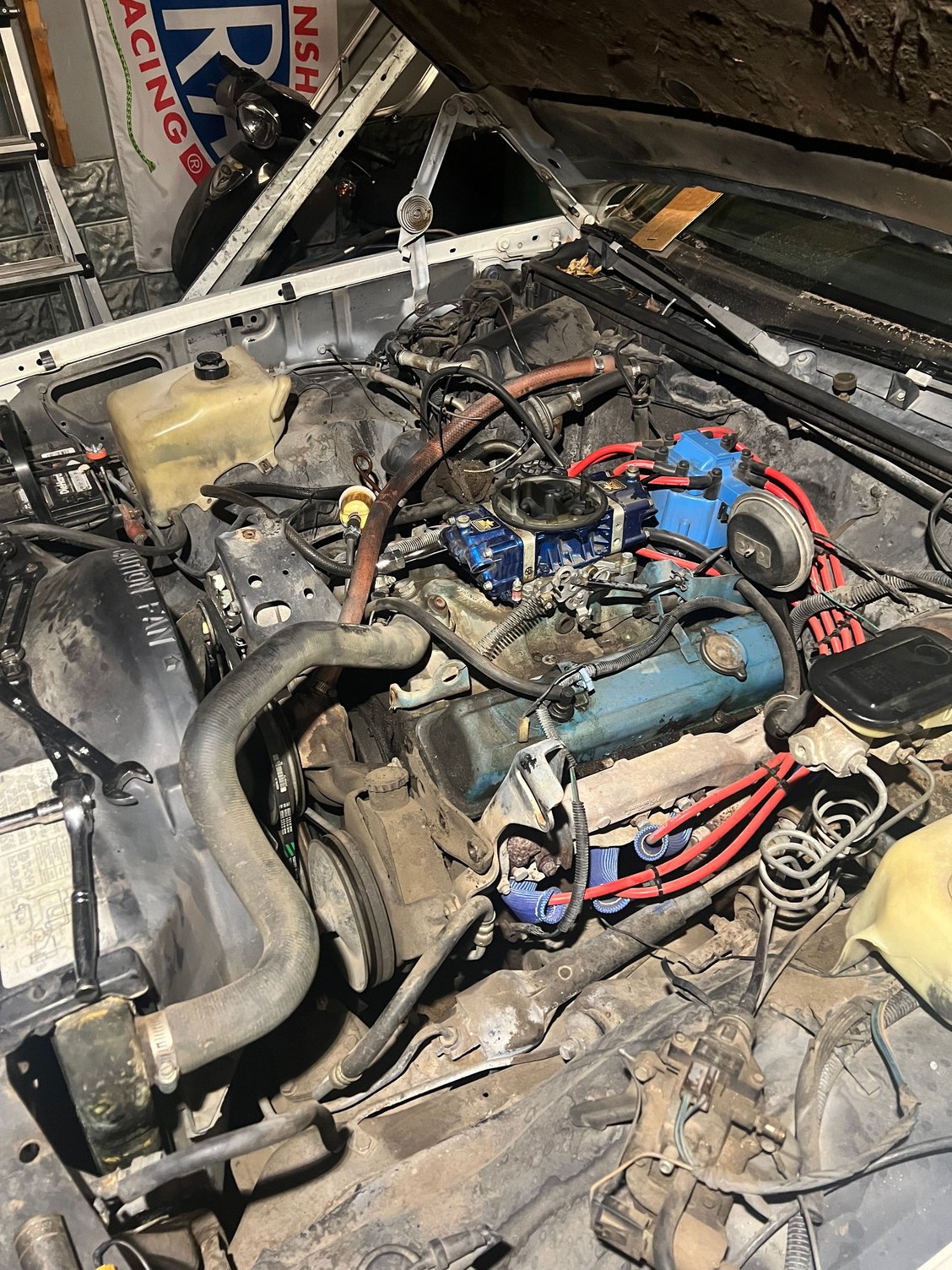

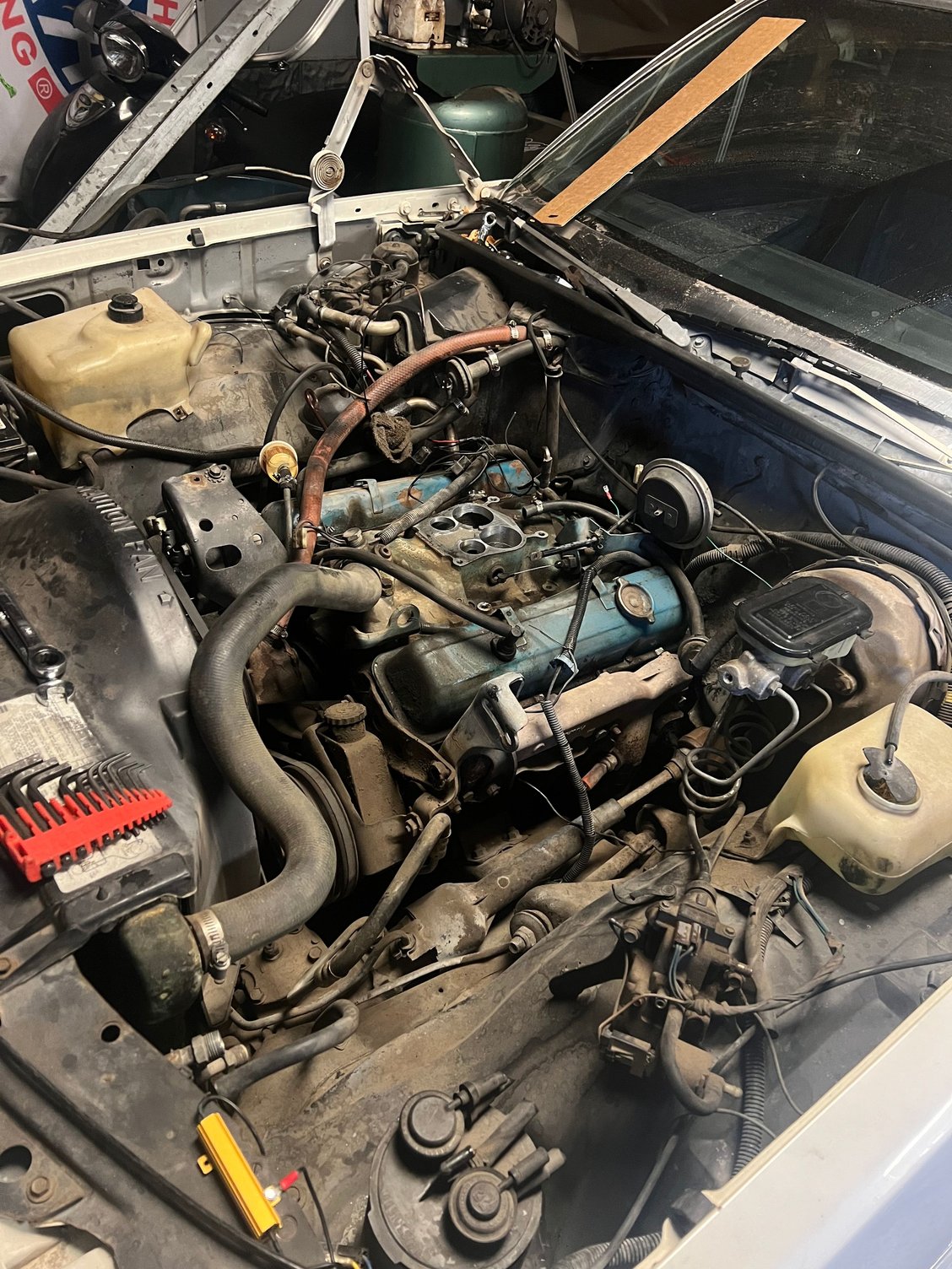

first to go was the a/c stuff hate to see it go but the system leaked. It’s a race car lighter the better right!?!

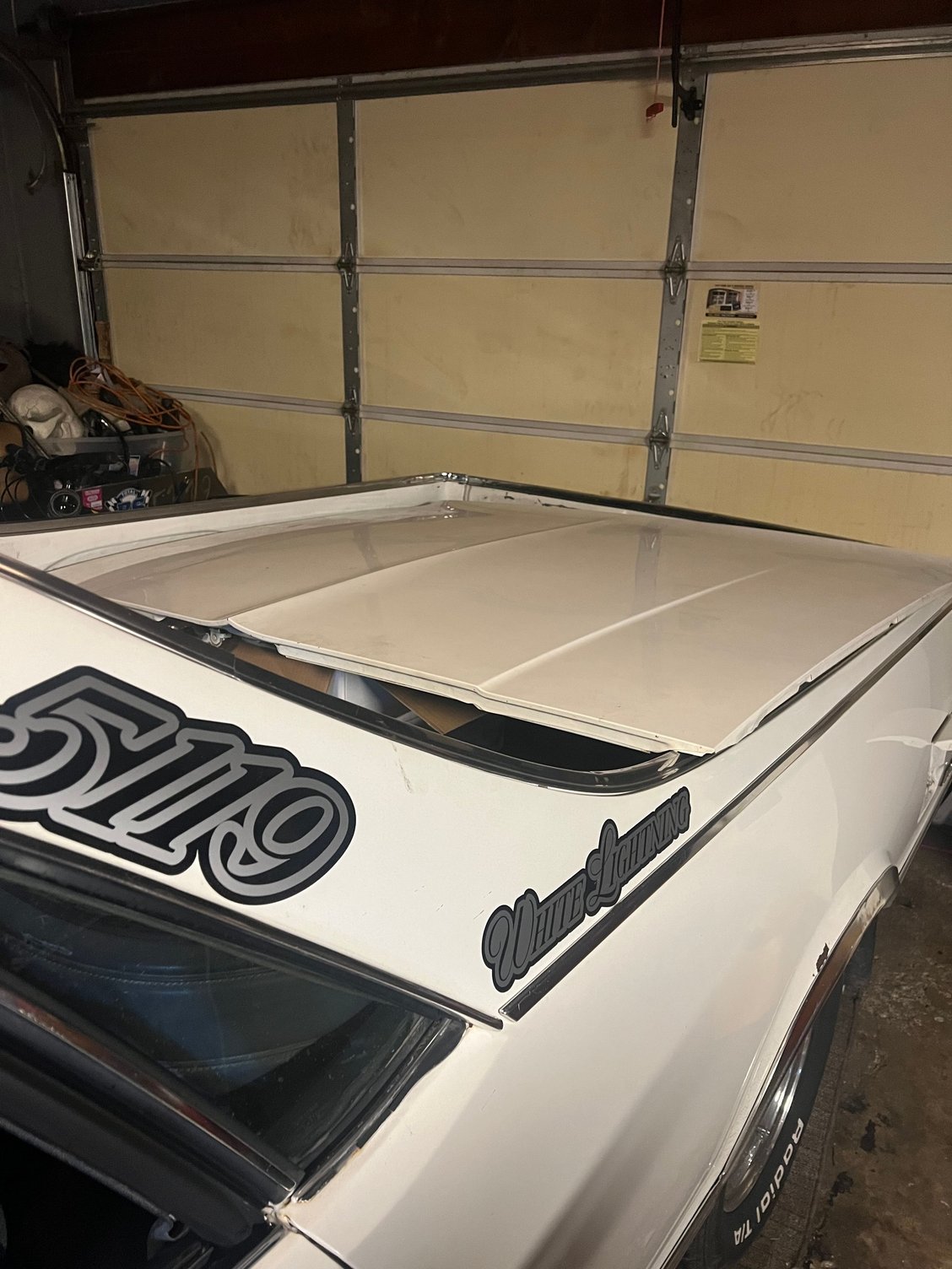

got the kid out there to give me a hand got the hood off and set in the back. Let me tell you I’ll take tossing the hood in the bed over on the roof any day!

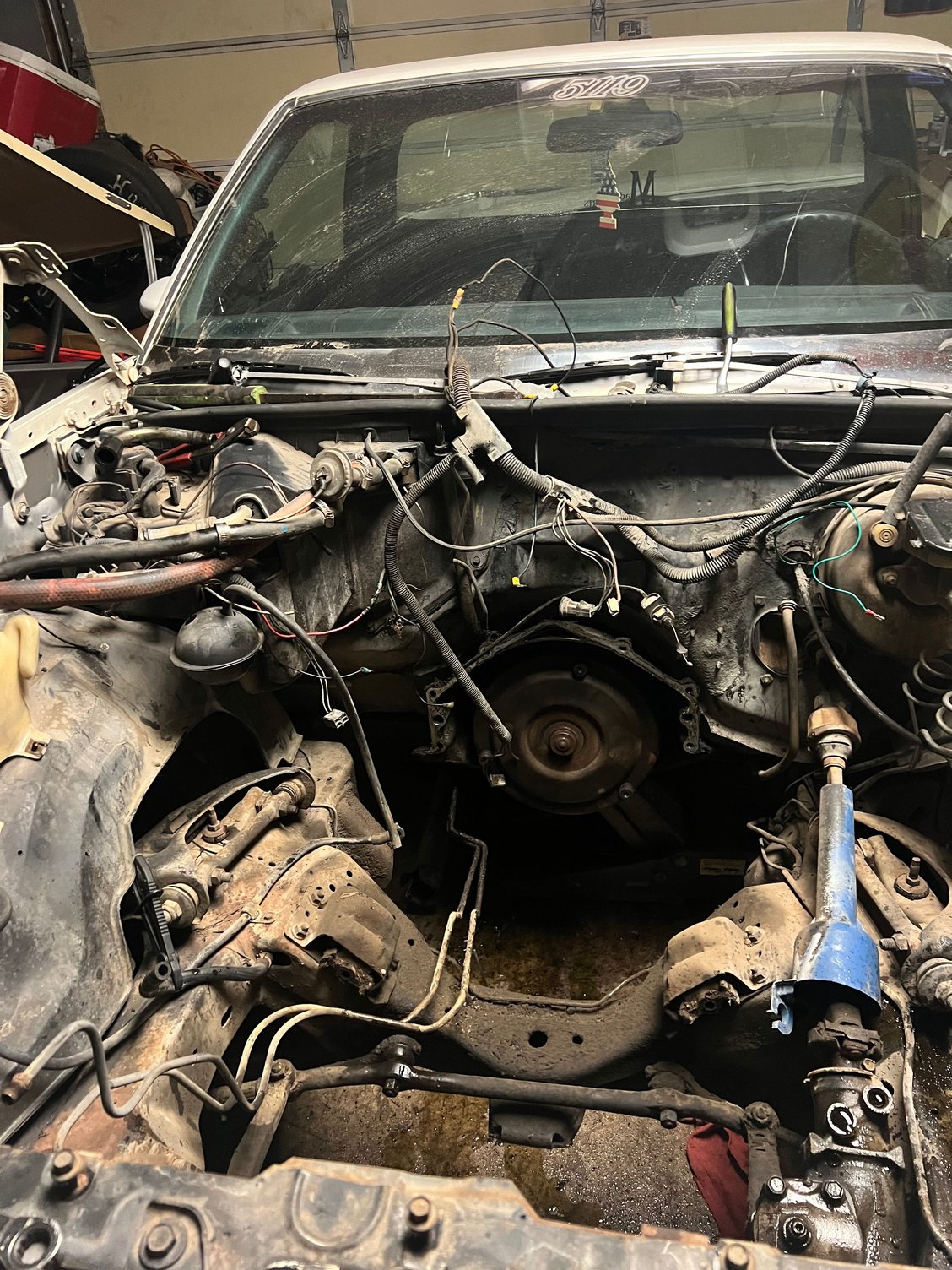

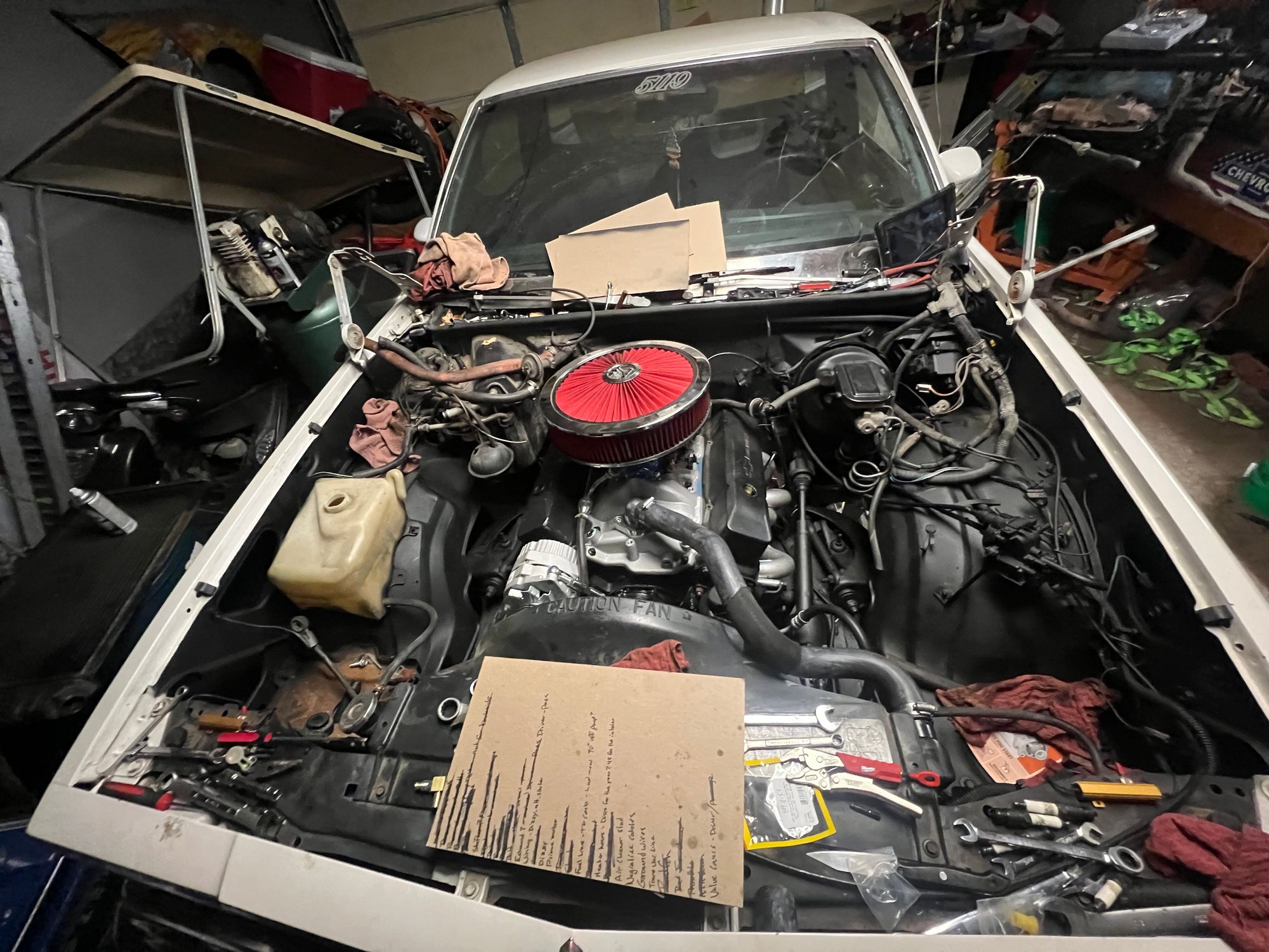

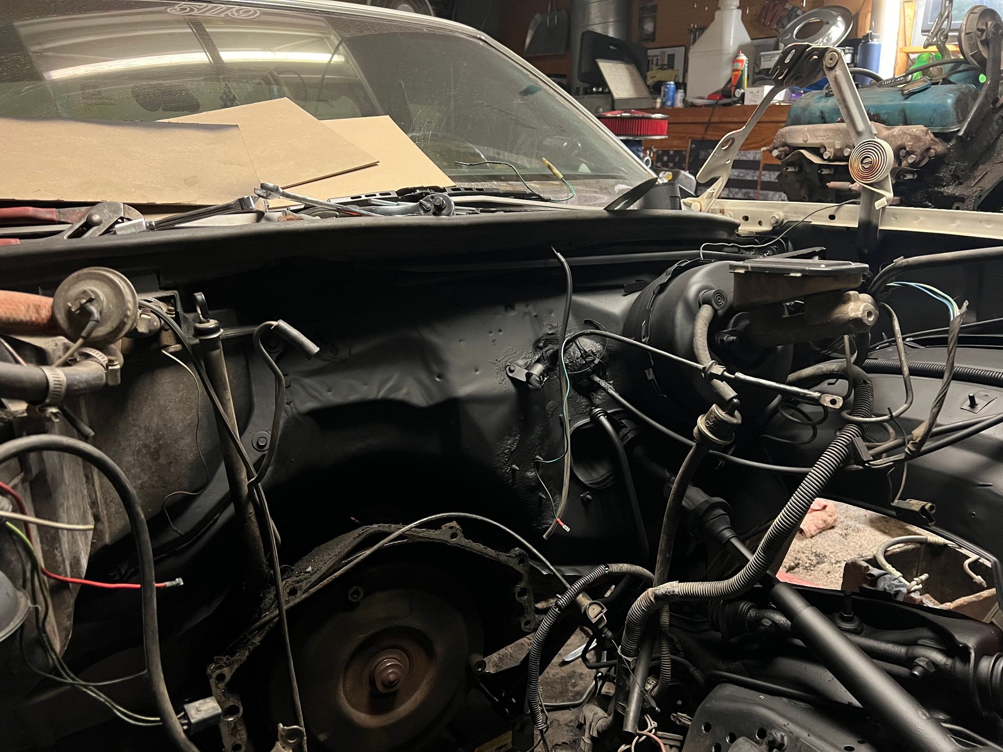

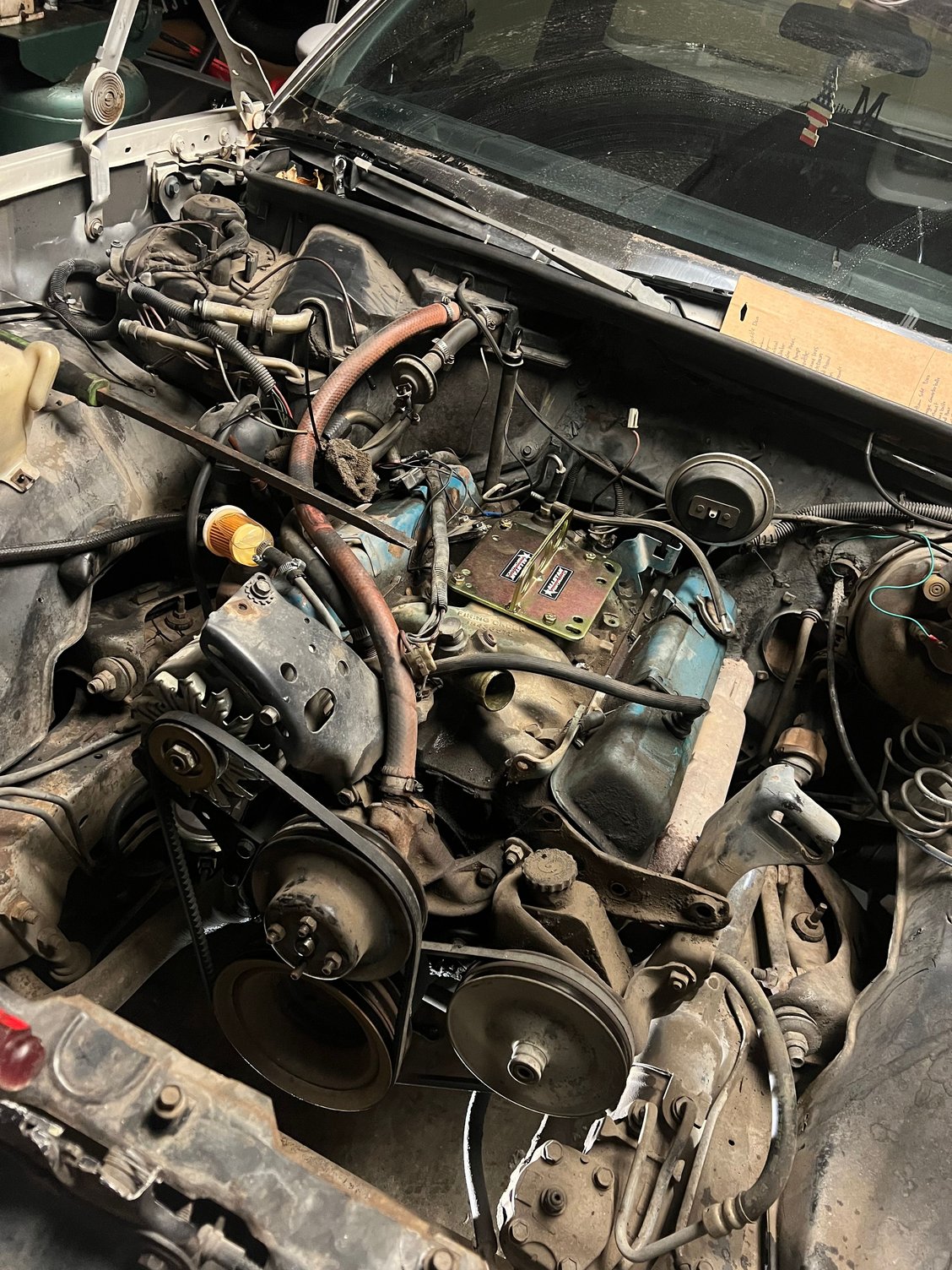

carb,dizzy, started pulling electrical off
My ending point tonight
Converter and trans bolts,power steering, heater hoses, ground strap, motor mount bolts to pull off and I can give it a tug to see what I forgot
I have been blown away in this whole process being from a salt state I am used to rust and things fighting me, snapping bolts, rounded nuts, ect you know the deal.
This has been anything but that I have yet to have to lube, cut, heat, bang on one size smaller socket anything!

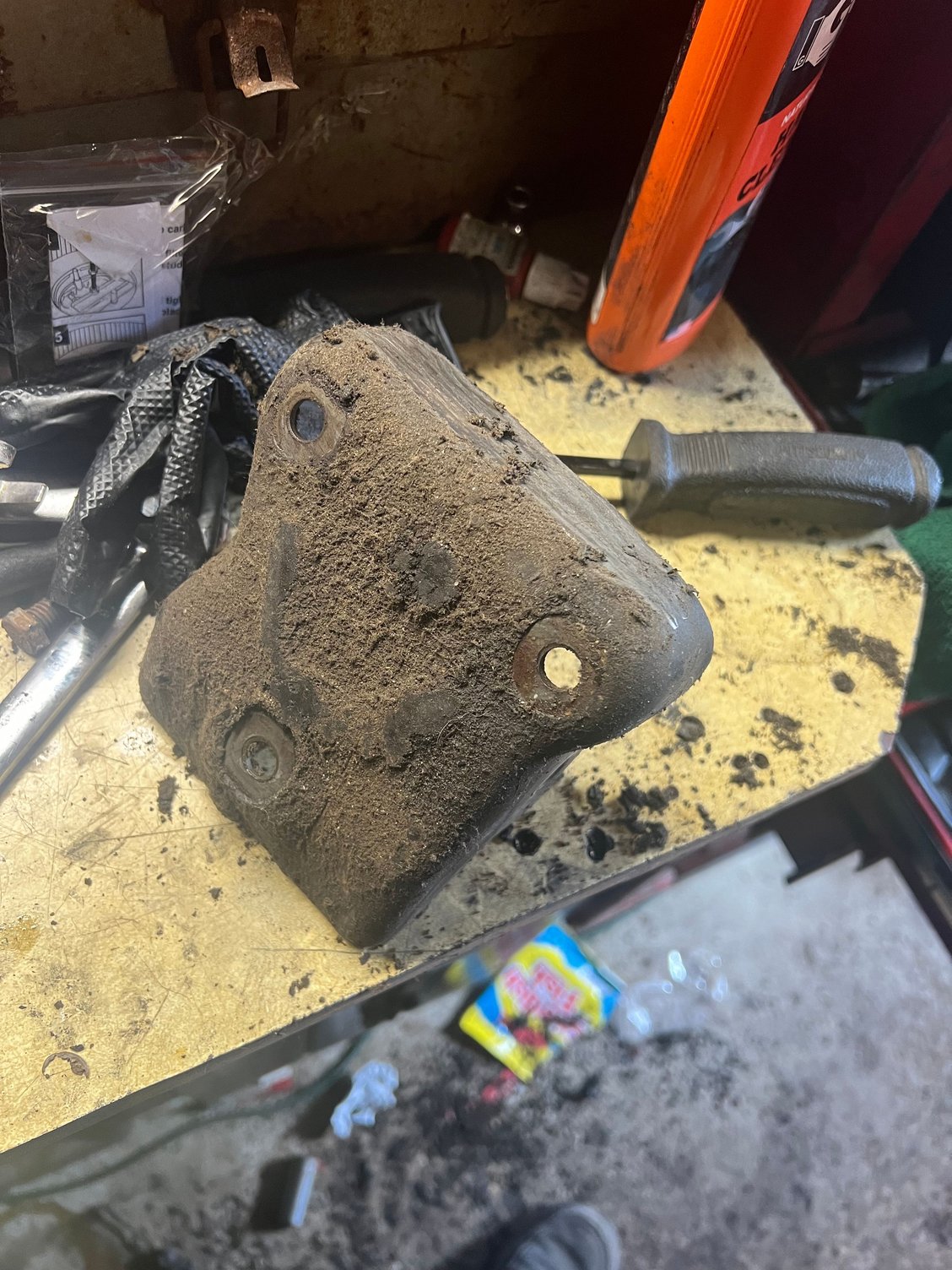

I WAS ABLE TO UNBOLT THE EXHAUST FROM THE MANIFOLD!!! I grabbed my impact and did the ol “well hope the snap off nicely” hit the trigger and off comes the nut, I thought it was a fluke. Didn’t even unscrew the stud from the manifold. I have worked on less mile newer vehicles that came off worse

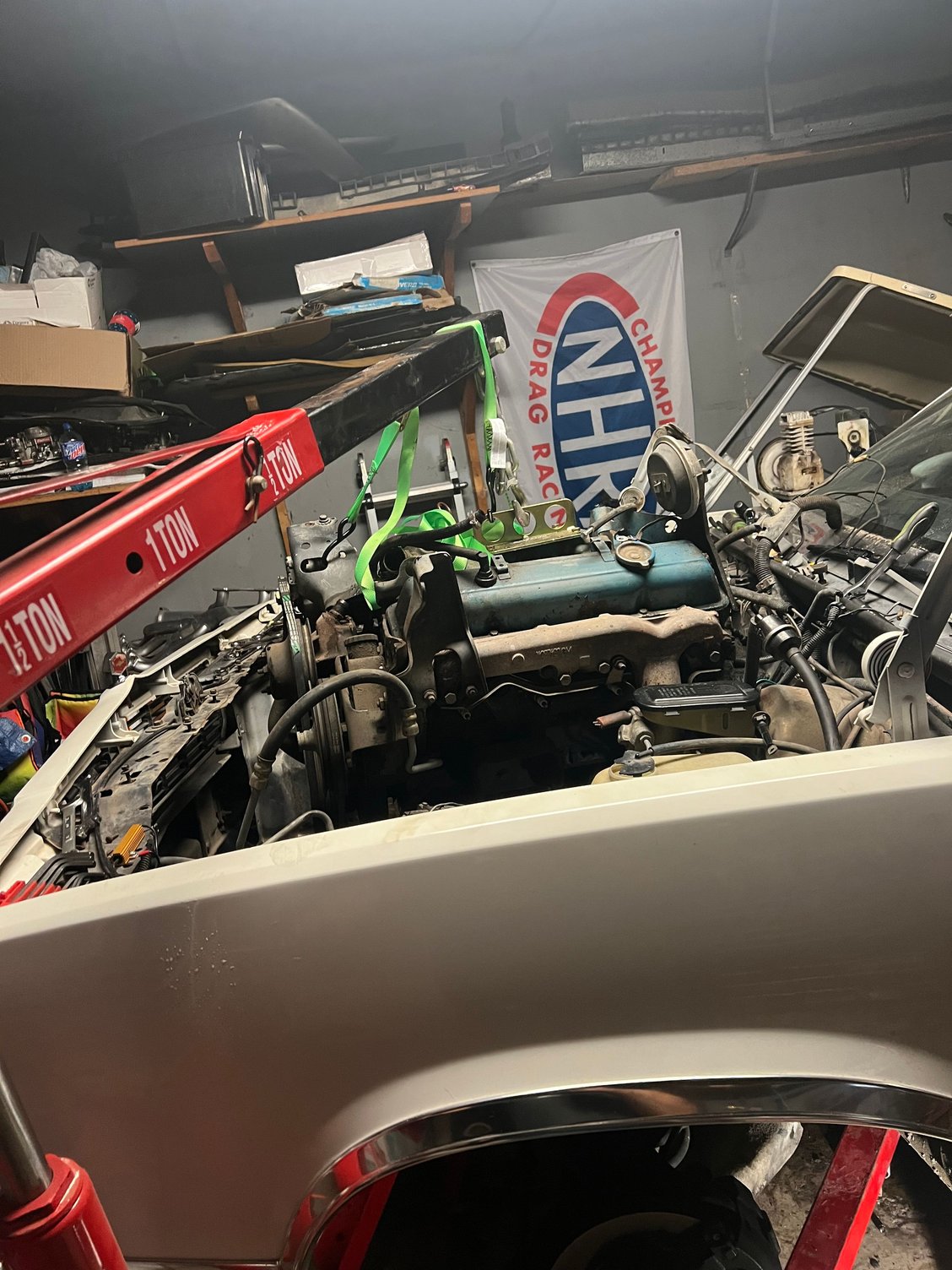

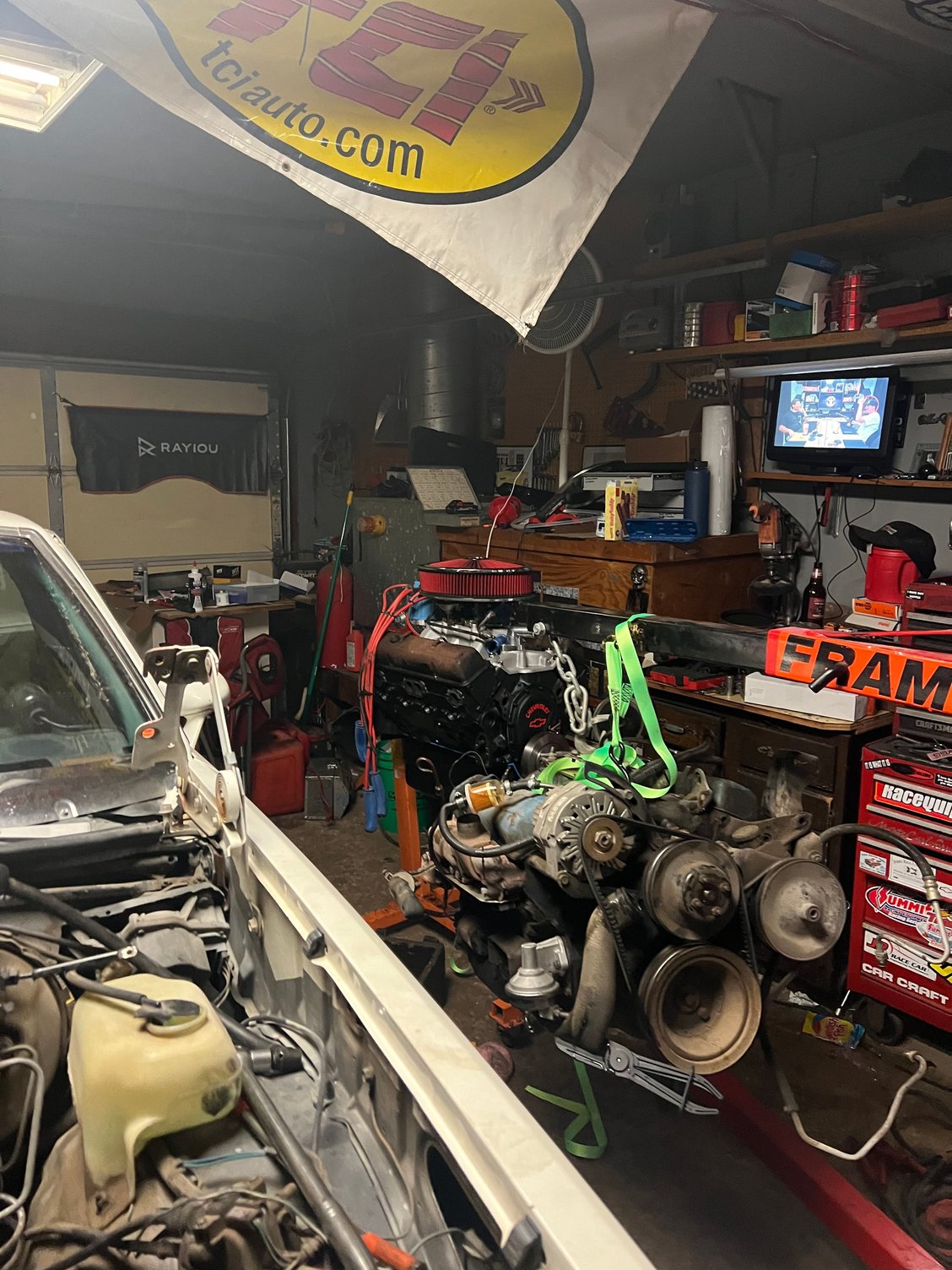

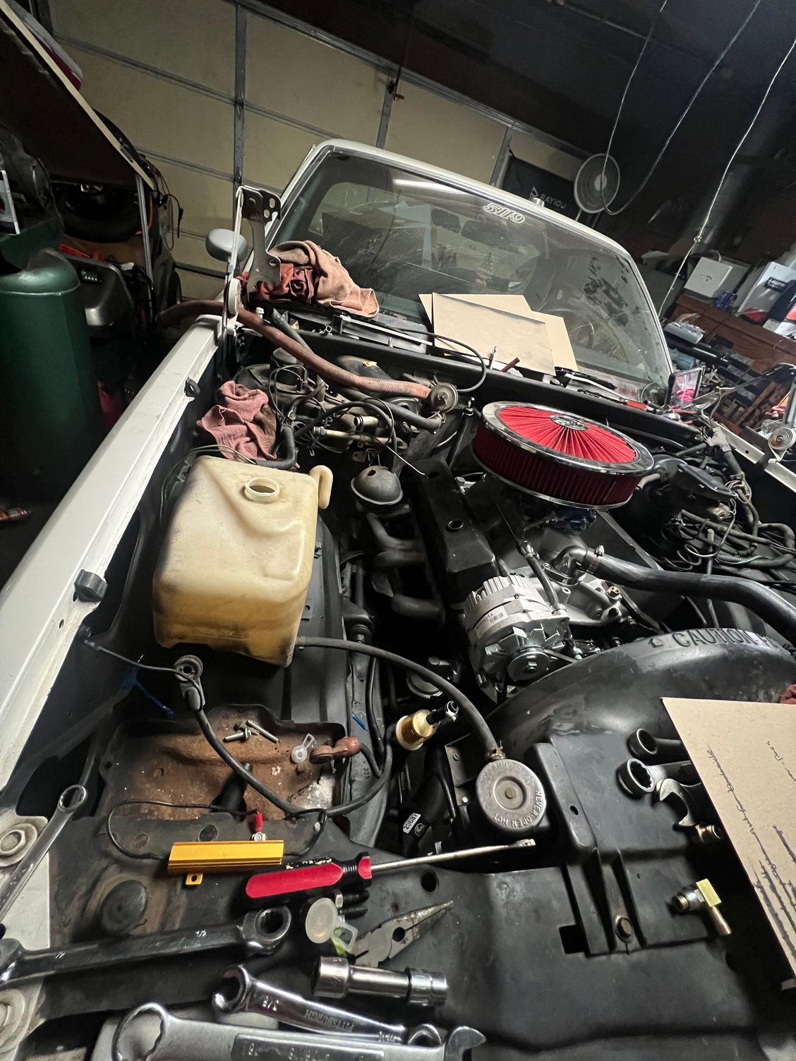

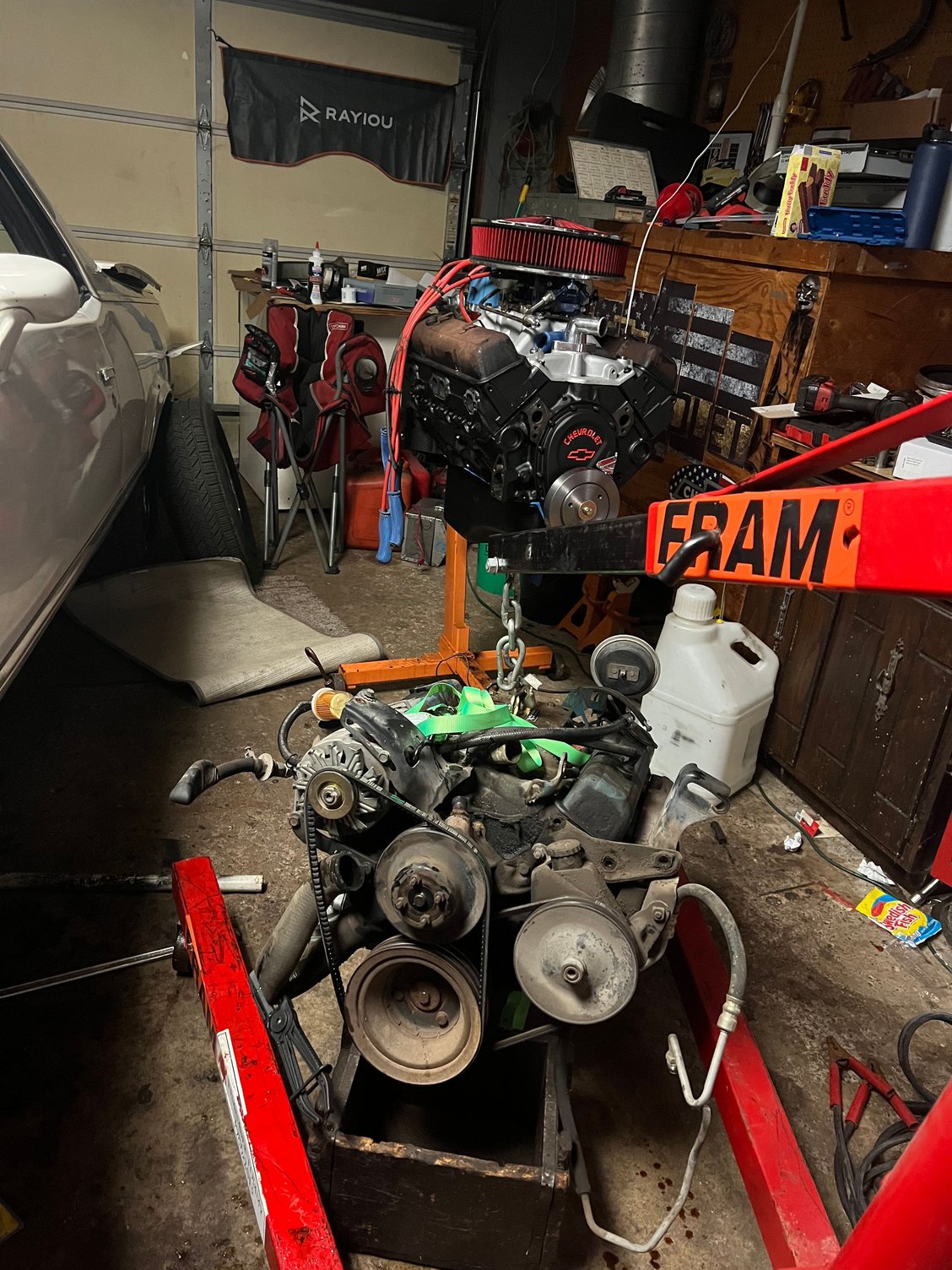

Motor is out! Waiting on some parts to get here before I can toss the 350in will be a great time to do some engine bay clean up and found a couple wires that need attention
feel like a dang bomb went off in the garage but hey forward progress!

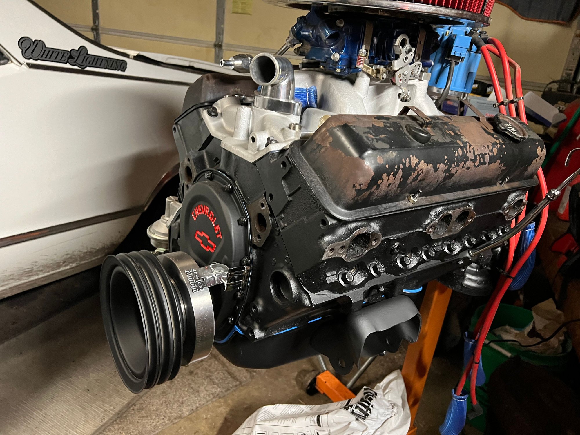

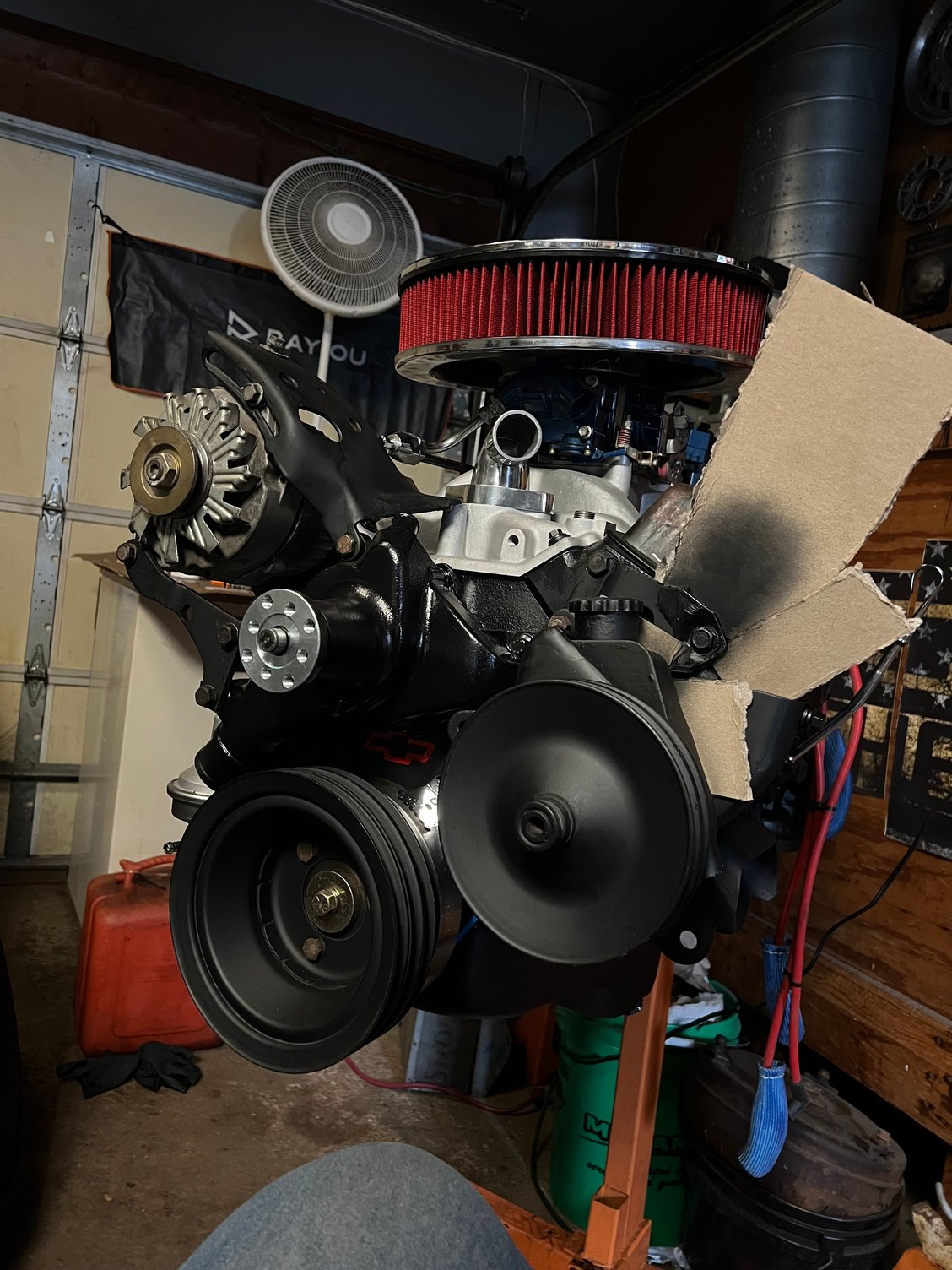

Clean and paint and clean and paint and clean and paint is what’s happening,
getting accessories swapped over, brought my alt up to be tested I had a sneaky suspicion it was over charging at the end of last year, yup junk,
Man it is amazing what a clean up and a coat of paint will do.

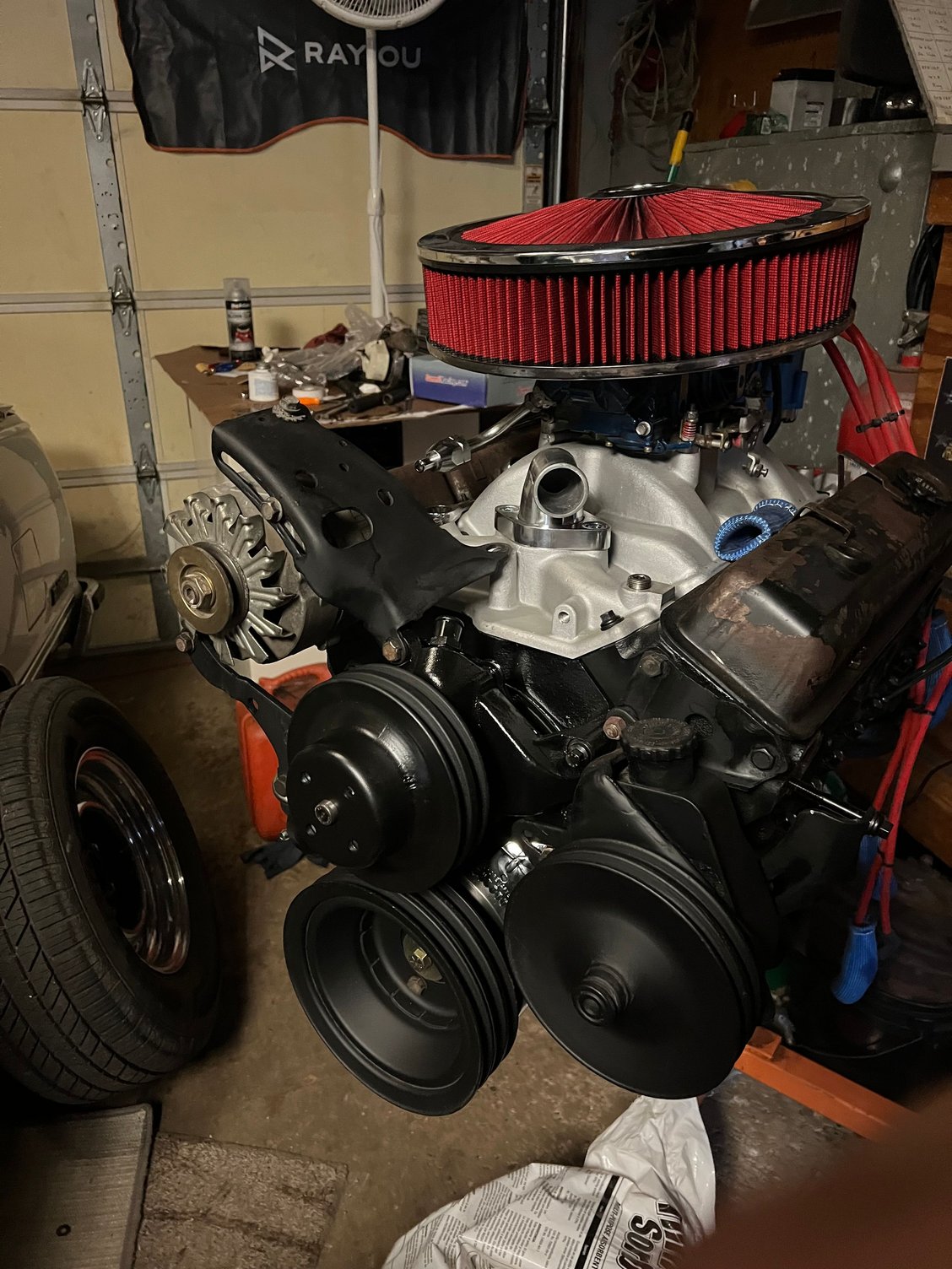

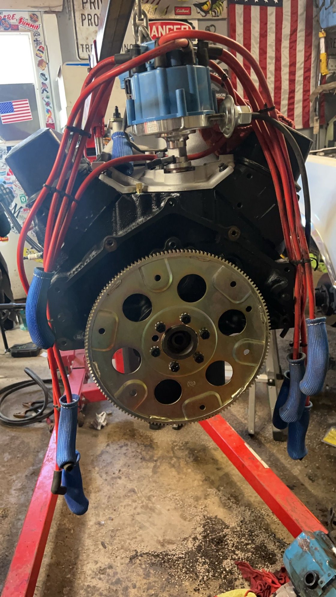

couple more parts came in, water pump, t-stat, flex plate bolts, water pump bolts, Polly trans and motor mount inserts, Sfi rated flex plate…
but I f’ed up not once but twice on the flex plate somehow I managed to order one for a newer motor… externally balanced and one piece rear main, this motor is neither of those so that’s going back I was really hoping to get the motor in this weekend but that’s not going to happen.
got the water pump painted, accessories installed, alt is just there so I could get brackets lined up. I am going to get a new one comming on my next order.
Going to order a different alt bracket as it doesn’t line up with the intake bolt location. I know I can run it that way but not a fan of how it look.
modified the power steering brackes since the a/c is gone it doesn’t need to be nearly as long so that cleaned up the look a little bit on the driver side of the motor

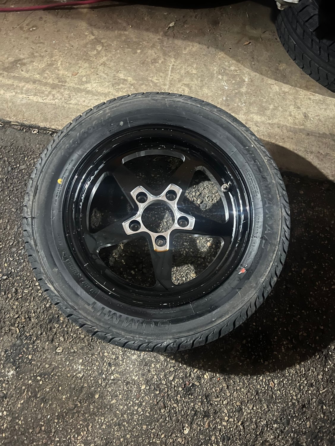

but tonight I got the front tires mounted and “balanced”(balance beads)
I couldn’t imagine trying to do a wider tire on the wheel it was bad enough trying to get a 185 on a 4 inch wheel but using tire spoons and doing it at home is a lot different than using a machine
also checked valve spring pressure to make sure I’m not going to kill the cam when breaking it in
after mounting I realized I wish I would have went up a size or two to get a little more sidewall. These are 185/60r15 on a 15x4 kind of wishing I would have went with a 185/65 or 70
these are a 23.7in tire and a 65 would be 24.5 and 70 would have been a 25.2
but ya live ya learn they were cheap and I’ll run them till they are gone or I’ll toss em on the back and burn em off at the end of the season

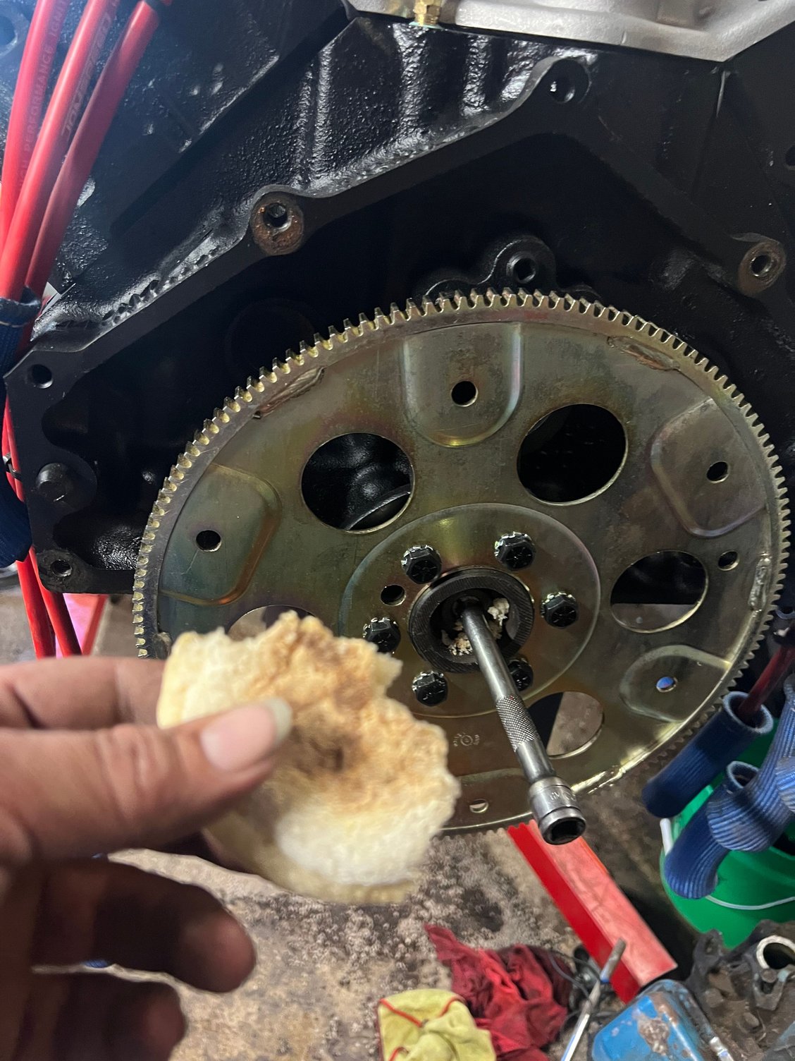

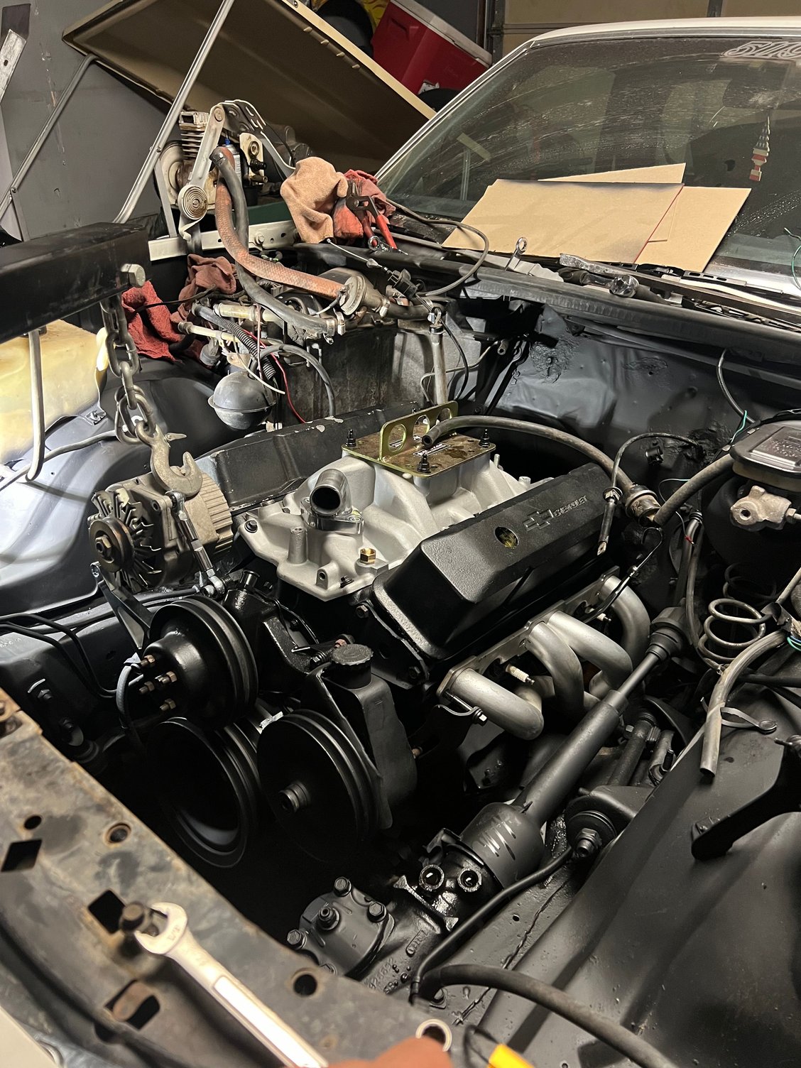

got new alt bracket,flex plate, couple fittings and other stuff put on, and got the motor back into the car.
did the ol bread trick since this came from my buddies blaster that was a manual
flowtech afterburner headers fit great I put them in from the top, only thing I found for an issue is the collector hits the column shift linkage so I gotta figure that out. Looks like she getting a floor shifter

ended up having to run to harbor freight mid install to grab some wrenches so I could get the header bolts tight by a couple of the tubes and the rear would have been in possible in the passenger side without them.
a very small amount of clearancing was needed in the passenger side where it was hitting the control arm

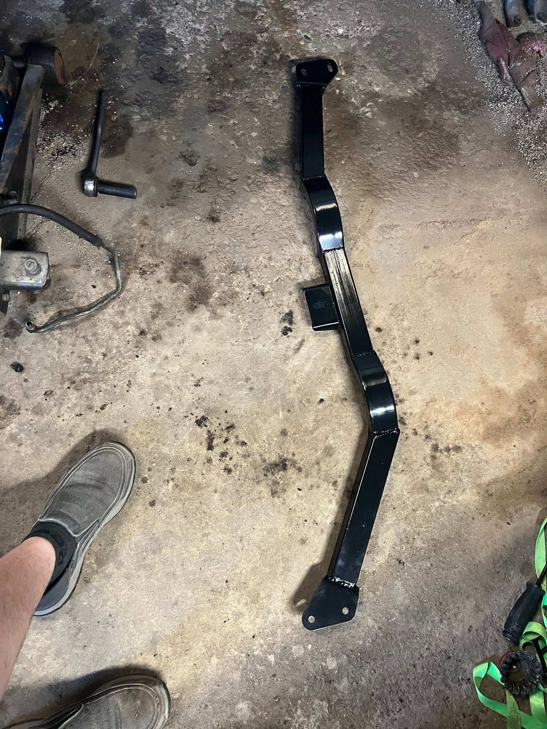

picked up a jegs double hump cross member, fit decent other than I had to along gate the Holes a touch to make it bolt in 100% kinda wish I would have spent the extra $ and got the summit/g-force one but this will work

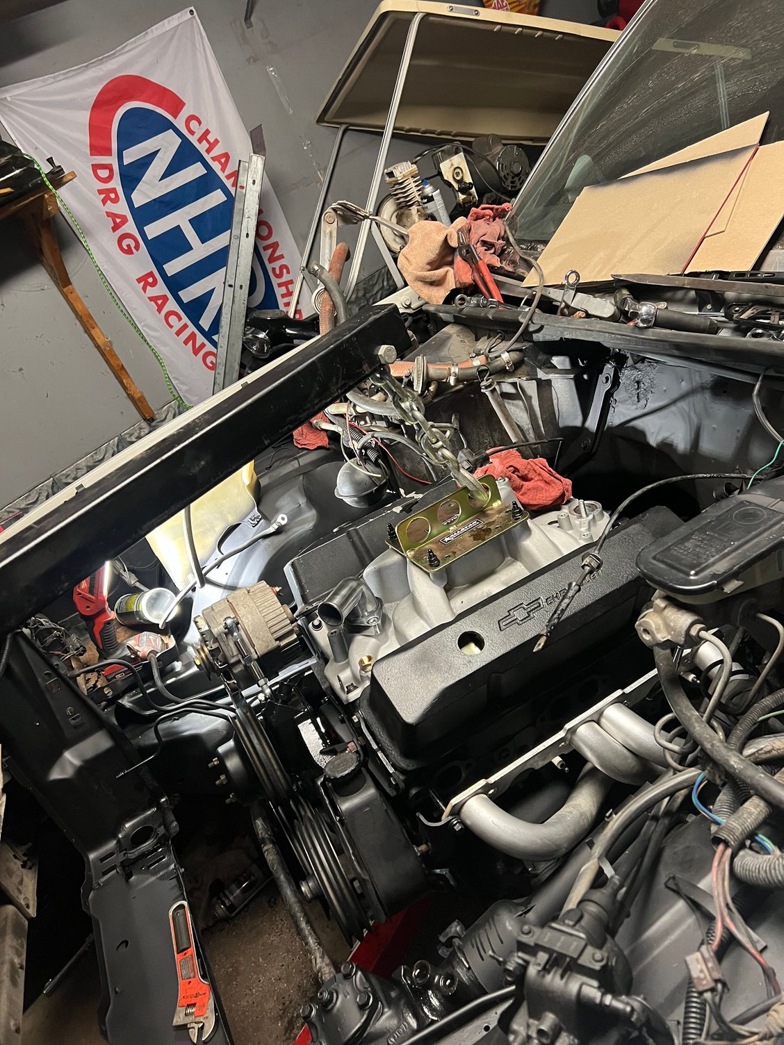

driver side header was another story I fought this thing for hours, colum shift linkage didn’t clear by a lot, had to give it some clearance at the frame where the front brake line comes off the proportioning valve, a aggravating amount of in and out, bang in here, bend that, pull on this, under the car, back to the topside, have the kid shift it while I watch. finially got it.
