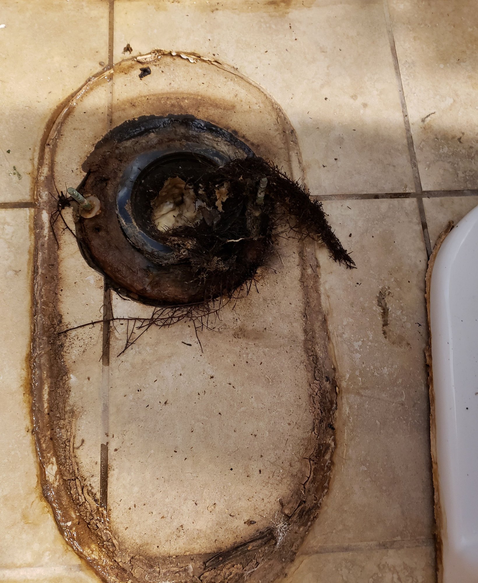

Next few are about inspection on our latest place. Drives me nuts when an inspector has a giant 50 page report and its almost completely filled with ticky tack garbage that's clearly just filler to make it look like they did something.
First one I had was the guest bath toilet. Absolutely zero noted about it in the report, but it definitely had a draining issue. Just flushing water alone it wasn't a hard rush down the hole, it was more of a 'fill the bowl' followed by about 2 seconds of slow-ish draining. Even flushing a few squares of toilet paper brought it to nearly a halt.
Turns out it was a root problem. Someone had reused the wax seal and it was definitely leaking out with each flush. As its a slab house and the pipe wasn't necessarily sealed against the slab hole, the water would just collect around the flange and drain out under the slab. This attracted roots from the dirt that grew up the pipe, through the hole in the wax seal, and down the pipe about 18". At the flange itself, the roots nearly 100% blocked the opening - hence the near total stoppage of draining whenever TP was flushed.
Luckily it was less than a $50 DIY fix (new seal and a new flange), but still would've been nice to have the sellers pay for it. The roots hadn't damaged anything thankfully - they just went through the wax. Once I cut them off at the flange, the ones in the pipe pulled right out.

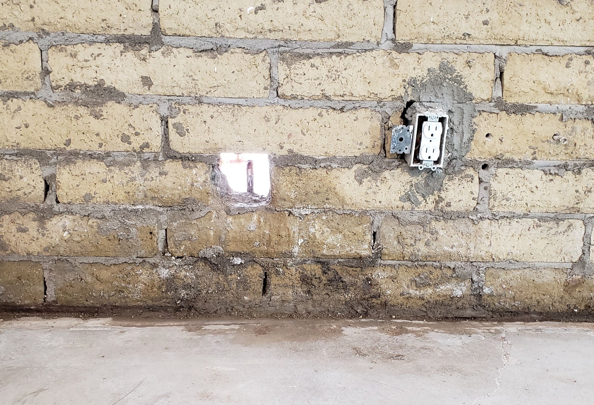

This story is the water leak Id mentioned before that I paid a plumber to come fix.
Theres an outside hose connector (that also feeds the pool auto fill) supplied by a pipe run under the house and up the center of the ~10" thick block wall.
I noticed after the inspection that it was wet on the exterior wall and at the concrete butt joint between the house and patio slabs. I assumed the inspector had tested it and didn't have a hose / bucket and just let the water splash out. This water line is under the covered patio so it would never normally get wet - even in a heavy rain storm.
Next time we went to the house though (after we'd closed of course), I noticed it was still wet (the house and slab) even though the inspection was done weeks prior and it hadn't rained at all. Didn't know how the piping was run, so I went to that spot inside. Oddly enough, the tile around there was exceptionally cool. It was late summer and 100+ out, so the tile around the perimeter of the house tends to run noticeably warm - except this 6 foot wide spot. I also notice the outer few grout lines are also abnormally dark (in a spot that would have 0 foot traffic).
You can probably see where this is going... touch the baseboard, it's absolute mush. Touch the drywall - soft and floppy.
We tore out the drywall immediately and you could clearly see the issue. From the point the pipe passed into the wall, that block and every block below in a pyramid shape (about 3' each way) is soggy. The house slab was also wet about 18" in roughly in a half puddle shape that lined up with the wet blocks.
Since there was no access hole and Id never worked with block house, we had a plumber (who was great) come open it up and do the repair.
Just drives me nuts this inspector spent so much time documenting squeaky doors, drywall dings, and other dumb stuff that he missed the really important things.
This also reinforces to me that every home inspector should use a FLIR / temperature camera. They're not that expensive these days and it makes spotting any kind of water leak inside super easy. All of this flooring and drywall would've lit up like a Christmas tree due to how cold they were from evaporation.
Pic after the pipe was fixed. Drywall and 1x2s torn out, floor tile stripped out (already planned for a different project). Had set up fans on it to help speed the dry out process.
