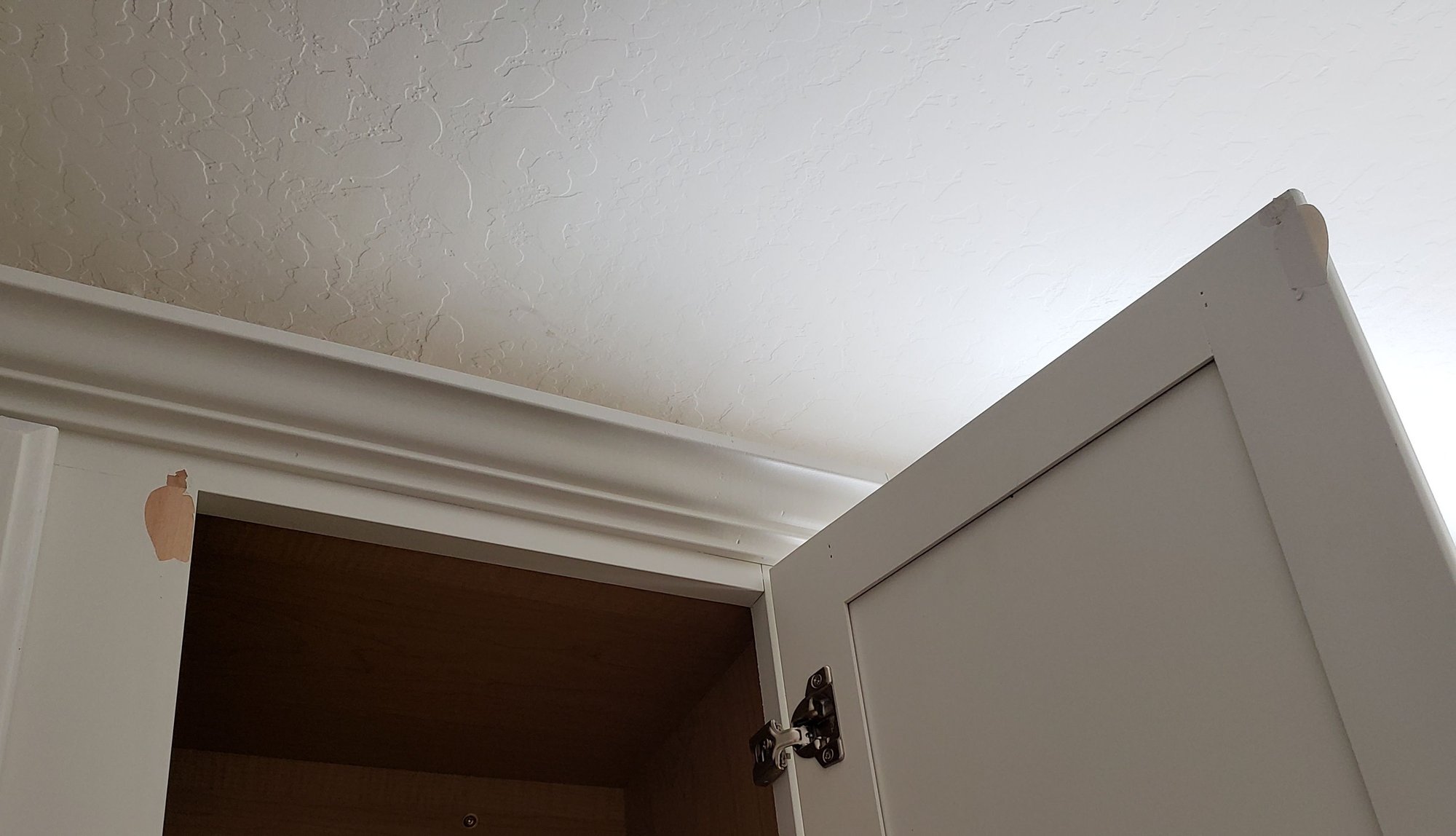

Painted over all of the rubber bump stops. Every single one stuck and peeled paint off the mating surface:
Numerous chips and dings that appear to have happened post spray that he touched up with a brush - note this is right at eye level too.

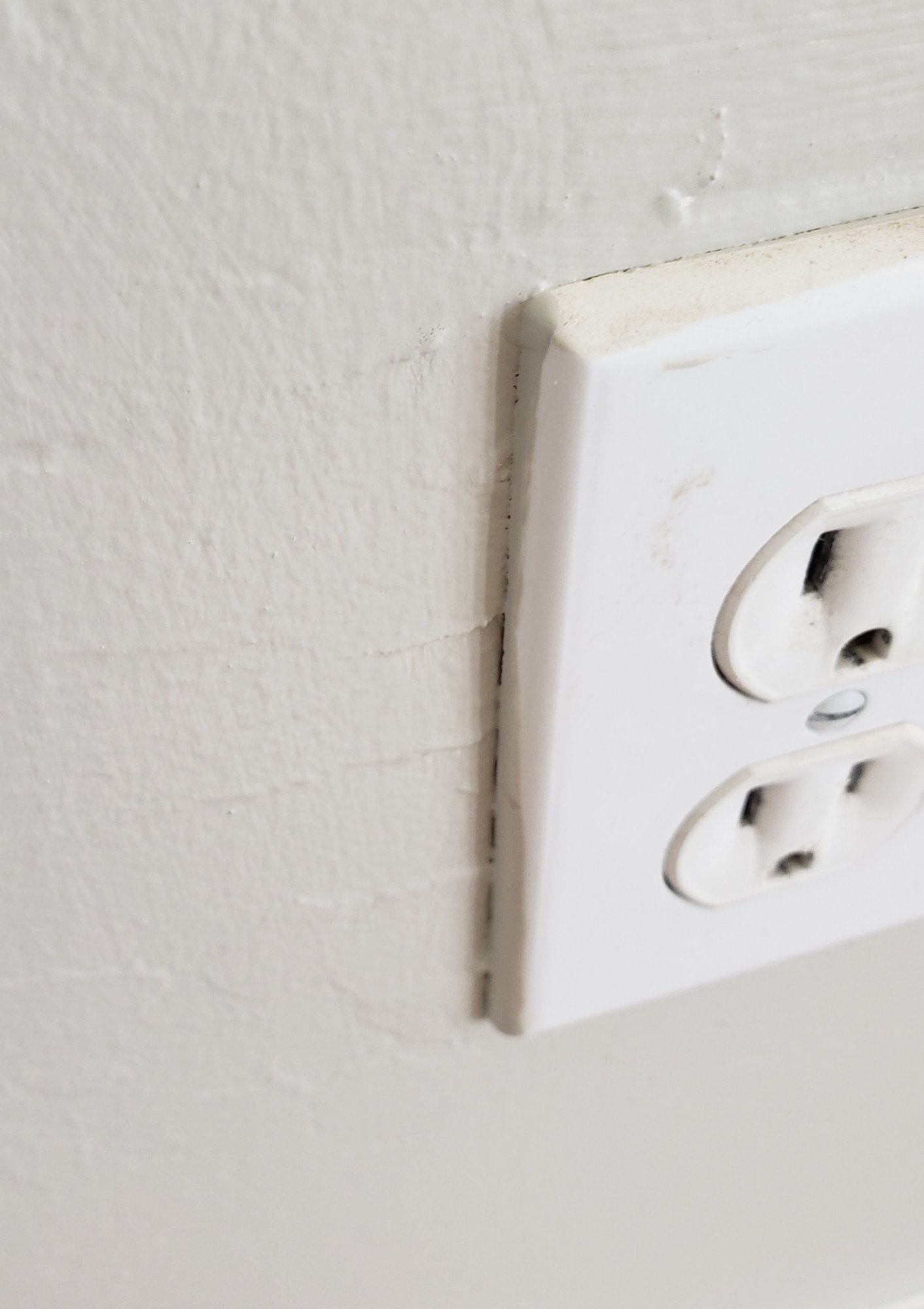

The mud work for the drywall in my new home is horrible! So many outside corner joints with fine cracks along the outside corner bead and screw holes showing. And when they did the 1-year walk through and repair, I was stuck painting the repairs. Some repairs are worse than the before and others had the same problems happen again. HORRIBLE!

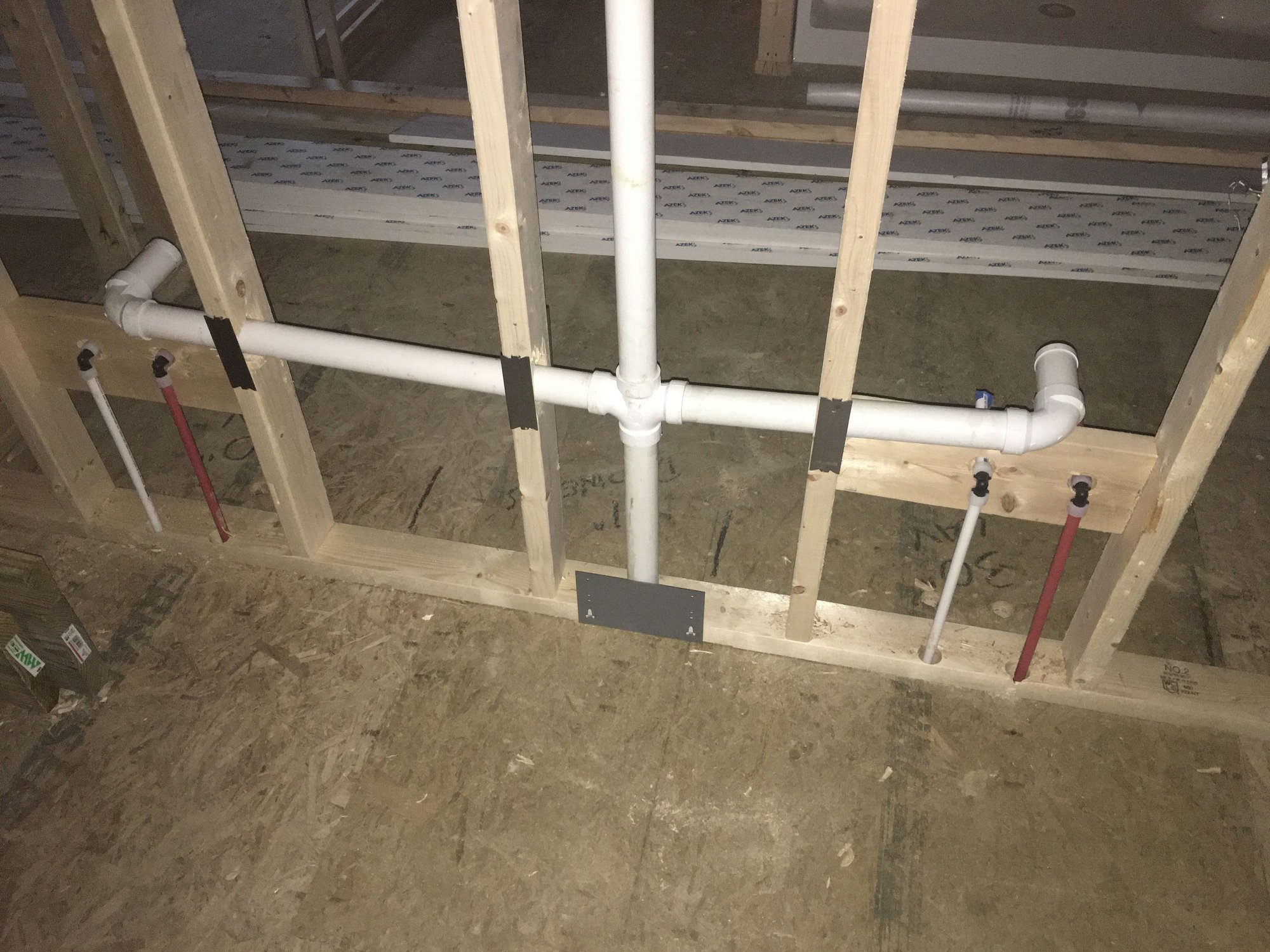

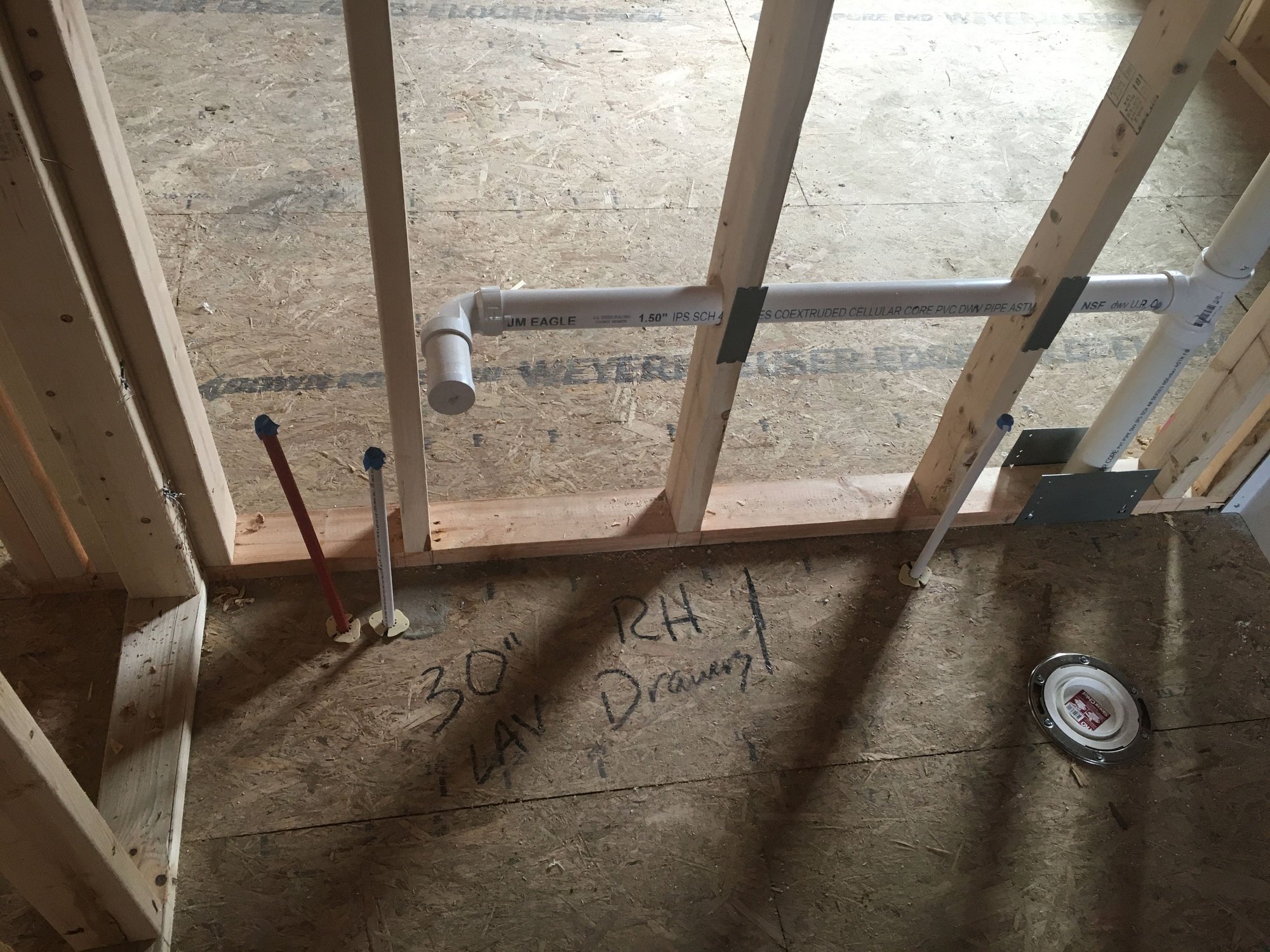

I am used to what might be more old school plumbing (not talking copper vs CPVC or PEX), I am talking all plumbing connection going in the wall cavity. I said nothing and when my plumber friend saw this, he lit up and said "that is the mark of a lazy ****ing plumber". I asked him "why". He said this shows the plumber chose to put the supply lines in the floor because he did not want to take a small bit of extra time to add a 90* and stub the line out. So the trickle down is that it affects the guy putting in cabinets and vanities, the extra goofing that has to be done to seat those because the plumber took a short cut.
Side note, I am not sure how all PEX installs are done, but I kinda miss the clean look of copper lines. Because PEX is pliable/bendable, there are areas liberties are taken that would not happen with copper. Plus, watch the shape change of the hot water line when you flow water through it (expand and contract).

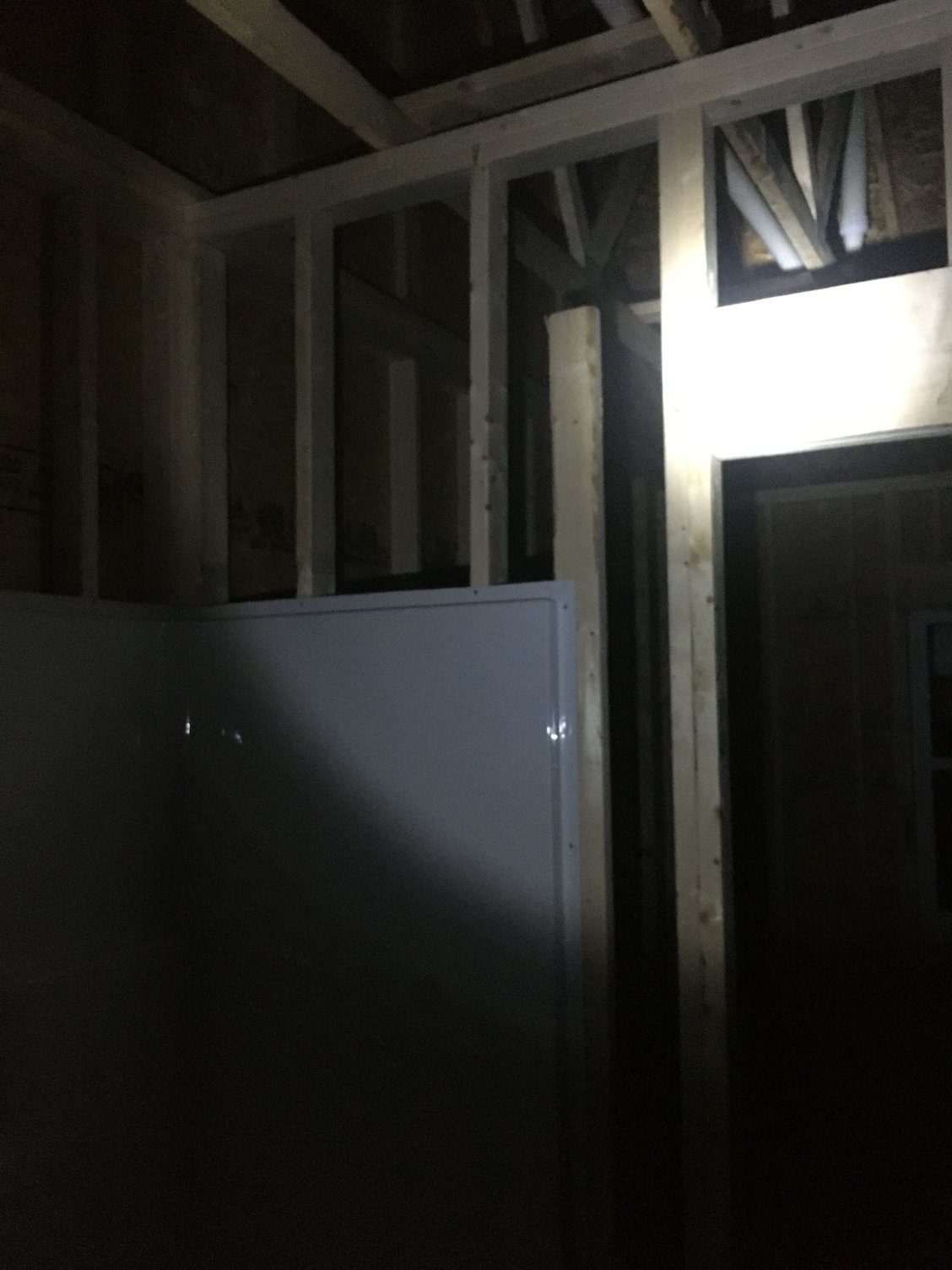

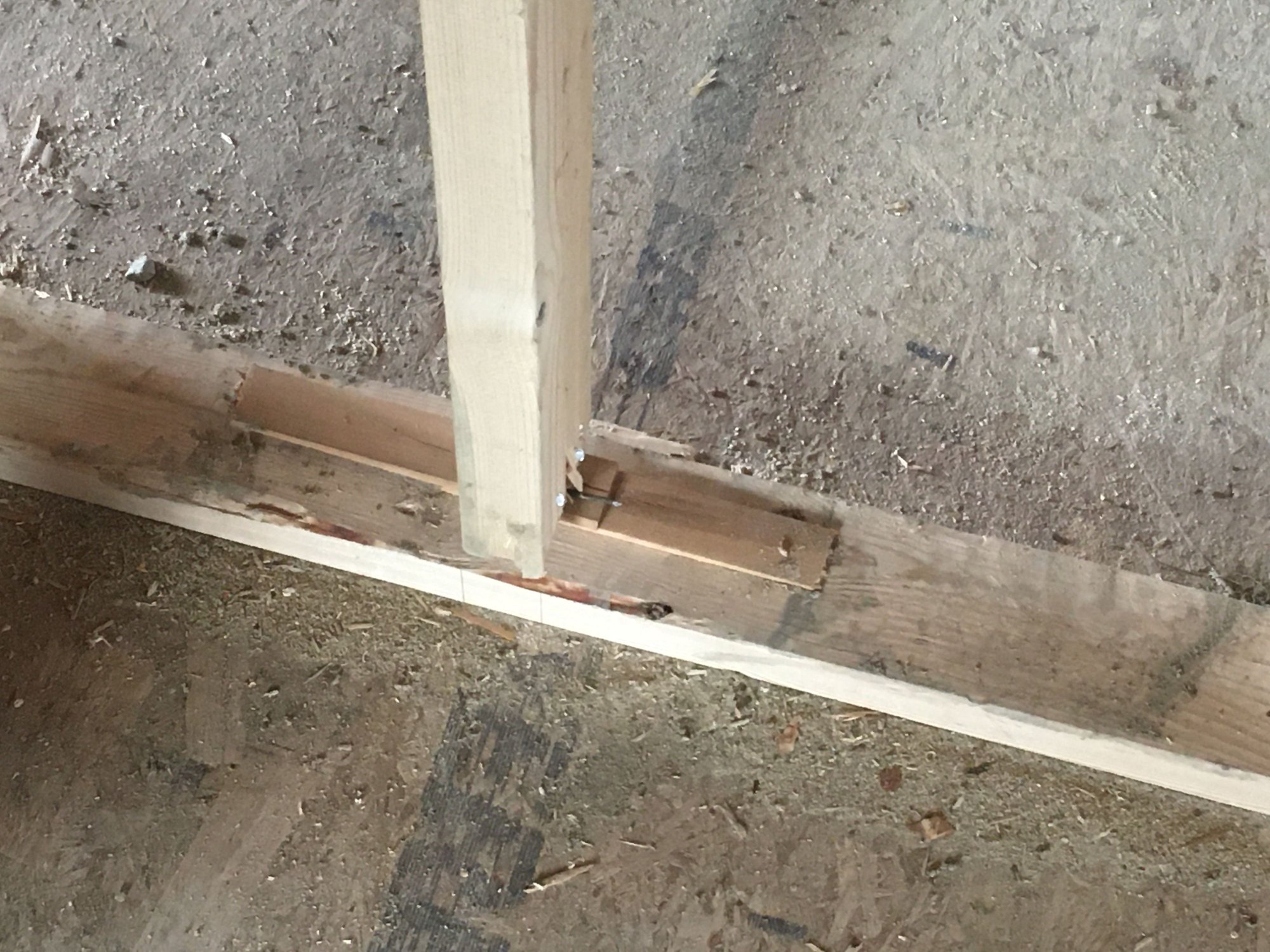

Not sure if it is truly required, but not sure how you feel, I would want an extra stud for that last nailer fin of the shower.
OH, but the next day they added a stud
And the day after that, they put one in that actually went floor to ceiling!
For as much as I paid for this house to be built, I had this garbage pulled out. It was not load bearing, but that stud could be used else where. Not to mention, I had them remove some REALLY warped lumber. Studs that bowed OUT into the room OR warped so much that 16 on center did not exist!
Notice the plumber moved the water lines.... Notice lack of the metal nail stop plates. 3 times I told my contact at the building company. Drywall went up and I found the first punctured line before they energized it. And then before I got the keys, I finally found and confronted them with the building code violation.

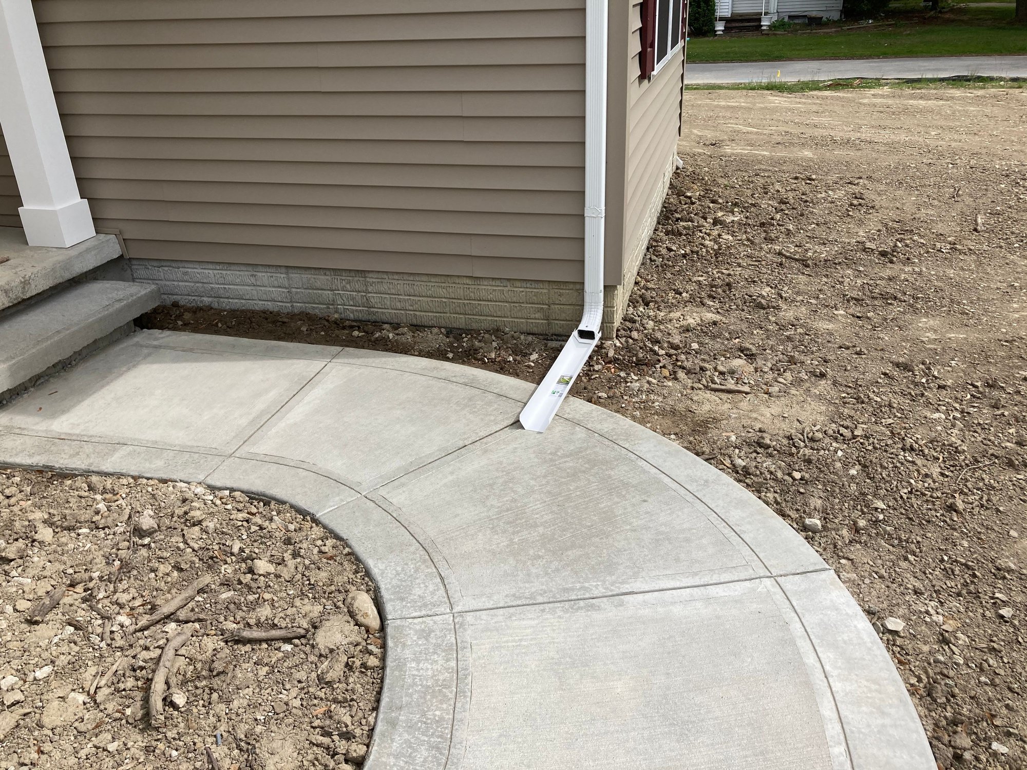

Downspouts. A bunch mounted high and would promote ground erosion as rain water drains. And how about a OSCHA violation with a trip hazard of a splash block on the sidewalk (even worse, does not flow the water with the grade of the property). I was told they do it this way and then when the home owner does there landscaping, they adjust it as they want. Why start with a trip hazard into your nice new home!!

Wow, I've never seen an end shimmed stud before. That is pretty lazy...
