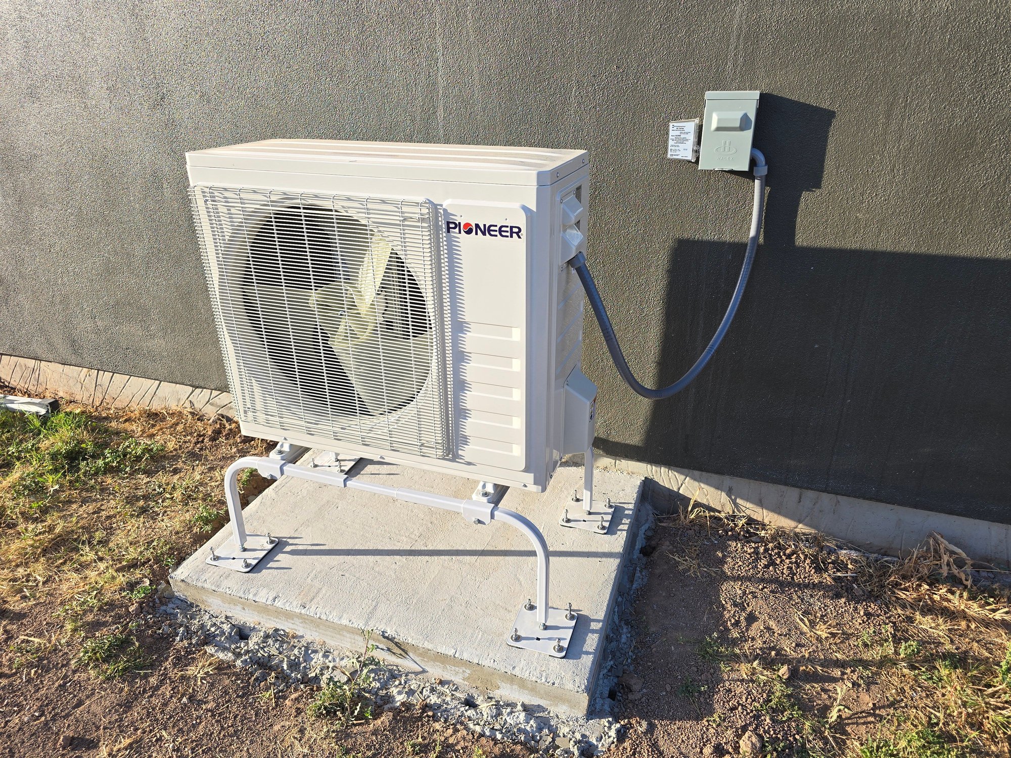

Got the AC units mounted to the slabs. Those Quick Sling brackets are nice! The threaded legs made it super easy to level too (to counteract the drainage slope of the concrete).
I really needed to get that step done so I could figure out which stud bay the power and refrigerant lines will go into.

Got both disconnects / surge protectors / power whips installed. Just need to run the inside power back to the breakers.
Then Ill start working on mounting the inside unit / running the lines.
