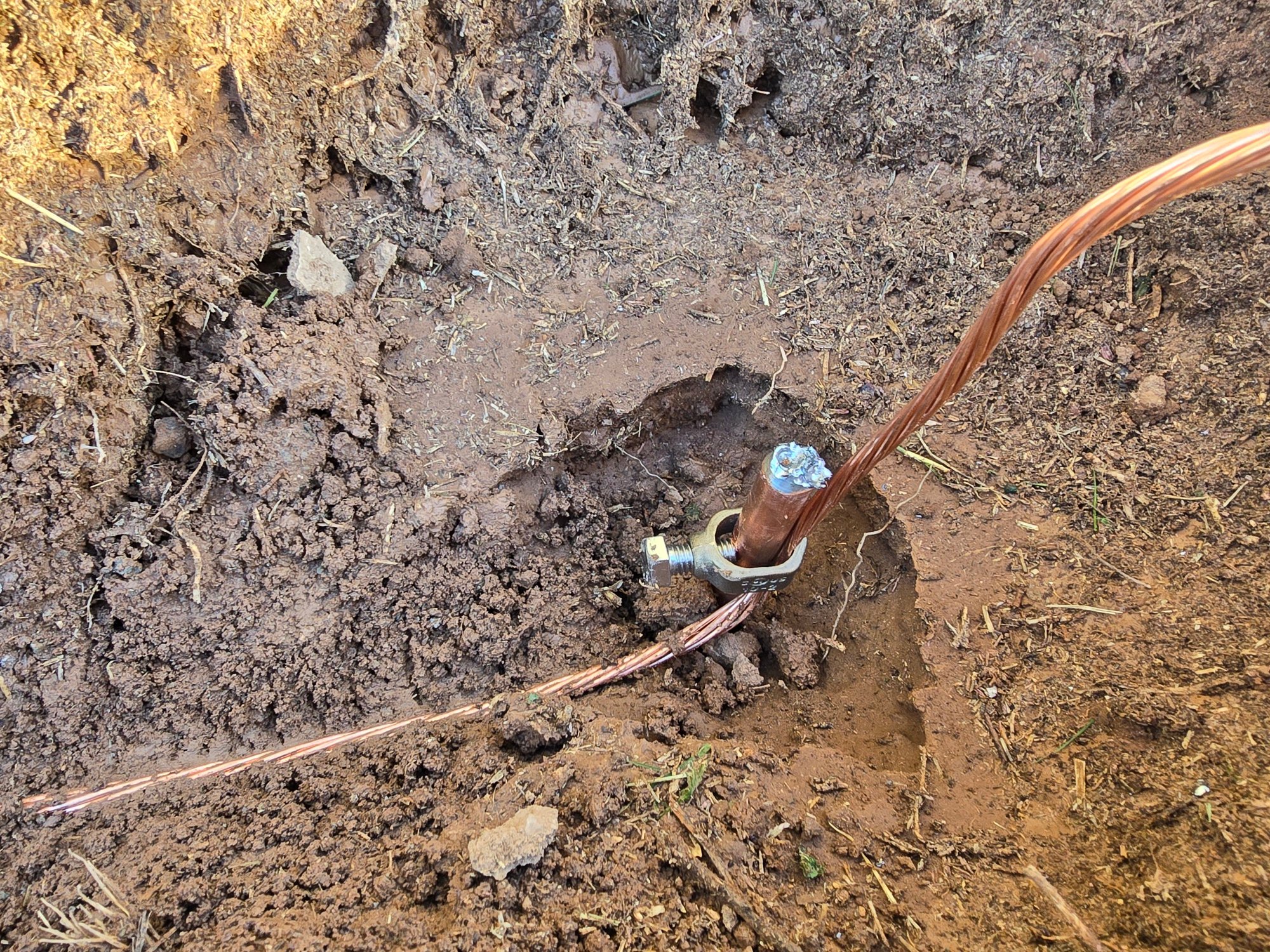

Also got the ground rods driven - that was sure brutal. Id bought a 'hard soil water probe' to try to make this easier - it's a hollow steel tube with a spiked end where you hook up a garden hose to help soften / blast the dirt out of the way. Worked great for about 4 feet... then the dirt got so hard that the water wasnt able to push it out of the way anymore / kept clogging it.
As the rods need all 8 feet underground, I swapped to the sledge hammer. That lasted about 3 minutes before I gave up. It's impossible to do solo with so much sticking out of the ground (as it wobbles a ton after each hit) and Im afraid to hit it hard with someone else holding it as Im probably 50/50 on actually hitting it.
Ended up going down to home depot and rented a 27 lb rotary / demo hammer. I wish I wouldve done that as step 1 - the rod sunk into the ground like butter. No force at all (other than the weight of the tool) and the knurled face gripped onto the rod to keep it from slipping off.
Got both rods in and a shallow trench between them for the wire. Just need to drill through the stucco / lath to finish it up.
(pic looks flush, but it's sitting in a ~12" crater Id shoveled out to make sure it's well subsurface in the end)

That's a good tool to use for that gro0und rod.
It's so good that Im a bit embarassed I wasted even one minute trying any other avenue, much less the hour+ I actually spent.

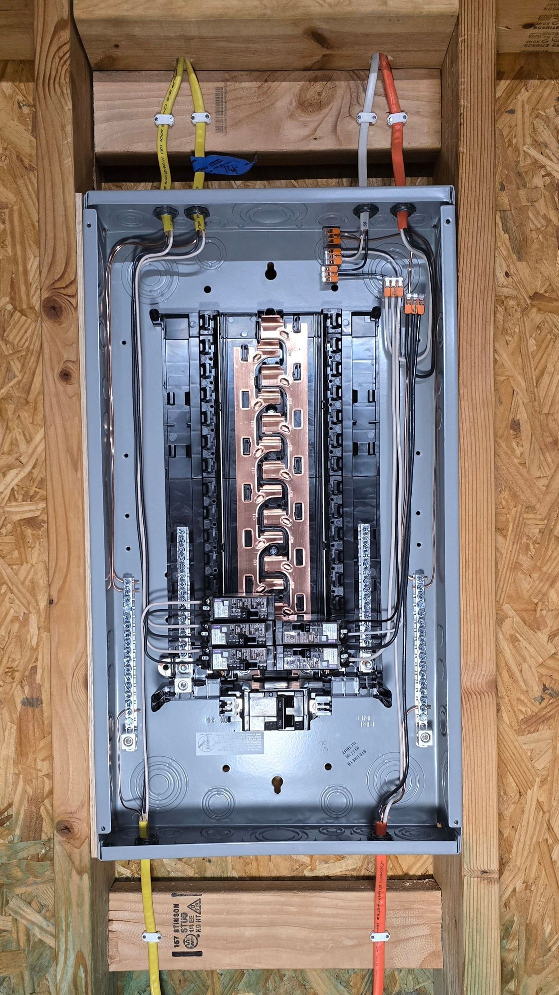

Making little bits of progress here and there.
Wiring inside the garage is done up through rough in. Wrapped up the subpanel wiring tonight for the branch circuits. Next up is running the ground and feed wires into the panel / to the house.
