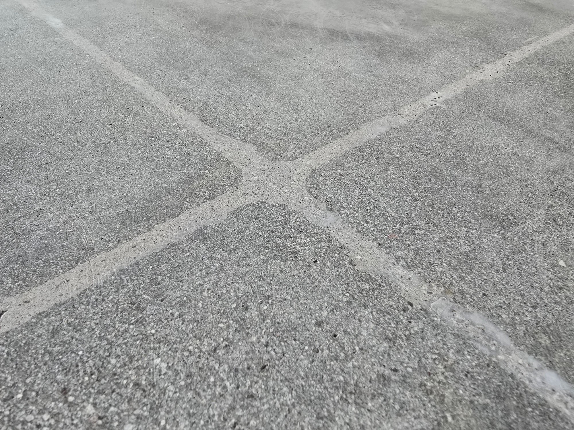

Made more progress this weekend - got the surfaces all prepped. The surface grinder didnt do what Id hoped. My plan was to over build all of the crack and joint fill, then just flush it all up with that walk behind grinder - wrong...
That machine doesnt like hitting abrupt surface spikes at all - I worried I broke a $40 bit when I went over the first joint it jumped so hard. So I knocked down a high fill section with a masonry wheel (which really wore the wheel out quickly) on a 4" angle grinder and tried the walk behind again. The results were pretty mediocre - it was really struggling to eat into that fill epoxy at any reasonable rate. Not entirely sure why - the must be some pretty hard fill compound.
Ended up having to buy a diamond cup wheel and hand grind all of the fill spots flush first, then come back over it with the walk behind to level everything. That was every bit as miserable as it sounds as it was slow going with the hand grinder.
Overall it came out good in the end though. I was surprised just how bumpy the floor was (as the top 1/16-1/8" of floated cream is a different shade of gray then when you start getting into the actual concrete mix/ aggregate tops- makes it real obvious where the high and low spots are). Downside is you cant really tell while youre grinding as so much dust is still left on the floor, you have to sweep it first to check if you got it all flat. Wish I wouldve had another day with the grinder to get it absolutely perfect flat, but itll be fine enough for a garage.
The dust removal has also been unexpectedly difficult. We swept up all of the loose dust, ran the leaf blower through twice, then concrete vacuumed it twice and you could tell there was still a good bit of dust trapped in the pores.
Washed it twice back to back with water and a broom, but it was still getting out a ton of dust. Washed it again tonight and it much cleaner - probably 90% clean water now. Im going to do it 1 more time tomorrow night before letting it dry for the weekend.

Close up of a joint fill and the grind job - came out pretty good - most of that floated cream layer removed and plenty of surface texture to help the mechanical bonding.

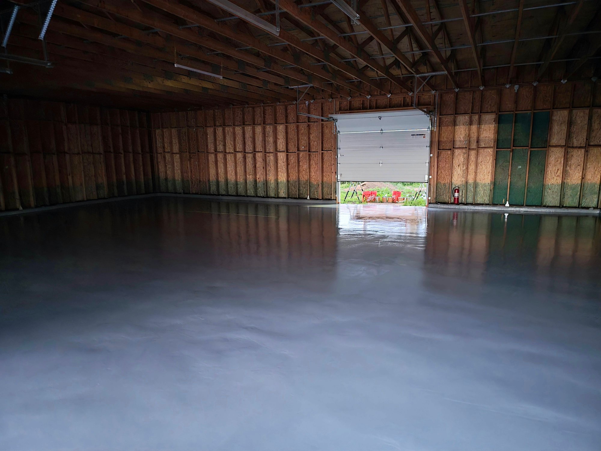

Main color epoxy coat completed.
The super short pot life was tough to deal with - really slowed things down. Had to mix half batches to keep it alive long enough for me to spread it.
Those metered / notched spreaders were a lifesaver for this step. The stuff is super thick - the paint roller struggles to move it around at all outside of knocking down the high spots. But those spreaders made quick work of getting the stuff where it needed to be.
I did have one issue - a roller came apart on the 2nd batch. I saw some FOD in the coating, but it suddenly went from a handful of chunks to 100 before I realized where they were coming from. Scraped a good bit out, but we already had the next batch mixed, so I wasnt able to 100% clean it up. Will try going in with a razor blade and needle nose pliers tomorrow before clear to get as much of the rest as I can.
2 days down, 1 day (ployaspartic clear) to go:
