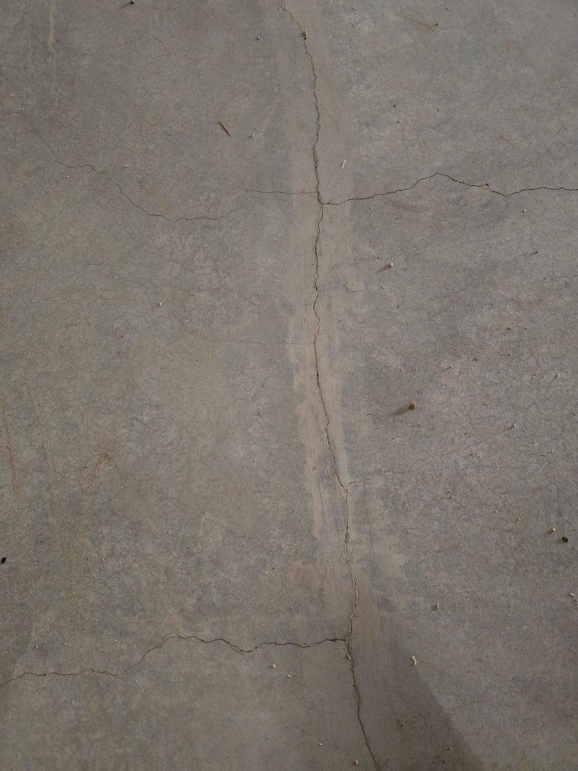

Now that the shell permit is done, the next step is to do the floors. Im still not putting anything inside besides large tools (ladders, scaffold, etc) and the GTO. Dont want to put a bunch in there as its all got to come back out.
First stage of this process is crack repair. Not sure of the cause, but I ended up with a good number of shrinkage cracks that happened very early after the pour. No structural concerns once the concrete cured as there's so much metal holding things together, but I do worry about spall chunks ruining the finish or hairline cracks translating through the epoxy - especially since I plan to do a solid color/ zero flake.
(the smear mark was the concrete places attempt to patch it when they were here doing the driveway a few months later. The problem is the cracks are so fine, there's no way to really get anything into them.)

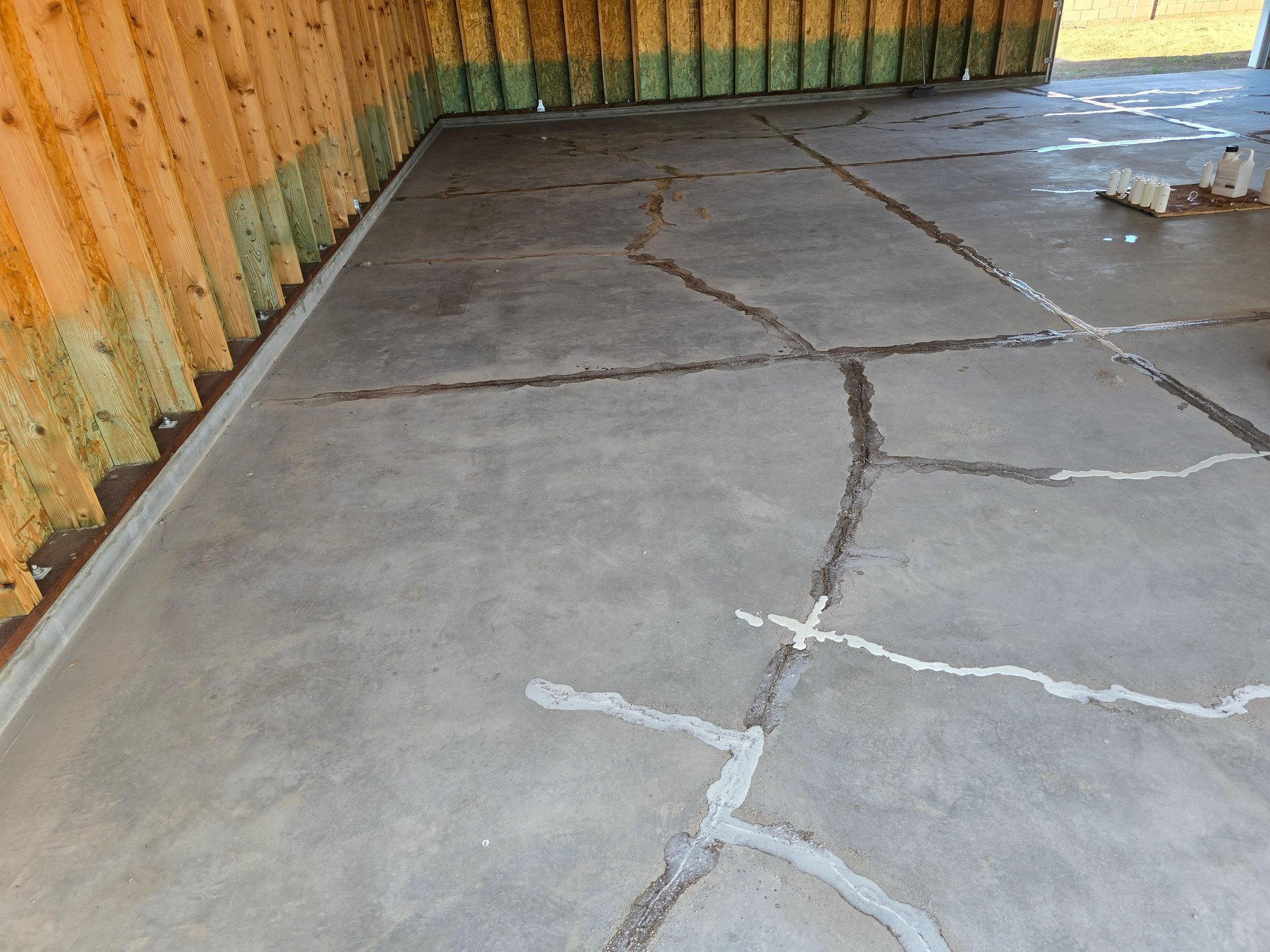

Went through and chased the cracks with a 1/4" crack chaser wheel in the angle grinder to open the tops up a bit. You can see how much more exaggerated they look in this picture.
The crack chaser is V shaped, so I also flared the top of the saw joints to force any loose bits to spall now so I can fill them. That sharp 90 degree corner made for a bit of a weak spot as we rolled stuff across them.
Filled all of the joints/cracks with fine sand per the instructions of the fill compound:
And filled the joints with the industrial liquid filling compound (Legacy xtreme set 100). Im about halfway filled on them now - had to buy more 2 part filler.
Supposed to be pretty good stuff - higher bond strength to concrete than the strength of the concrete itself, and significantly more flexible in case the joints move at all.
(the different colors are different stages of cure - the stuff kicks quickly, so I apply it in 12 oz ketchup bottles). The natural color is that creme color when cured.
