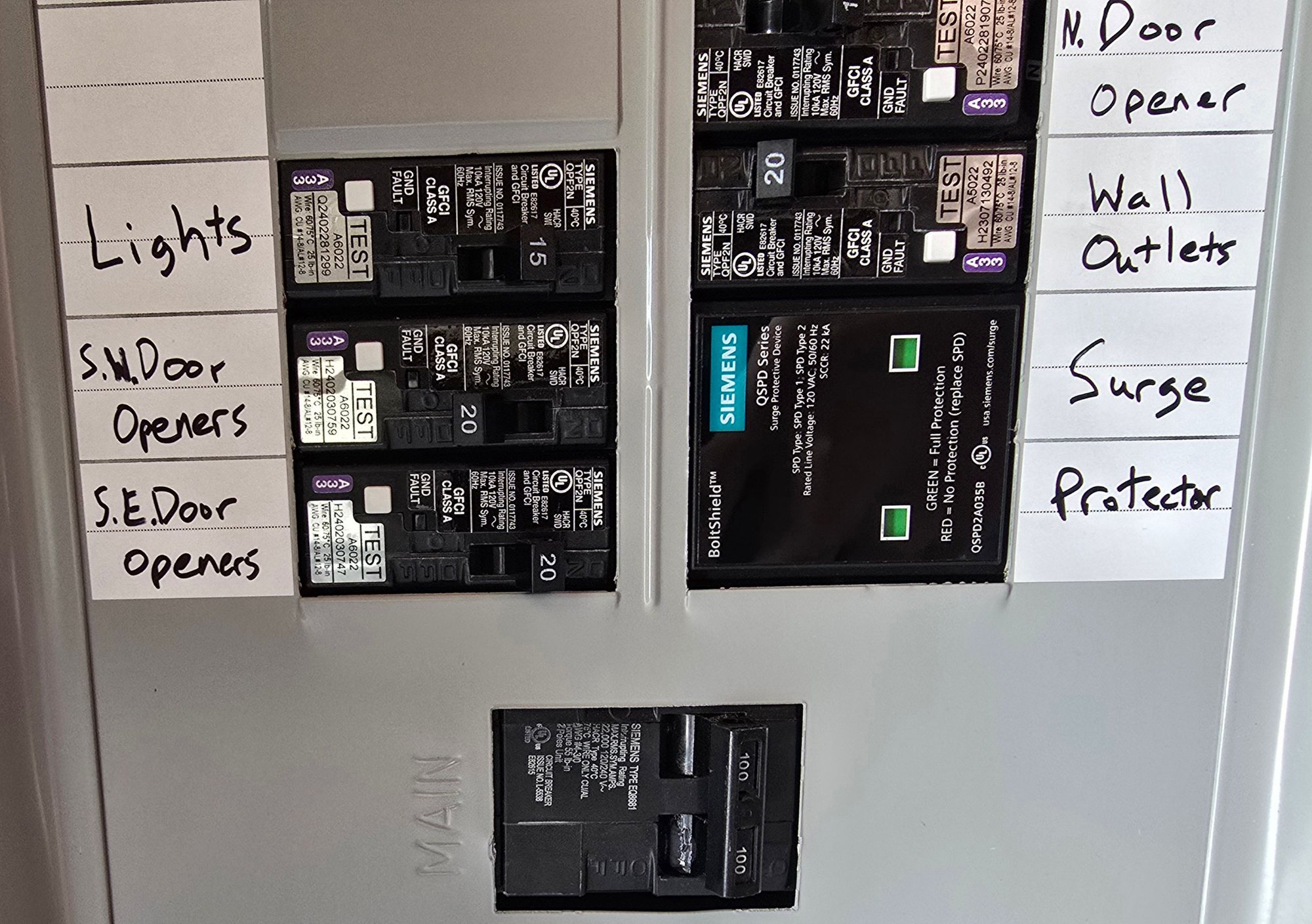

Well, that's one big milestone checked off: flipping the main breaker on for the first time ever (while cringing for a couple seconds hoping not to see showers of sparks, lol).
Ive got all of the GDO outlets wrapped up, all of the wall outlets wrapped up, and half of the ceiling light outlets wrapped up. I got stalled out on the lights - I didnt realize they only give you a few actual plugs - the rest are just jumpers to string lights together. Unfortunately my ceiling isnt wired to accommodate that - Id planned to plug each one directly in. So, more plugs coming today - but at least now I can run my temp lighting off of the actual wall outlets inside isntead of via a bazillion feet of extension cord up to the house.
Unfortunately I drained all day Sunday hooking up just 4 wires in the main house panel. That was absolutely brutal. It's just too much bulk to add on top of an already busy box. In hindsight, I wouldve saved a ton of time slapping those number labels on every hot wire, pulling all the breakers, folding all of the branch circuit wires out of the box, then laying these subpanel wires in first. Trying to fight around fist fulls of existing wire bundles (that frankly arent run nicely to start with) was an absolutely massive task.
So now Im down to just finishing 4 more ceiling light receptacle boxes, hanging 6 more lights, and adding the plugs to the hung lights missing them (whenever the plugs show up today). Getting super close to the end on this one...

I see you have a hole house surge protector in your panel. I have on in my main panel, except mine doubles as a pair of breakers. The "concept" they advertise is connecting it to something you will notice if the breakers trip....
Yep, I saw those also. Bad thing, at least with Siemens, is that they don't currently appear to make one with GFCI also. As this is built to 2023 NEC / 2024 IRC, all of the circuits Ive got must be GFCI (the recently released 2026 NEC is even more strict - they added even MORE circuits to cover with it).
I could use the outlet style GFCI, the bad thing is Ive only got 1 circuit in easy reach - the wall outlets. Every other circuit needs a ladder to get to any outlets, so it would be a pain to have to reset. Because of that it would only save me 1 breaker, so I just skipped it.

Yeah, the GFCI topic is a bit of a tough one. I was able to run my electrical so that the first outlet in a series is a GFCI. It cost less then the GFCI breakers. I even read the code states that if you are using an outlet ONLY for plugging in a ceiling mounted shop light, it must be GFCI protected. Basically, in an outbuilding, if it is an outlet, GFCI protect it.
I heard of someone mounting GFCI items like the link below right under the breaker panel to start each circuit. But at the point you add the cost of a breaker (say $10) and this at $22-$24, you are now about $34 in, plus wire and time.... And the breaker is ballpark $50 if I recall. So $16 more and it's a cleaner configuration.
I agree - IMO they're going way overboard with it, especially with the 2026 NEC changes. I really think its going to start to push people to install them in some spots just for the inspection, only to remove it when it starts nuisance tripping in actual use. IMO electric motors and GFCIs just arent a good combo.
Maybe Im wrong and GFCI tech has improved in recent years to reduce nuisance tripping. I sure hope so as the way things are trending, we're maybe 1 more code revision from it being mandatory for the whole panel.
Id thought about that path, but my problem is that only one of my five circuits has receptacles at ground level. All the rest of the receptacles are up by the ceiling. Given the reset must be 'readily accessible', I figured theyd fail me if I did the receptacle type GFCIs on the other circuits. So I just kept them all matching and did the GFI breakers across the board.
