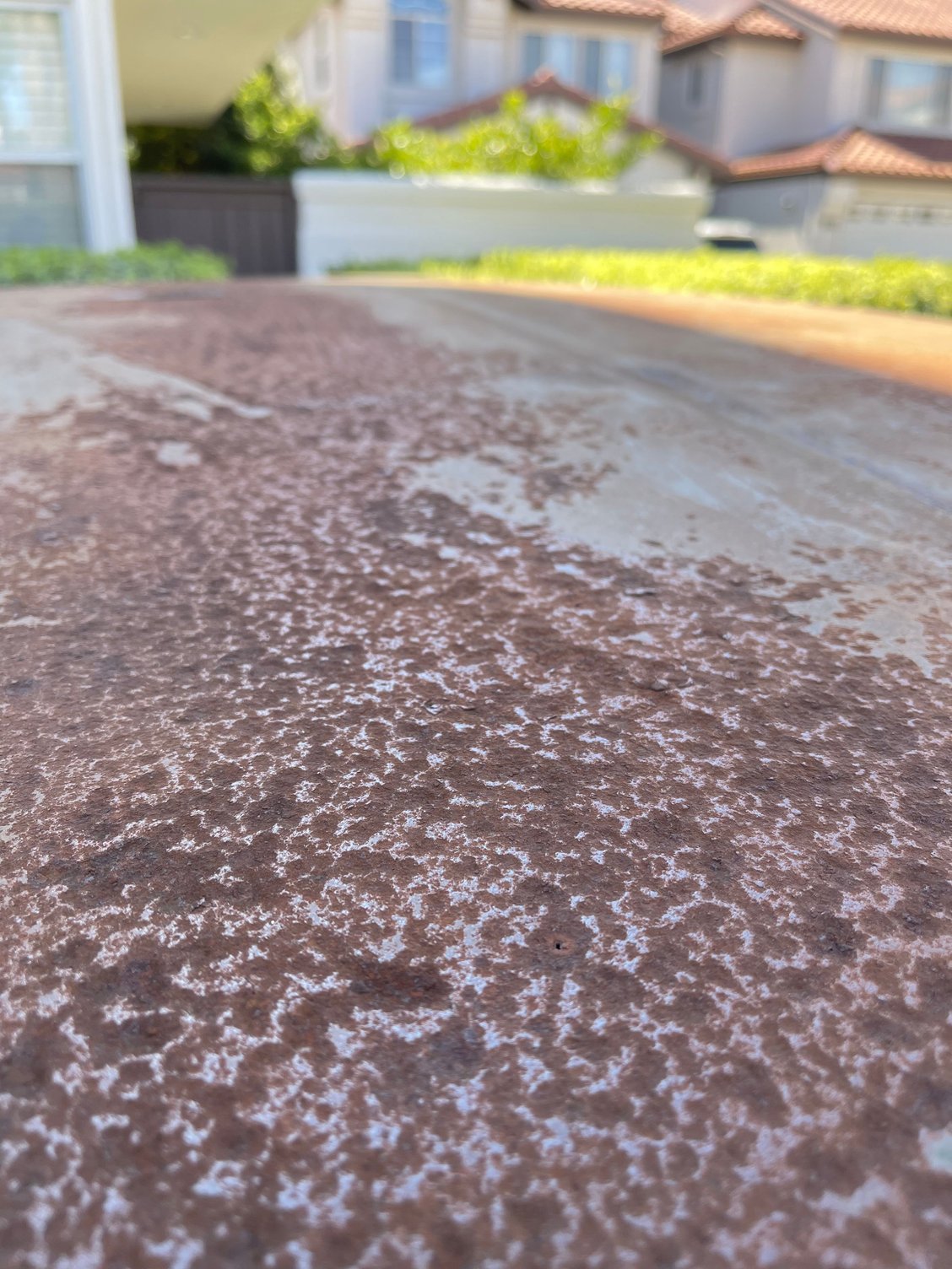

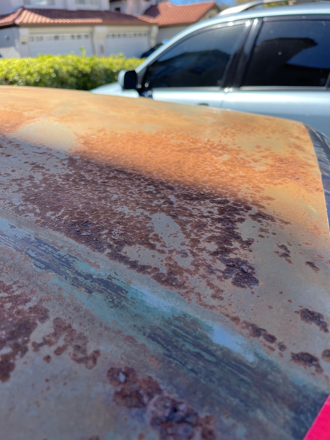

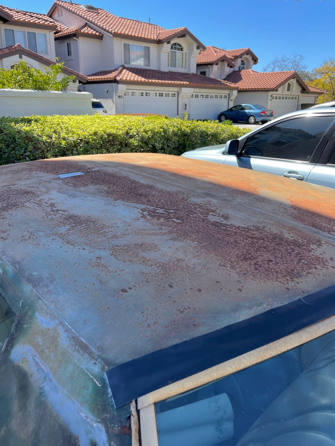

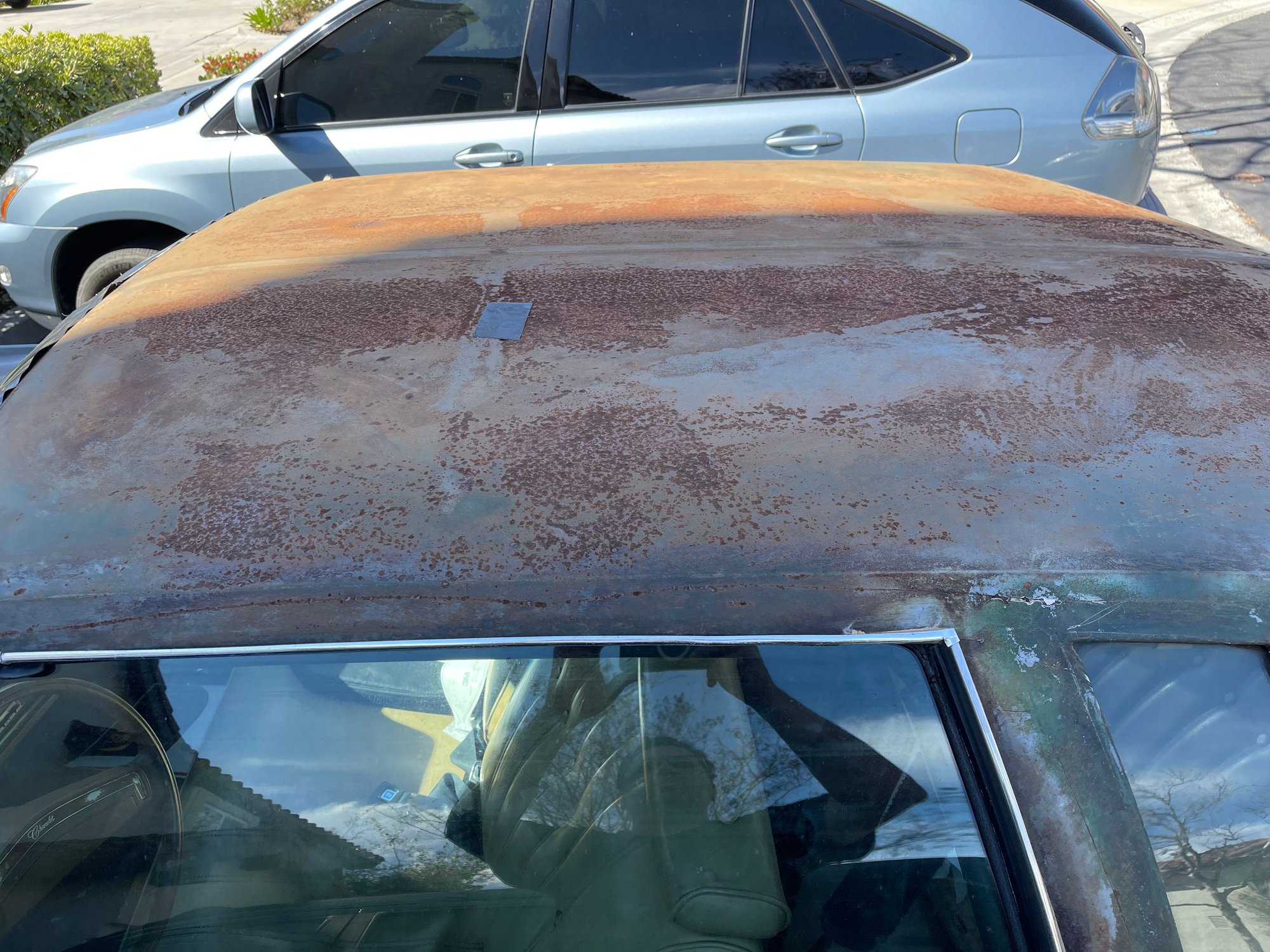

Hi all
how do I get rid of rust on my roof? I used 60 and 80 Grit but it doesn’t seem to work
Old Feb 28, 2022 | 05:53 PM
JTBell's Avatar
Joined: Oct 2020
Posts: 48
From: Dallas Texas
I think that's too much to sand down. You may not have a roof left. Try a rust neutralizer or a rust encapsulator, then add the body filler, prime, paint.
Old Feb 28, 2022 | 06:40 PM
Allnewclassic's Avatar
Joined: Nov 2021
Posts: 18
I hope that fixes the problem. Thank you
Old Feb 28, 2022 | 08:52 PM
Sand blasting helps. Using POR15 would be good, BUT, I am not sure how to use POR15 if you want to top coat with a final paint (if you did that, research it first with the manufacturer's recommendations). And you can use POR15 without sand blasting. You just get best results with blasting.
Old Feb 28, 2022 | 09:13 PM
Joined: Nov 2021
Posts: 18
Thank you for the info I’ll definitely go with POR 15 as it has so many good reviews online
Old Mar 1, 2022 | 09:05 AM
Posts: 6,471
Have you thought about doing a landau top? Encapsulate the rust with your preferred method, then just cover it with fabric. Wouldnt look out of place on a car of that year and would save a good bit of body work to make it flat & straight again.
Old Mar 1, 2022 | 09:31 AM
Joined: Nov 2021
Posts: 18
Maybe I will do that. Not a bad idea. Thank you
