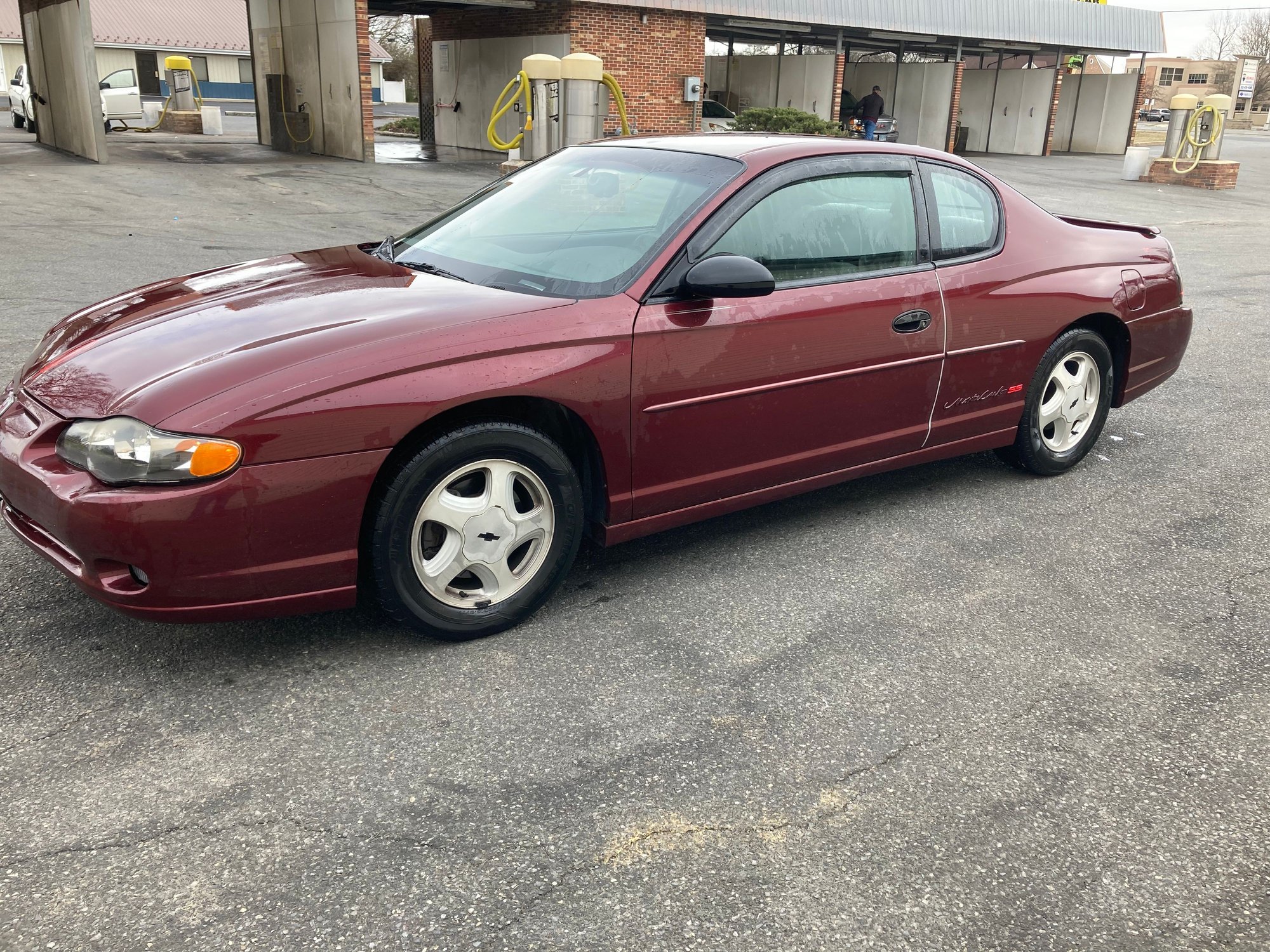

Hi all I’m Jeff and this is my 01 3.8 monte, bought it with 92K miles for 3.5k, was told the o2 sensor needs to be replaced and that the cat was changed before the car was purchased (p0420 codes and two others) after changing the o2 sensor at bank 1 two of the three codes cleared but the po420 code stayed, almost positive it’s the cat (trouble cranking over, TERRIBLE gas mileage, feels sluggish) but was open to hearing second opinions
