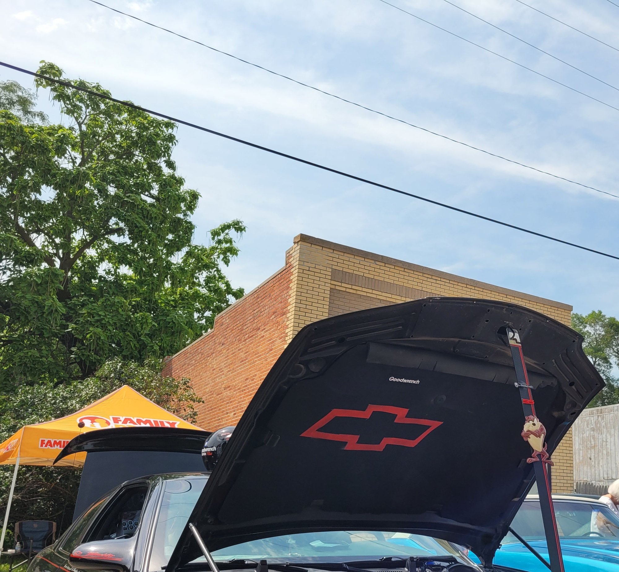

2) I need to find a replacement for the hood insulation. It is one piece and a heavy material that is held on with 5 push clips. My research shows this has been discontinued by GM? My search may lead me to a junk yard if I can't find a new one. I have found an airbrush artist to do Dale's picture on it but I want a new one if possible for him to paint?

You will never find that hood insulated liner that will ever be right. Been there done that. My solution was to got to Hobby Lobby and get some Black Linen fabric and then I glued it to the panel. Used the gorilla glue white glue to make it work. Covered the entire liner with the glue and spread it to a thin even coat, then applied the material and pressed it to the liner, trimmed it and reapplied the snap on items and installed it on the hood. Then I taped off the design I wanted and painted it and the results are in the photo.
