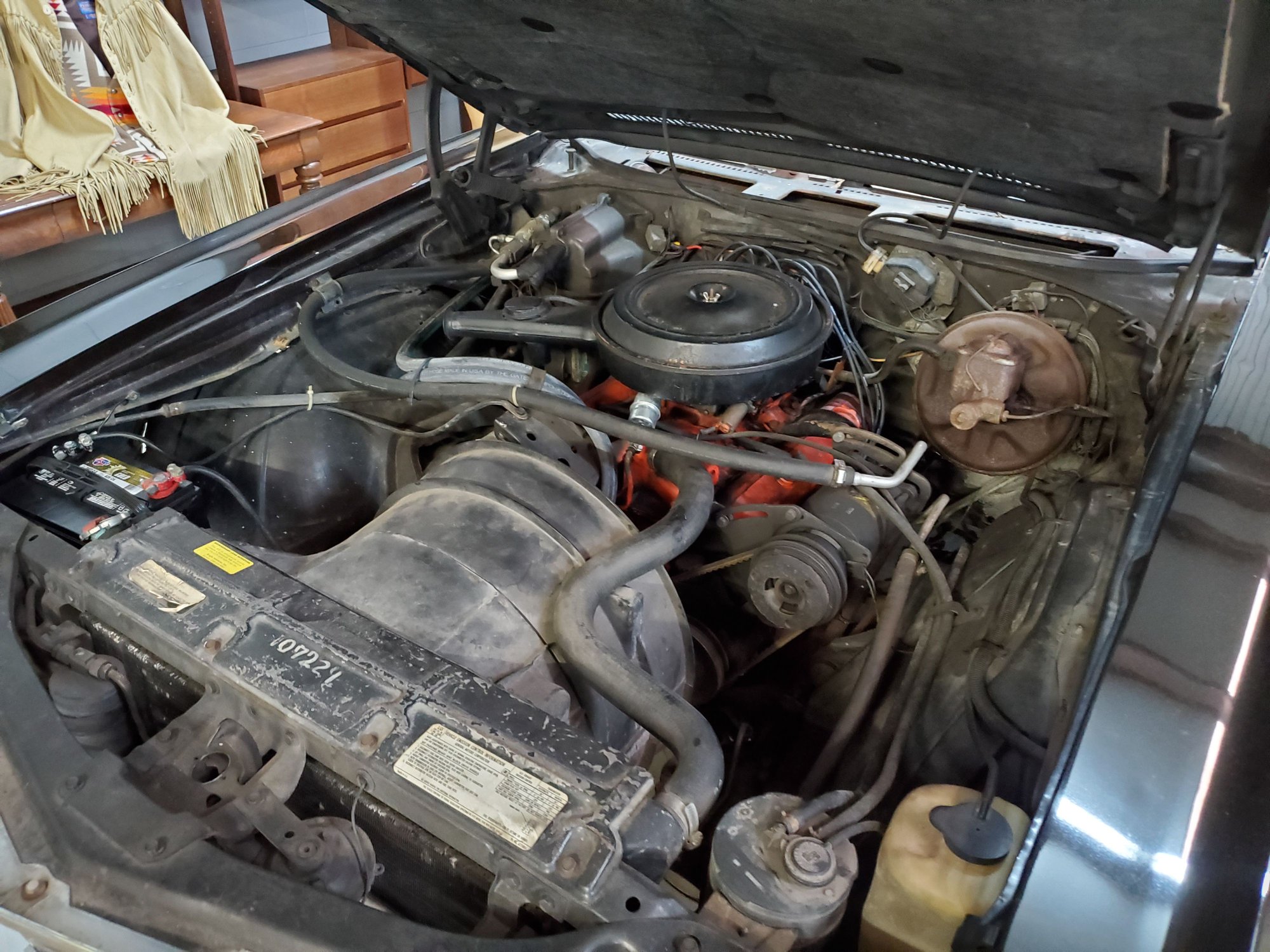

Thank you for giving your input. I have attached engine bay photo. Not sure what he was talking about with AC. He made it sound like it would "clog up" again when it gets gunk or dirt from use. ??

Okay I added some arrows to the photo A with the arrow is you AC Compressor when that goes bad you won;t have cold air. B in the back goes to the area of the AC has a little radiator back there and they can get plugged up. The green arrow shows the heater hoses and they appear to be old in the picture might be good to have them changed. Check the belts to make sure they aren't cracked.

Thank you so much! Wow. So, he must have been talking about Arrow B and it getting clogged and difficult to get to and clean. But, don't all 1st Gen Monte owners have the same issues? I'm going to see more about finding youtube video on this now that
