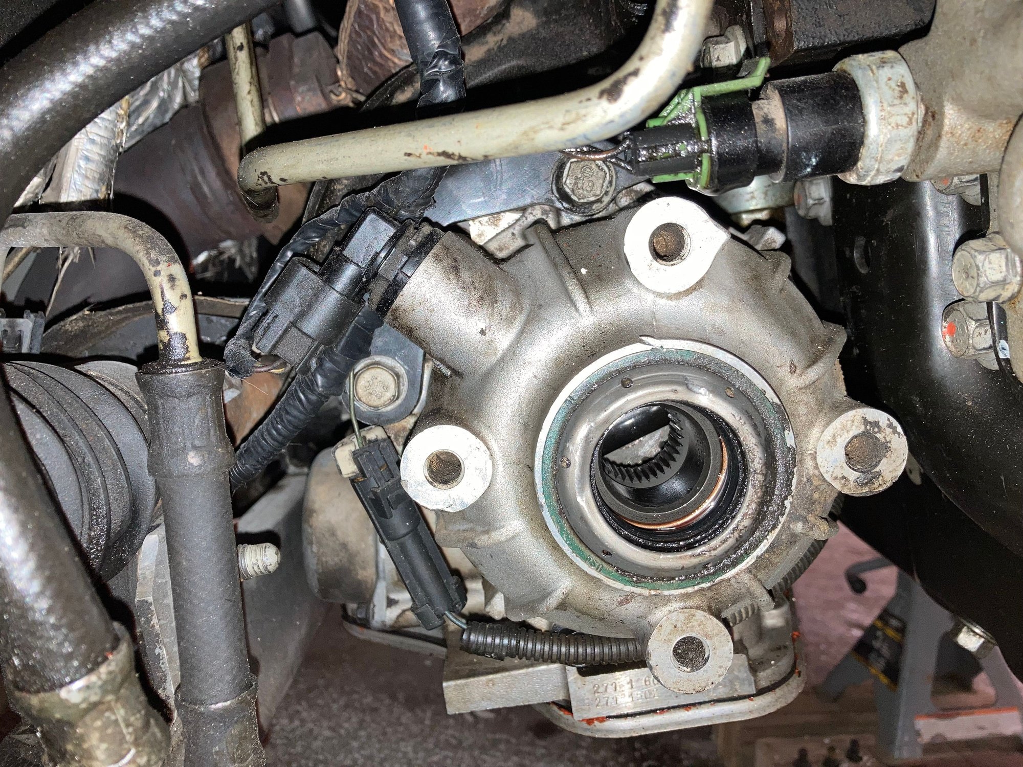

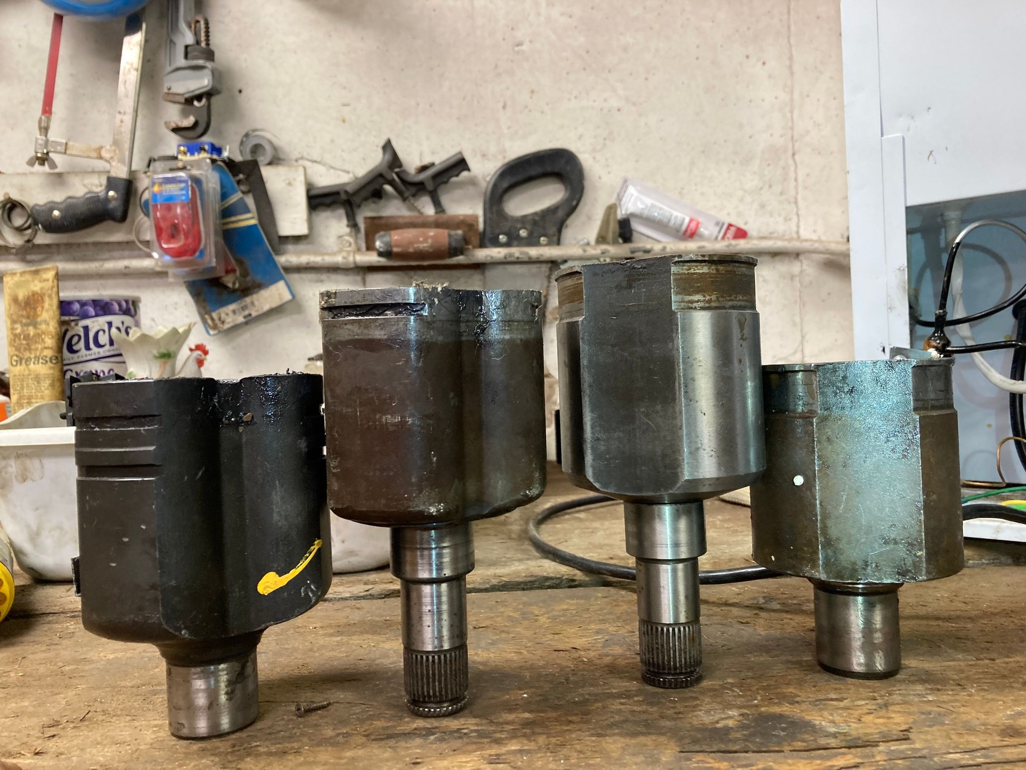

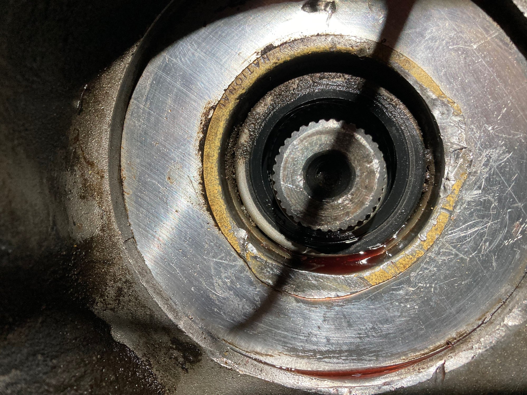

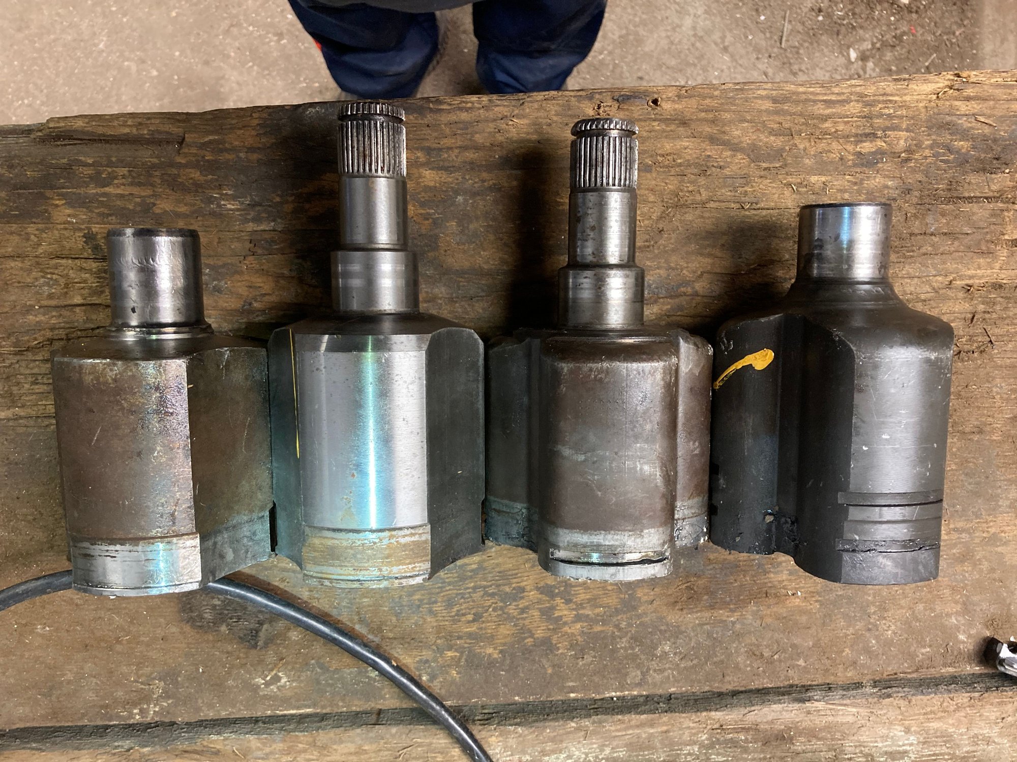

Pictures would help now. Both sides of the trans, any markings, and axles. Yours and the ends that came in the trans.
The drivers side should be a different type of axle than the passenger. The passenger side has the axle go into the trans, the drivers side has the trans go into the axle.
Old Dec 13, 2023 | 10:08 AM
Posts: 6,479
I agree, pictures would help immensely. They should be impossible to mix up as one is an innie and the other is an outie. It's hard to imagine what's wrong here from the text provided.

I don’t know how to send you some pictures but the axle ends that came with the transmission are smaller than my axle how can I tell if it’s a hd transmission

I got my daughter to send you the pictures I hope these pictures will help
