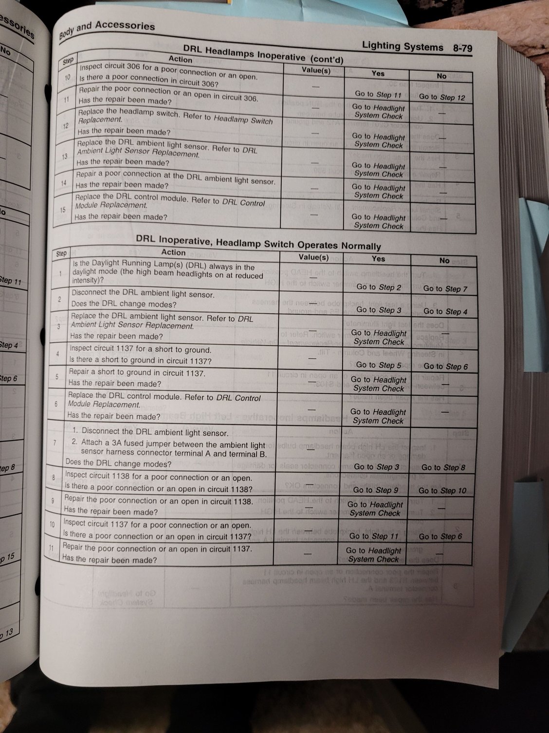

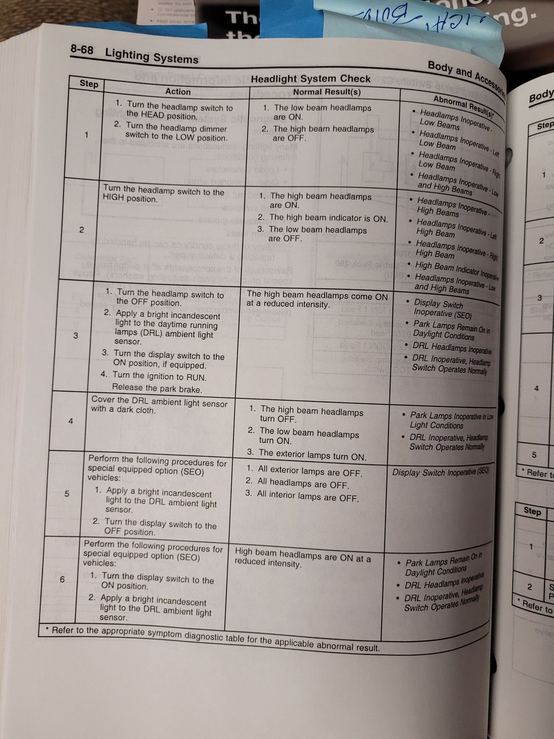

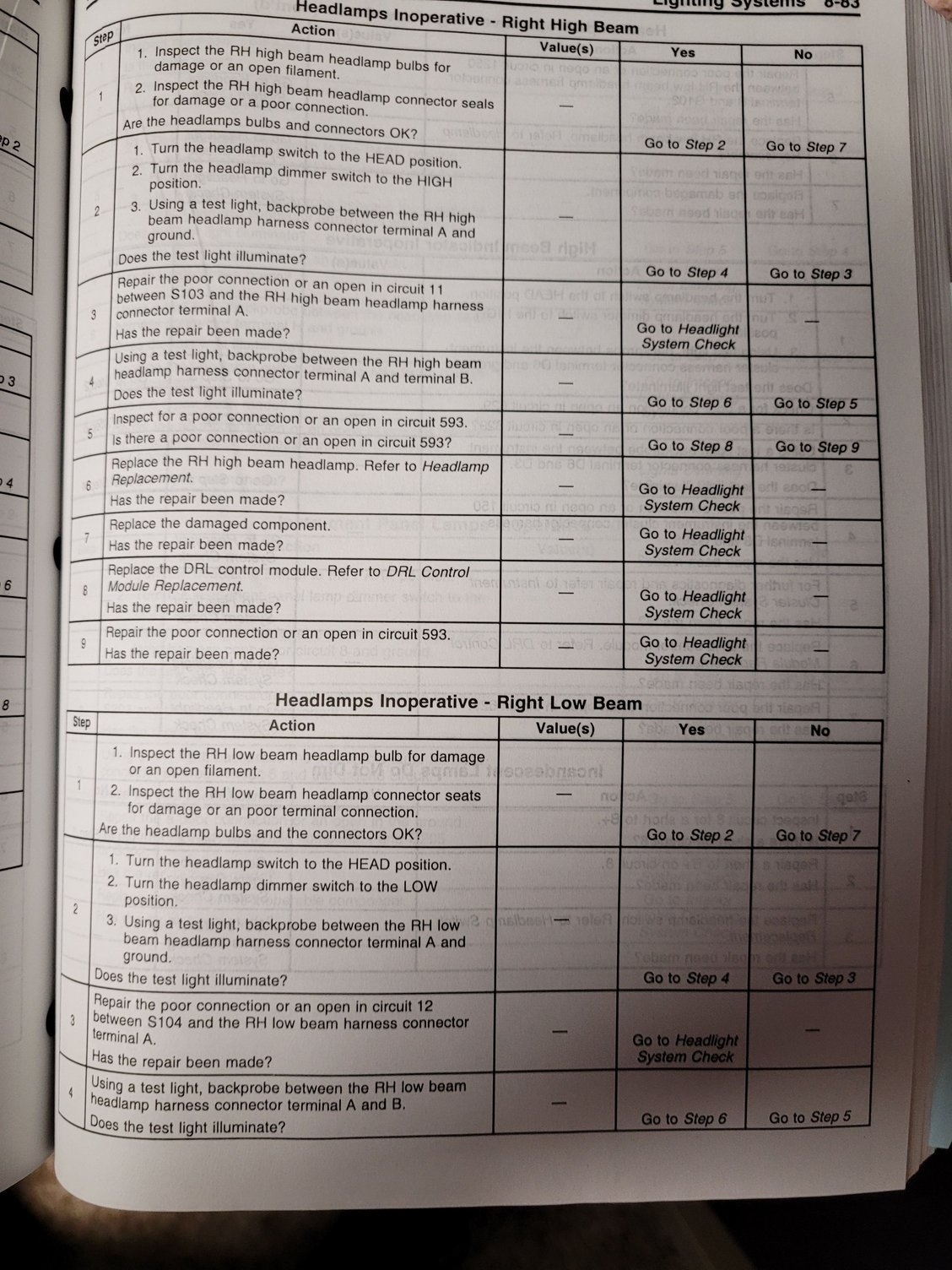

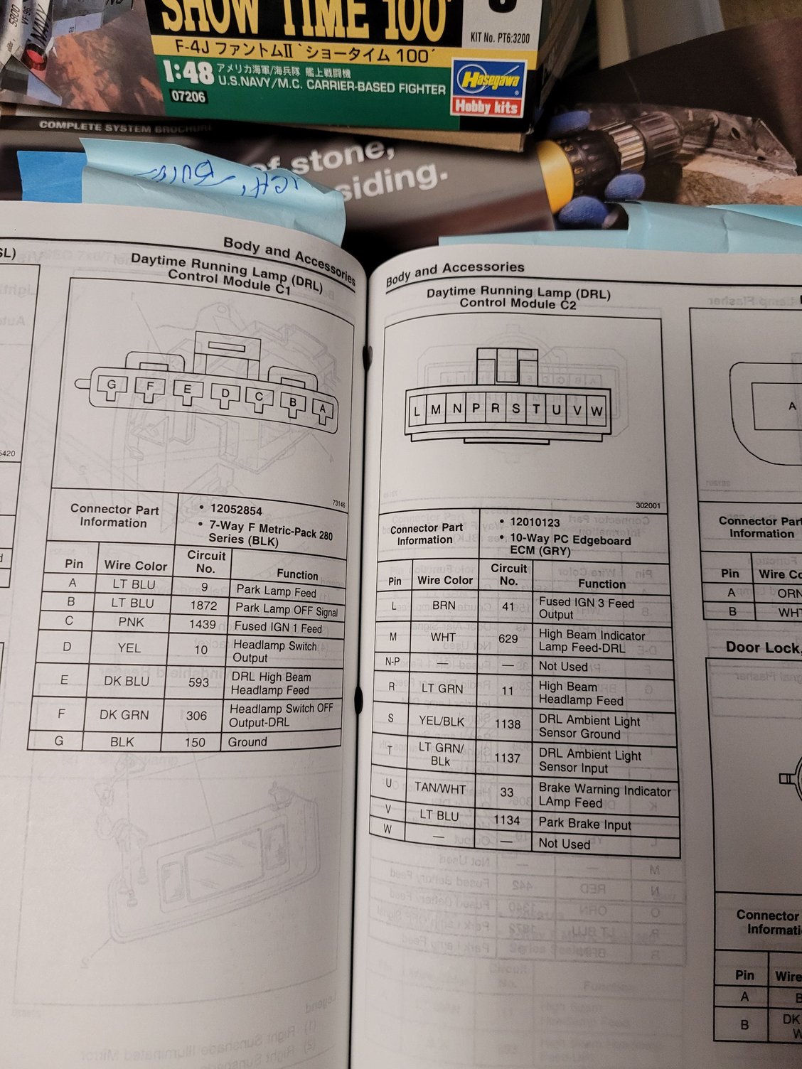

I am attaching photos from my service manual. 1999. But it. Has to be similar.
When you reinstalled the battery you may have messed up a relay someplace. Sometimes you can check Youtube for the issue repair help.
I would guess it could be a bad ground maybe they will mess with your system. there are few inline fuses in the car one is inside the console under the gear selector runs up to the Cig lighter. that one is a crazy one. I am going to add a few more pages from the Service manual. They will give you what you need to check for the repairs. I don't have the picture of the under hood. Sometimes the fuse may look good but is not so replace them to make sure.
Parts for this could be difficult to get but the salvage yards are a good source. Monte and Lumina are compatible. After you remove the fuse lid under the hood take a photo of it with the fuses inside so you can reference that if you visit a Salvage yard.
