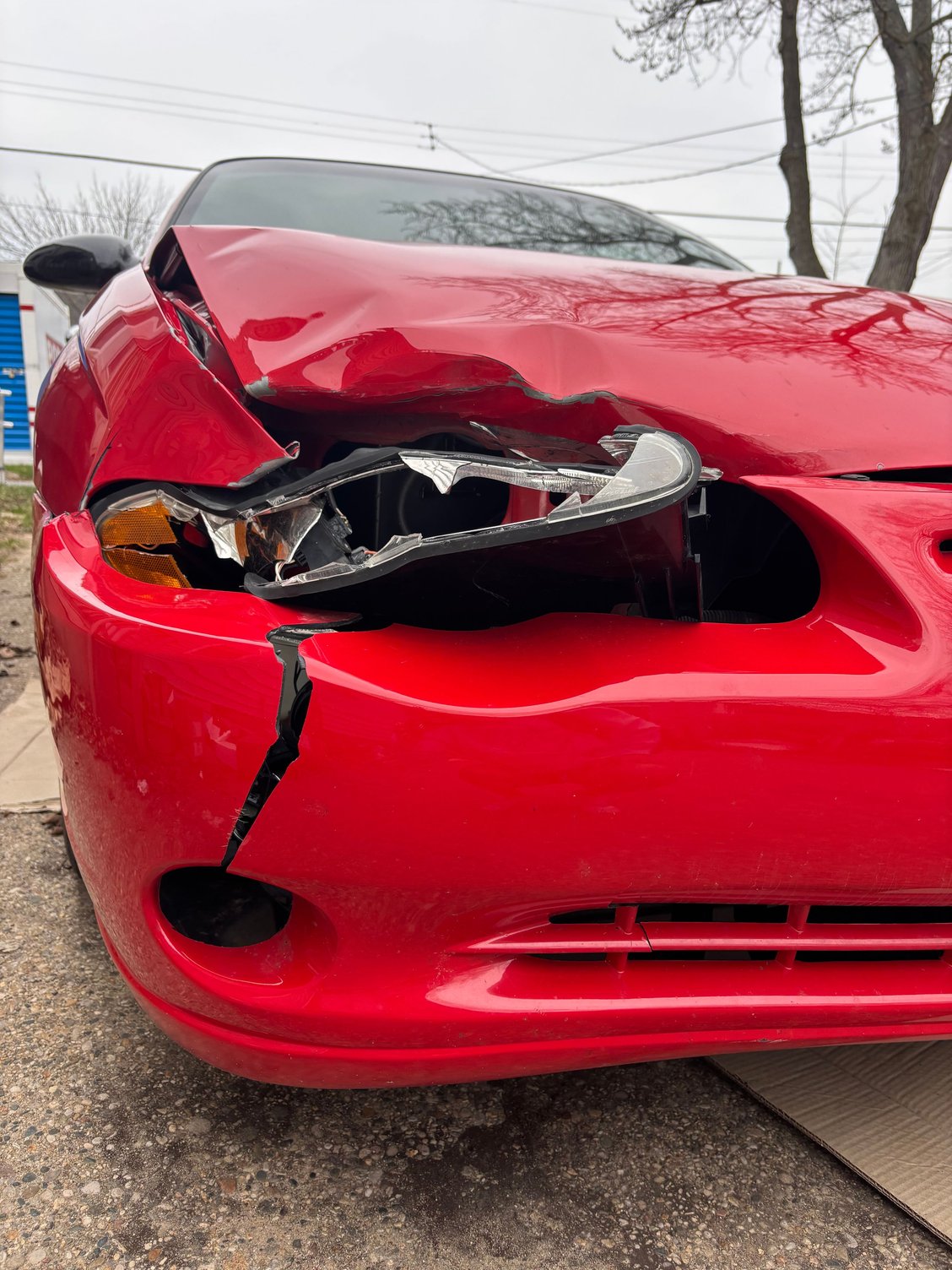

I recently bought a wonderful 2002 Monte Carlo SS from a retired couple. I live up in Michigan, and it was their designated summer car. My plan was to keep the car until it died, it only has 74k miles on it. With the 3.8L V6, I was hoping to get around 175k-200k miles off of it. And hopefully it’d last me through my undergrad and graduate years.

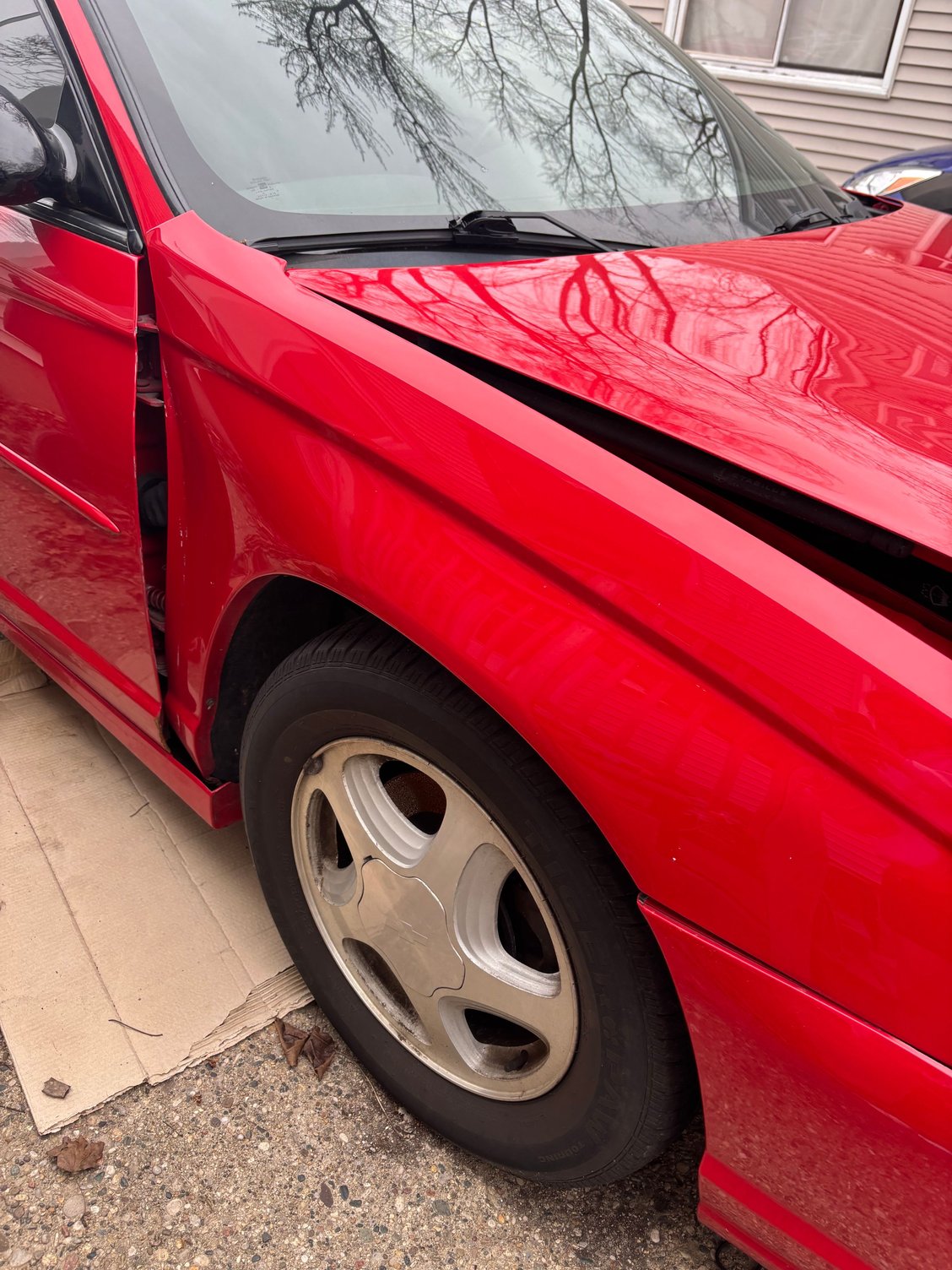

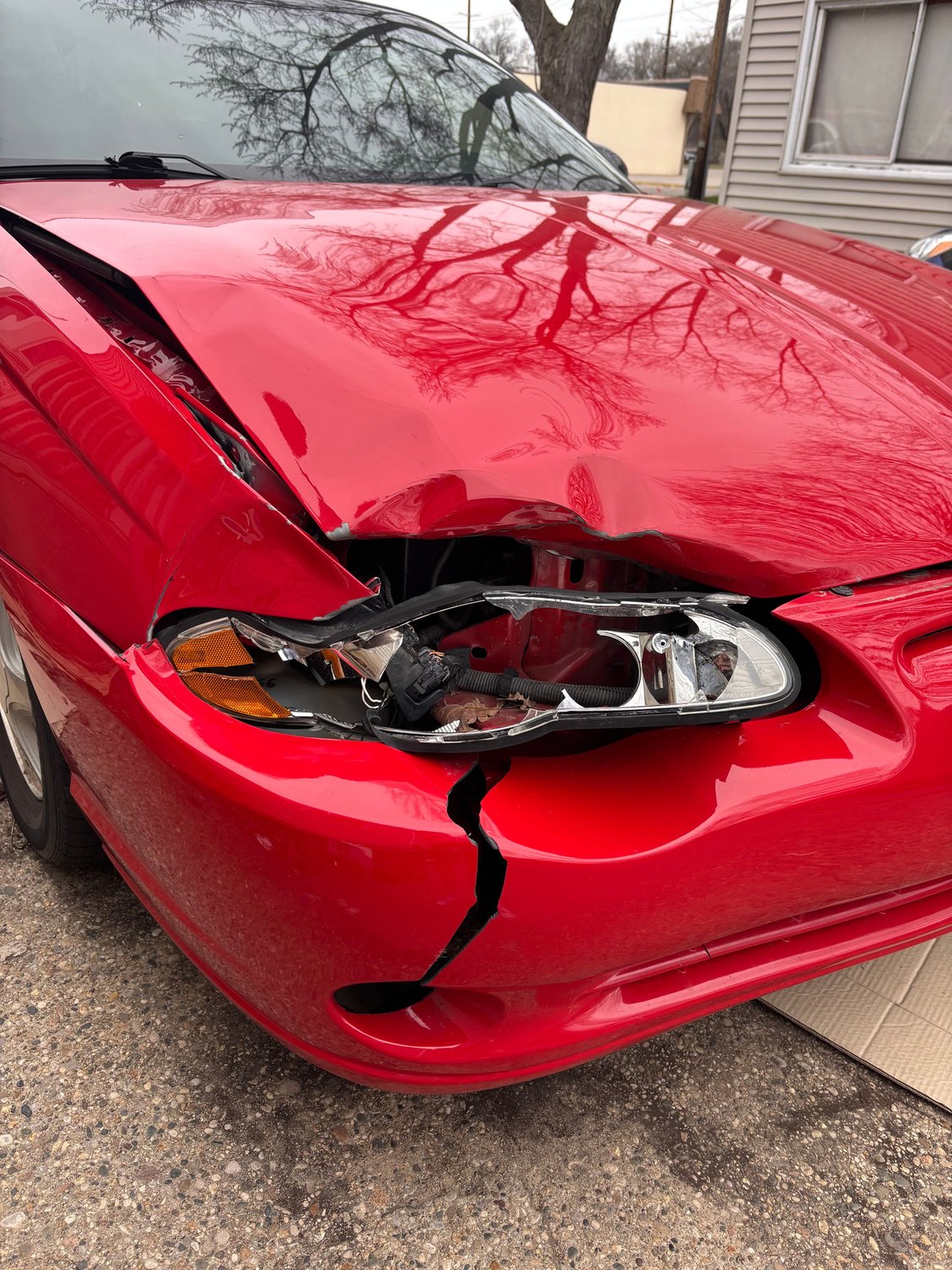

Unfortunately, I managed to hit a deer at a decently high speed. Probably around 45-50mph. The hood, front bumper, passenger headlight and fog light, and side fender all got hit pretty good. We’ve been to local collision and auto body shops and they all want to total it out.
I’m hoping to restore the car back. I have no experience with cars, I don’t even know how to change the oil, so it’ll definitely be a project. But I know that the car has a lot of life left if I can manage to restore it.

That's definitely totalled from an insurance perspective. Any body shop should still fix it if you want it to as long as you're paying.
If youre trying to DIY repair it, IMO the best bet for these cases is to scour local / within a few hour drive junkyards. Try to find one with a blown engine / rear damage / etc where the whole front clip is intact. That way you can get all of the panels you need along with all of the fasteners and trim. If youre taking it to a paint shop at the end anyways, then color won't matter.
One warning though, it's almost certainly not going to be an un bolt / bolt on fix. Thats part of the reason body work is so expensive as they often need to bend and straighten the body mount sheet metal behind to properly hold a non crumpled panel now. But at least with new OEM panels, you can bolt the undamaged parts in place to find what needs bent / by how much.
For someone that's never done mechanical work before, this is pretty deep stuff- but if you're motivated, everyone has to start somewhere.
