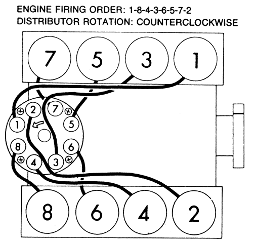

Is your firing order correct?
The wiring in this picture is wrong. The distributor goes clockwise as do the plug wire's.

Here's correct
