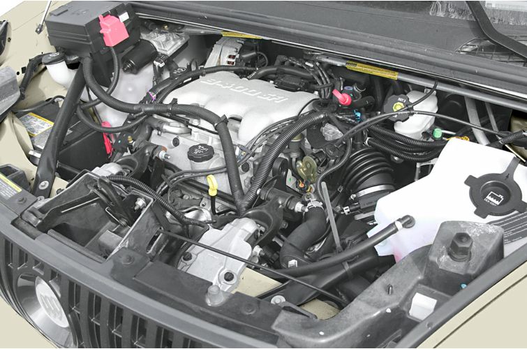

Not extreemly excited about this work space...

Really fairly simple, I suggest keeping the injectors and fuel rail in the lim to save some time and headaches later. Also keep the pushrods/rockers in order or you could have some serious valve damage. If your resusing the lim bolts clean them up with a wire brush and put some loctite blue on them. Also just replace the tstat while your in there. btw really clean engine bay.

Tstat is less than a year old,
i think the pic is a stock photo for a dealership, just stole it off google!

Even though its only a year old I personally would just do it because its a bitch to do later. And it's only like $10. Haha I wish my engine bay was factory clean.
