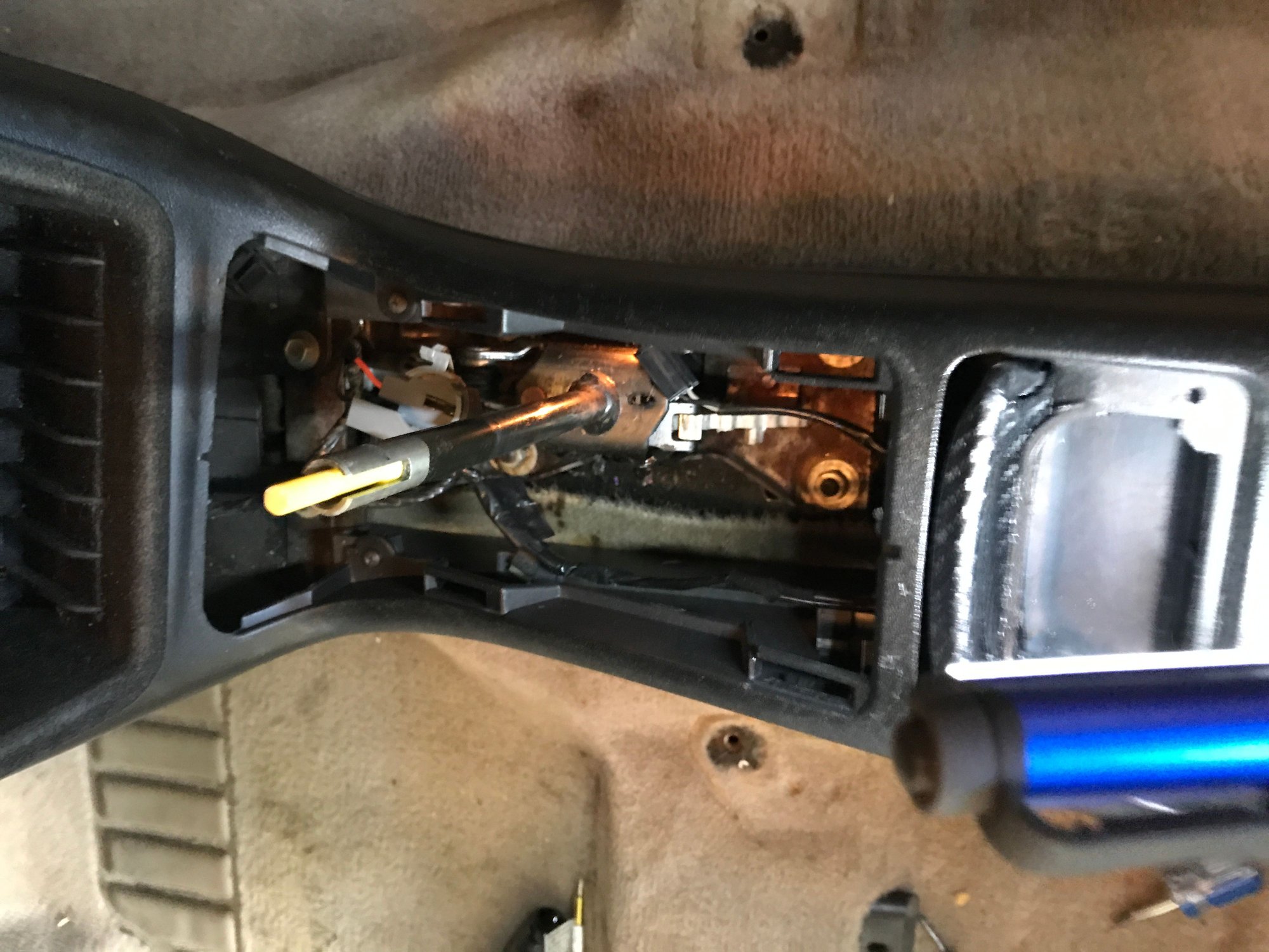

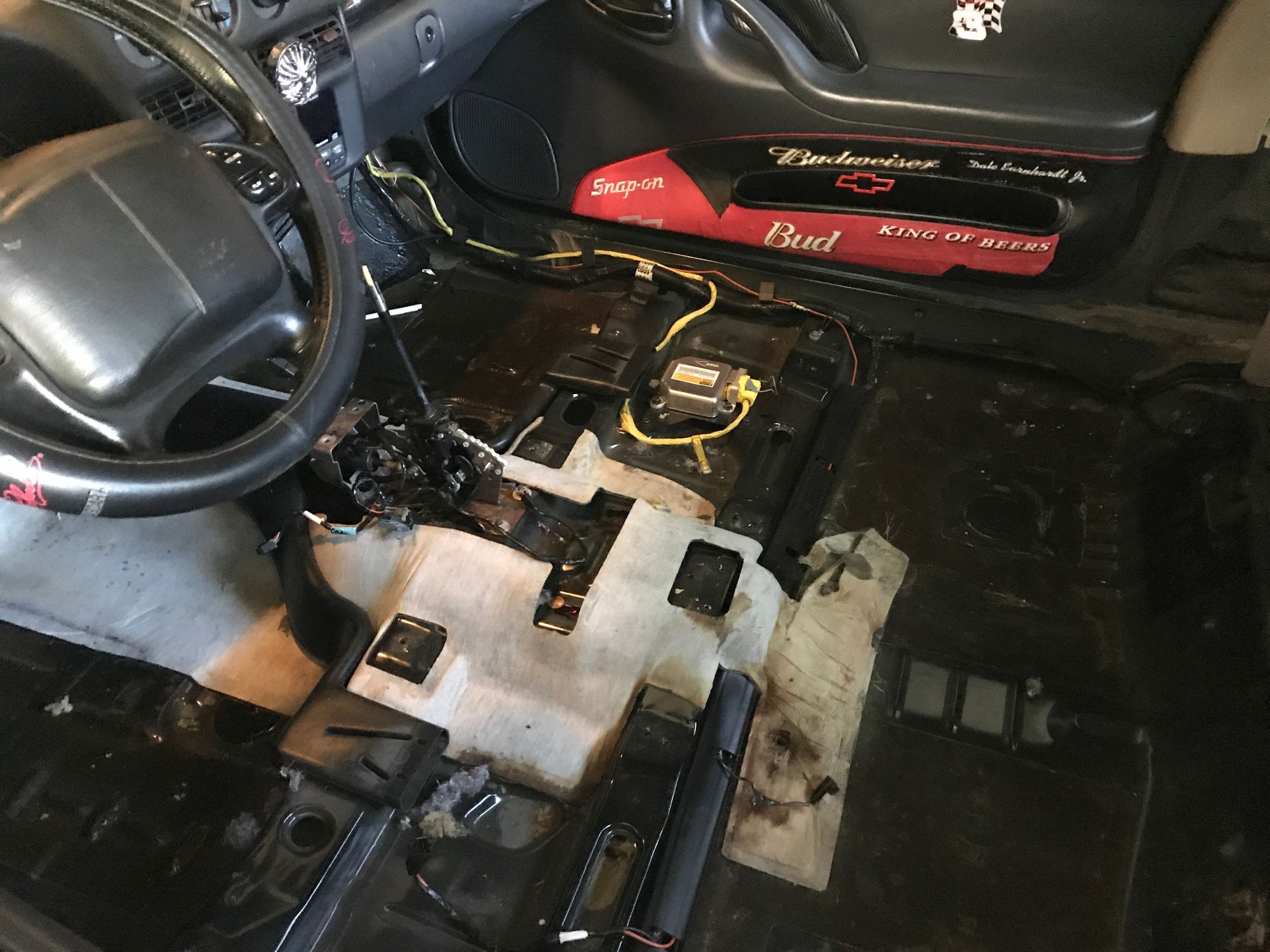

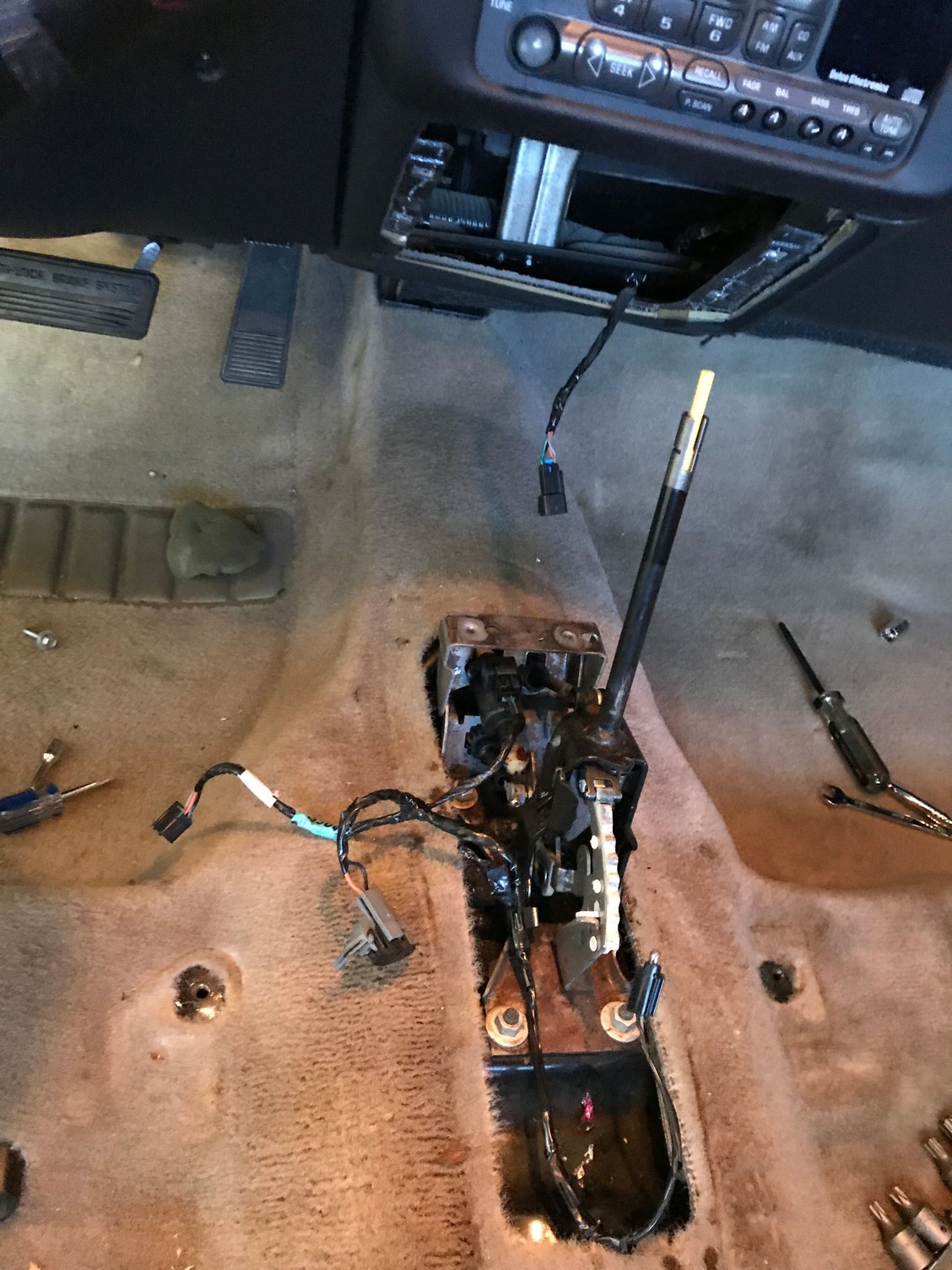

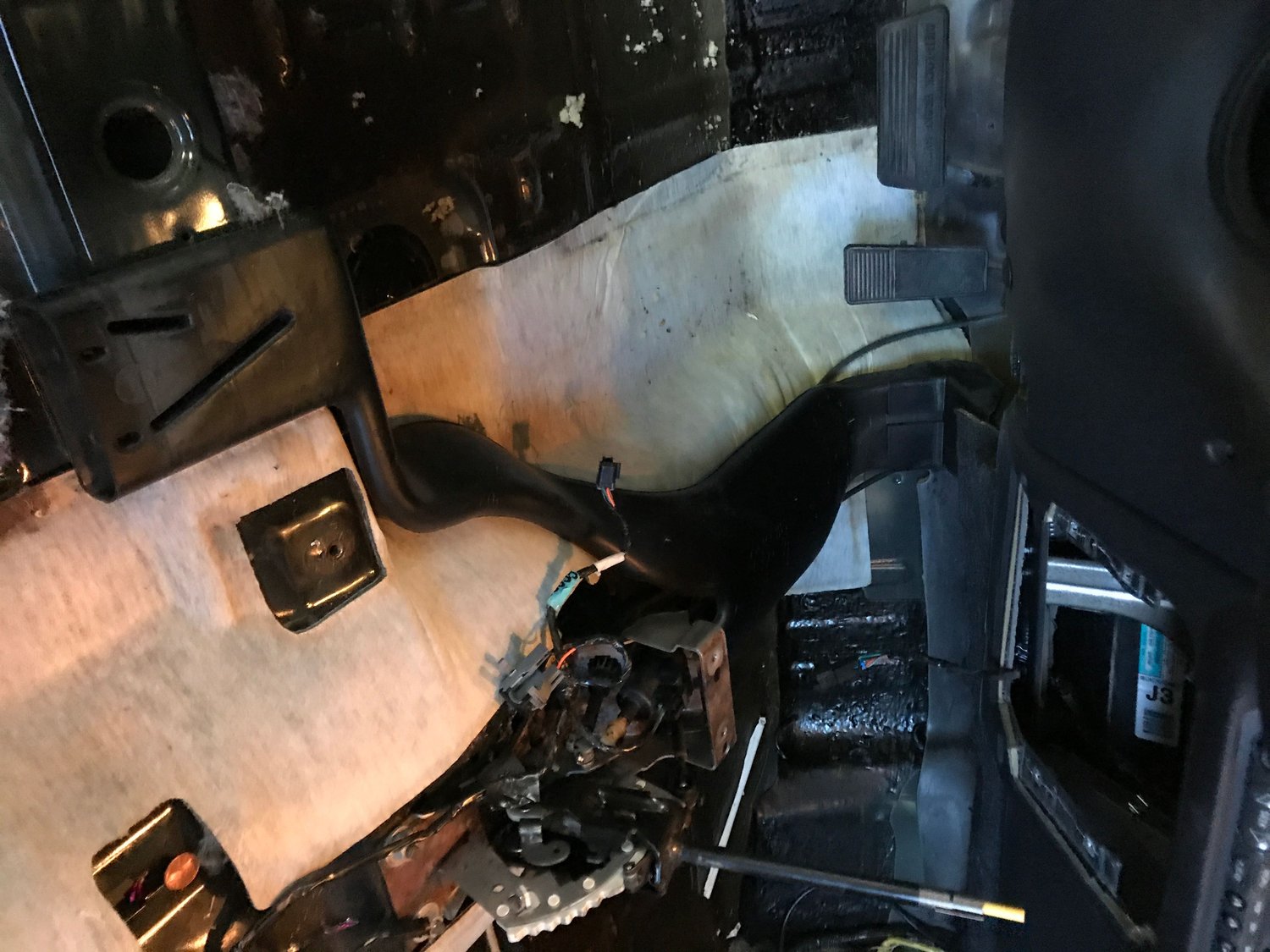

Should be for both this is the 99 version but they should be the same I would think. Have you opened up the console area? here are some shots of when I put my new interior in and it seems like there was an issue that was with a fuse that caused an issue with starting. But that has been several years ago now.
Another thing is unless you are the original owner, the previous owner may have disabled something to make it work different for them.
Seems like I recall that there was a fuse inline here someplace that caused a similar issue?

Thanks, I did t see a fuse and it seems like you have 1 more plug then I do but I'll pull the s
center console completely out this time.
