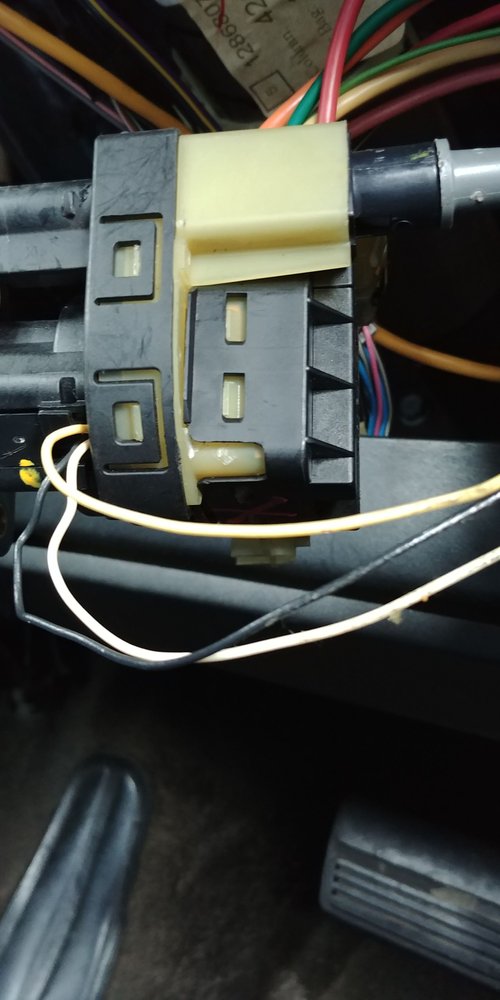

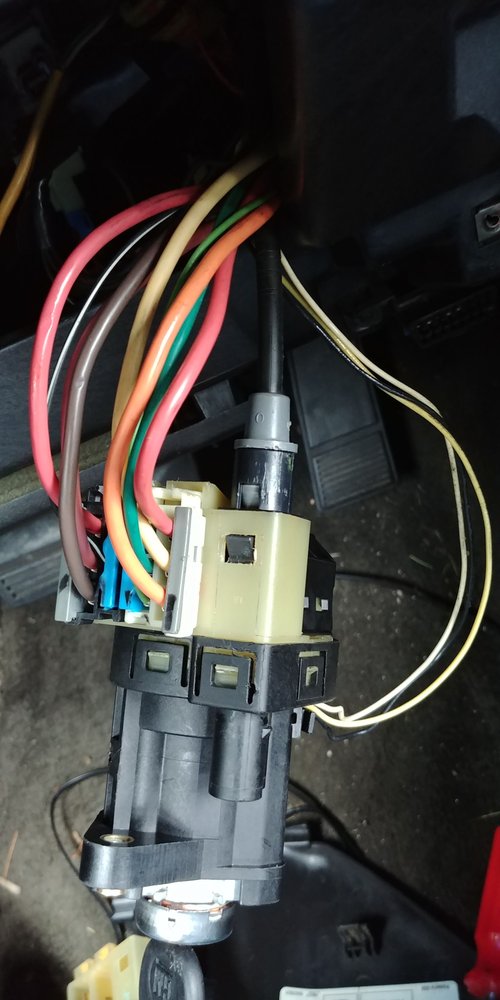

I have a 2000 Monte Carlo 3.4 and for some reason I can't get the security light to stop flashing. Happened out of nowhere after driving and parking the car and now it won't start. I've tried both 10 min and 30 min reset/relearn procedures with no luck. Tried another key also no luck. Went and got a another ignition module and still nothing. Everytime I attempt to start the car all dash lights and radio lights black out but the dome light stays on which is odd. Has anyone else has a similar issue? Any help would be greatly appreciated.

I changed my ignition cylinder and ignition switch (housing the cylinder sits in). When you replace it and need to do a relearn the security light should flash on and off. Even after you do a relearn the security light will appear on a normally functioning car when the key is turned to acc.
If the car has the security light on or it appears when it's started and/or running then something is wrong.
