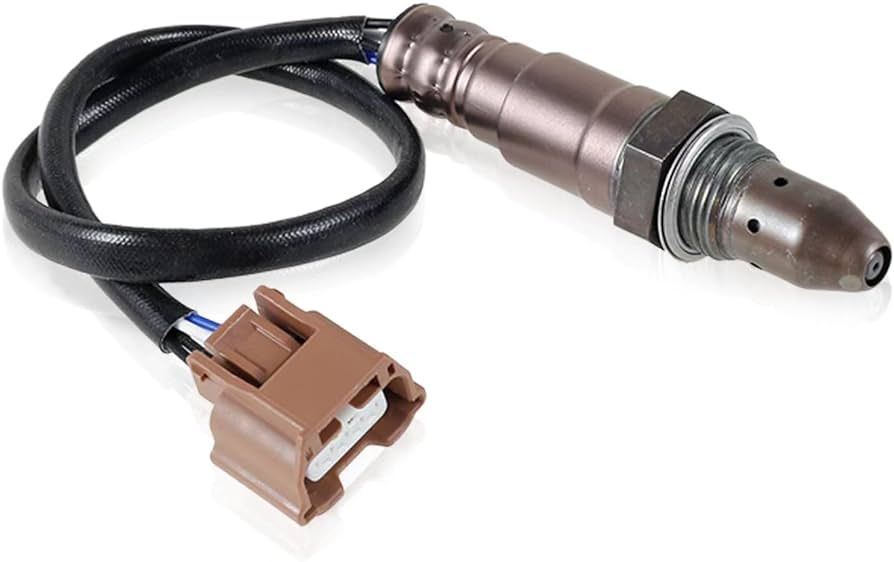

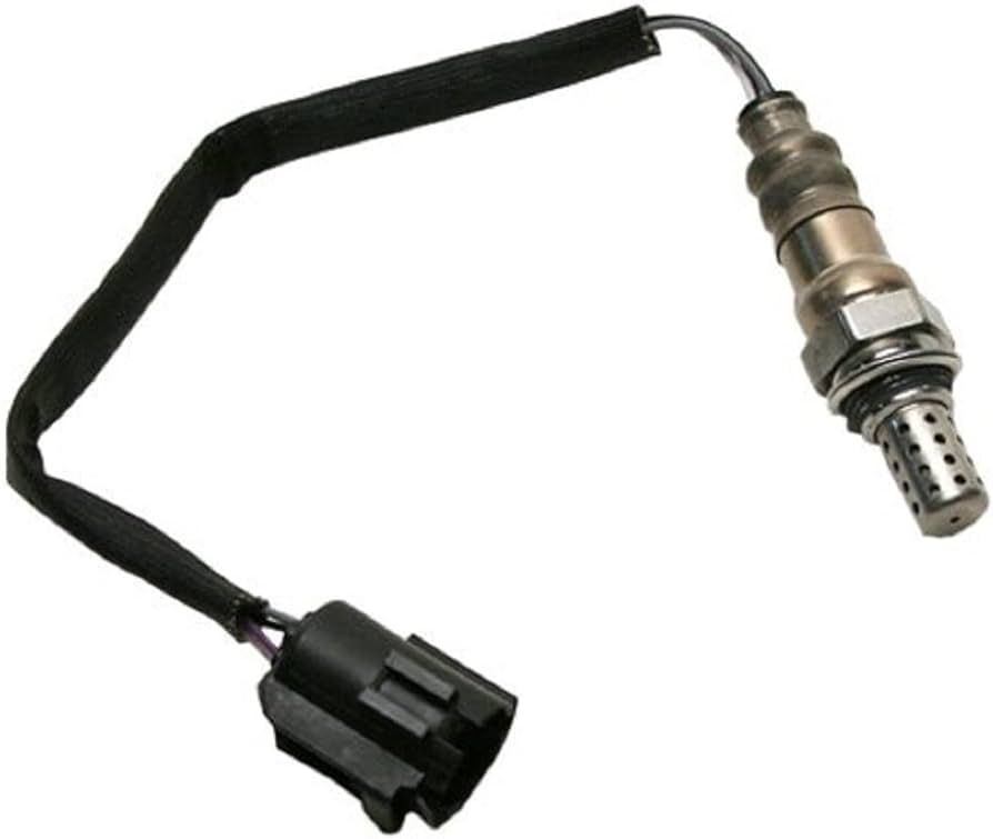

The original looks like this as you know.
The new ones look similar to this, only with a much more recessed tip and no holes at the base of the element gaurd. Ignore the connector, obviously thats not the same as in the picture.
Would the downstream o2 plug into the upstream connector?
Old Mar 2, 2024 | 09:28 PM
I recall years ago with my ex's 2005 Impala (with a 3400) the part number for the downstream O2 was wrong. I forget how, but we figured out the right one (I may have had them look up a 3800 instead). But if the end of the O2 going into the exhaust stream looks like that 2nd pic, I would return it as it does not look right.
