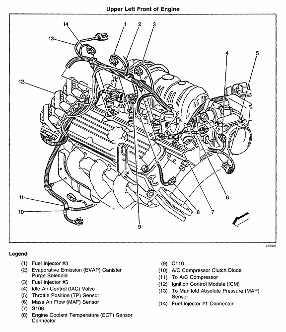

This is a long shot but a friend of mine had an 03 Monte Carlo and it had a draw on it that sometimes would give him fits during a drive. So hat he finally found out was there was a wire in the rear back of the engine that was landing on the exhaust pipe and causing this to happen.
This could be a similar issue if it was rebuilt and something didn't get attached correctly. Check the diagram for the rear of the 3800 motor and see then if anything might be different under and back there.
Most likely there is a broken wire that shorts to a metal component some place this could have happened when the engine was installed or something was remounted on the wrecked car.
This is the rear of the engine and the Red arrow is pointing to the power steering pump for reference, the 02 sensor is right behind the exhaust port flange
This diagram gives the location for the items in the location of the engine.
